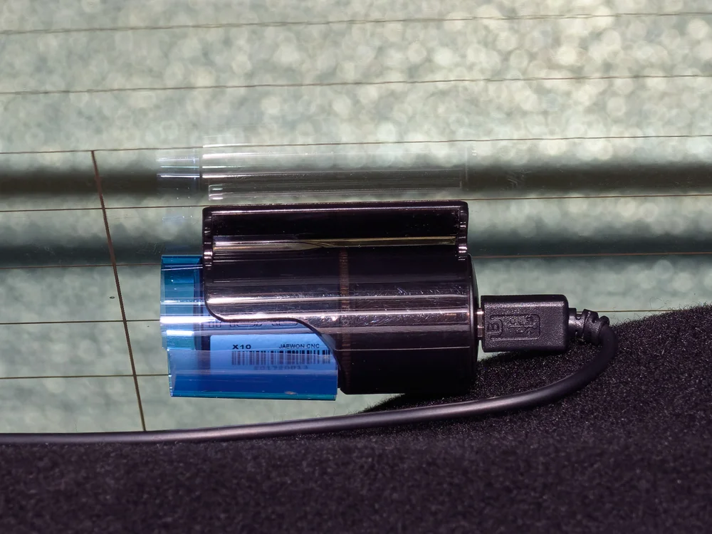

As mentioned, the rear camera was too warm (reddish) shooting through tinted window. It is a pain to get to it once it's mounted and glued down as it doesn't have a removable base like the front camera has. I cut a Lee filter #202 Full CTB (~$7 sheet at theatrical lighting shop or online) out of a sheet and taped it into a cylinder to slide over the lens/camera unit. That took care of the reddish tint and made it look a lot better. Exposure is pretty good too. If it is too cool (blue), then a Lee #201 Half CTB (Less blue) would be the next choice.

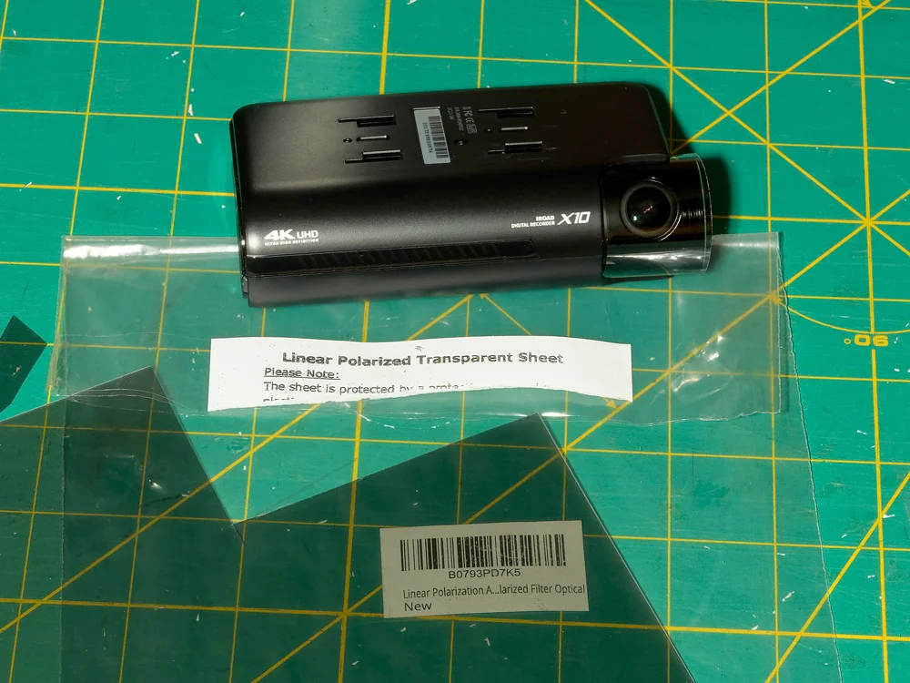

Option two was going with a polarizer of some sort, but nothing made for the x10 front camera. I found a polarizer sheet on Amazon ( https://www.amazon.com/gp/B0793PD7K5 ) and fabricated it so it could slip under the camera's edges where the lens barrel rotates up and down to hold it. The sheet has a front and back backing that peels off and what's left of the polarizer slips between the outer camera case and rotating barrel of the lens snugly.
I put the plastic bag the polarizer came in along with its white labels on the dash and parked the car at noon. By looking through the polarizer sheet and rotating it while starng at the bag and dash, I found a spot where it got rid of most of the glare off the dash and bag from the windshield. I marked the outside covering of the poalrizer to the direction it needed to be cut. Sliced out a 1"x3" piece and slide that over the camera lens. It's fixed so you can't turn it so it's pretty much pot luck on average positioning - but anything is an improvement over the amount of glare I was getting. You can see the polarizer I cut out affixed to the top of the x10 lens here:
