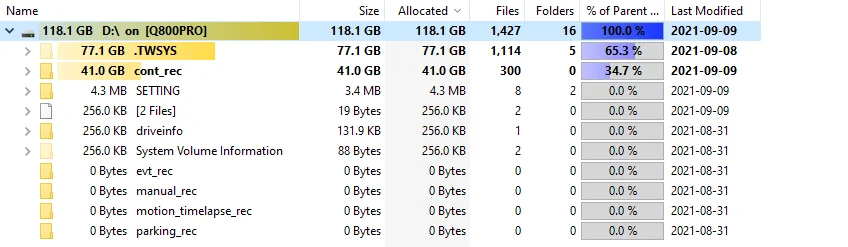

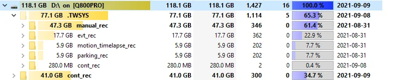

is this an example of the .twsys working properly? I feel like it is impossible that it is 1631217019015.png 1631217072905.png
that is 41GB out of 128GB, for a total of 4hr55m49s from 300 files
running front and back cams
I formatted the sd card from the windows app, and set the priority to continuous mode, I might report back after my shift ends
