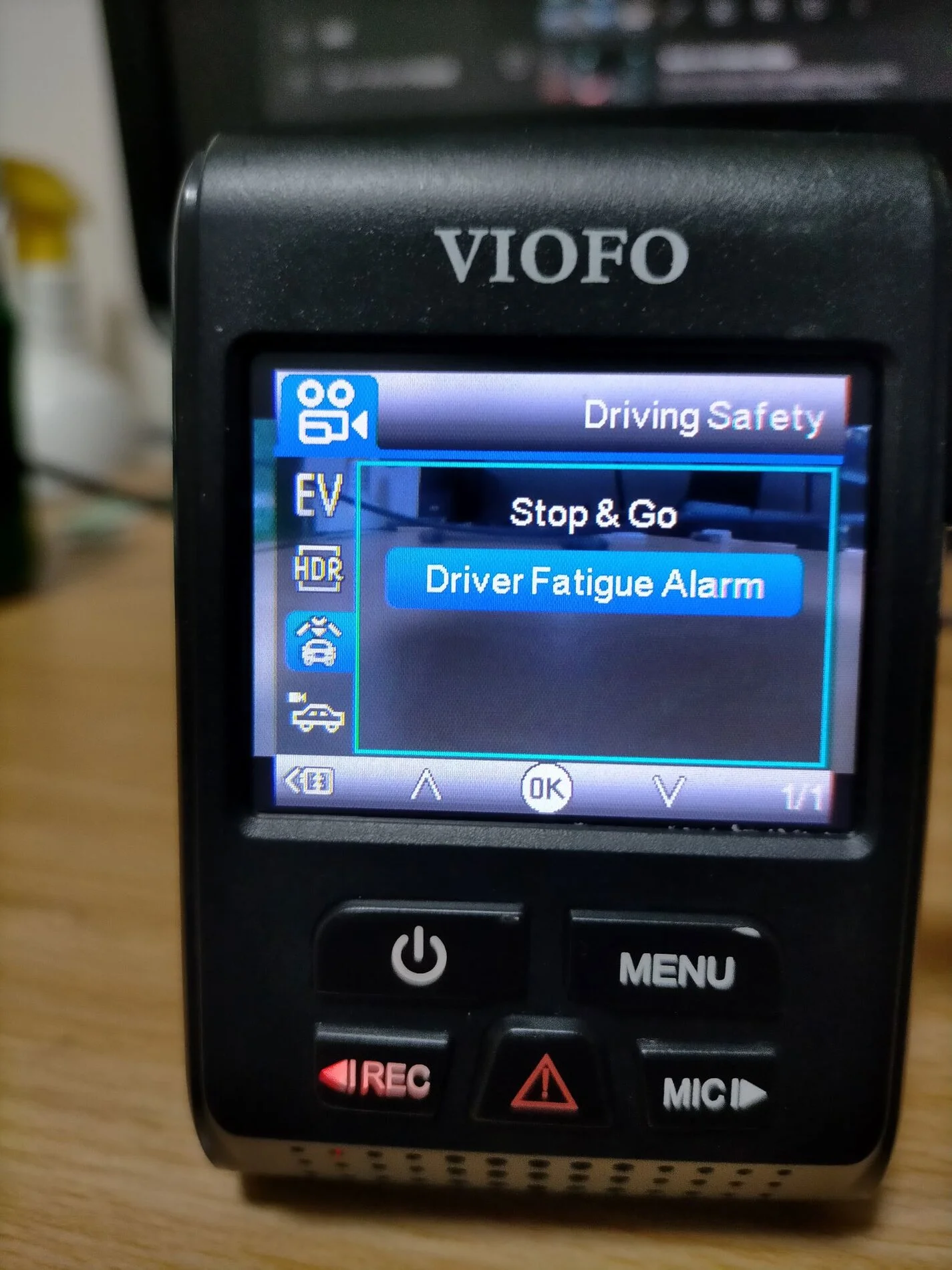

Maybe you have Driving Safety > Driver Fatigue Alarm in settings turned on? Driver Fatigue Alarm_2.webp
Maybe you have Driving Safety > Driver Fatigue Alarm in settings turned on?View attachment 67111
Thank you, that has to be what it was. I have the fatigue alarm set to 2 hours. It wasn't the first time I have driven for 2 hours in the last couple of weeks though and it was the first time it played. I didn't see anything on the screen, but I probably missed that, and I wasn't expecting a 4 note chime. If it hadn't gone off literally at the same time as the GPS, it wouldn't have been so weird.
