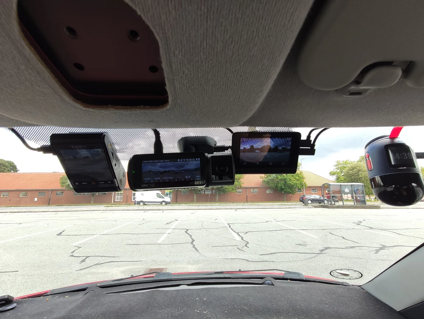

Just installed a N5 in my car
kamkar
Oct 11, 2013
34,374
18,944
Denmark
10 years, many dashcams
Took a while ( hardwire ) and i found out several times that the underground garage i use, well the light turn off if there are no movement in the garage in 10 minutes or so.
Fortunately i EDC a little flashlight, so not really a big problem, but it did probably eat into the install time, but i remained dry CUZ outside the skies over my town was very grey indeed, so dident want to take a chance on that.
Also in all fairness, i did also remove some old wires in the car that was for systems no longer there, that also took a while, not least with the short wire for the A 139 interior camera, i have no idea how i got it where it was but it was hard to get out.
First hand impressions are good, the front unit in the system feel like a steel pipe with something inside it, the rear part are extremely light in comparison.
In my car i have the ball joint maxed out to be able to have a few CM of the front of the dashboard in the frame.
It sound as if the interior cameras are proper active IR cut filter ones, this is good it is the way it should be.
If i have to say something "bad" here on day #1, well that would be the lack of a CPL filter, but fortunately i have my old DIY dashmat, and though it is no longer as black as it once was, then it is a lot better than the gunmetal grey plastics my dashboard are made off.
Okay looked over memory card, and the camera have not recorded much, very sporadic recordings, i think it is safe to say the Silicon Power memory card do not work.
And thats just fine too i was surprised it would format, but what is a surprise the system do not give any alarm when it apparently can not record.
