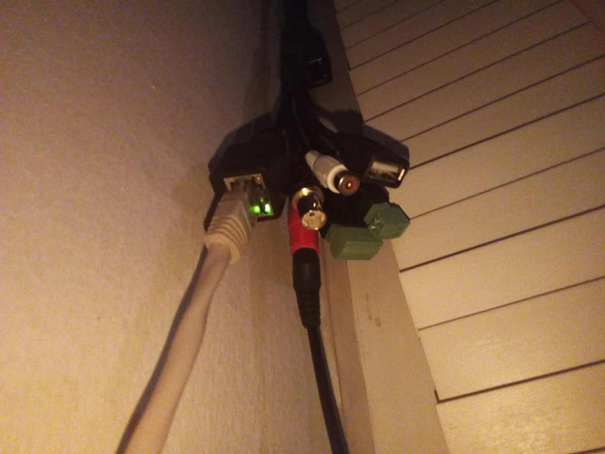

The IMX 185 camera module i have in my living room window also have a BNC plug, not aware if its also a HD signal on it ( many cameras seem to de dual mode supporting 1 or 2 different ways of getting footage of them )
As it also evident by the hybrid recorders that support more than 1 way of connecting cameras.
There was very little info where i got the camera module from, so unsure what plug is what and where to get a firmware update.
All the CCTV bokses i have owned ( the analog mobile one and a home analog one + my current NVR are all 12 V ) so aside for environmental concerns ( temperatures & moisture ) they should be easy to install in a car.
And you can get little HDMI flat screens too, and most boxses also have a VGA or what ever the old screen plugs are called.
