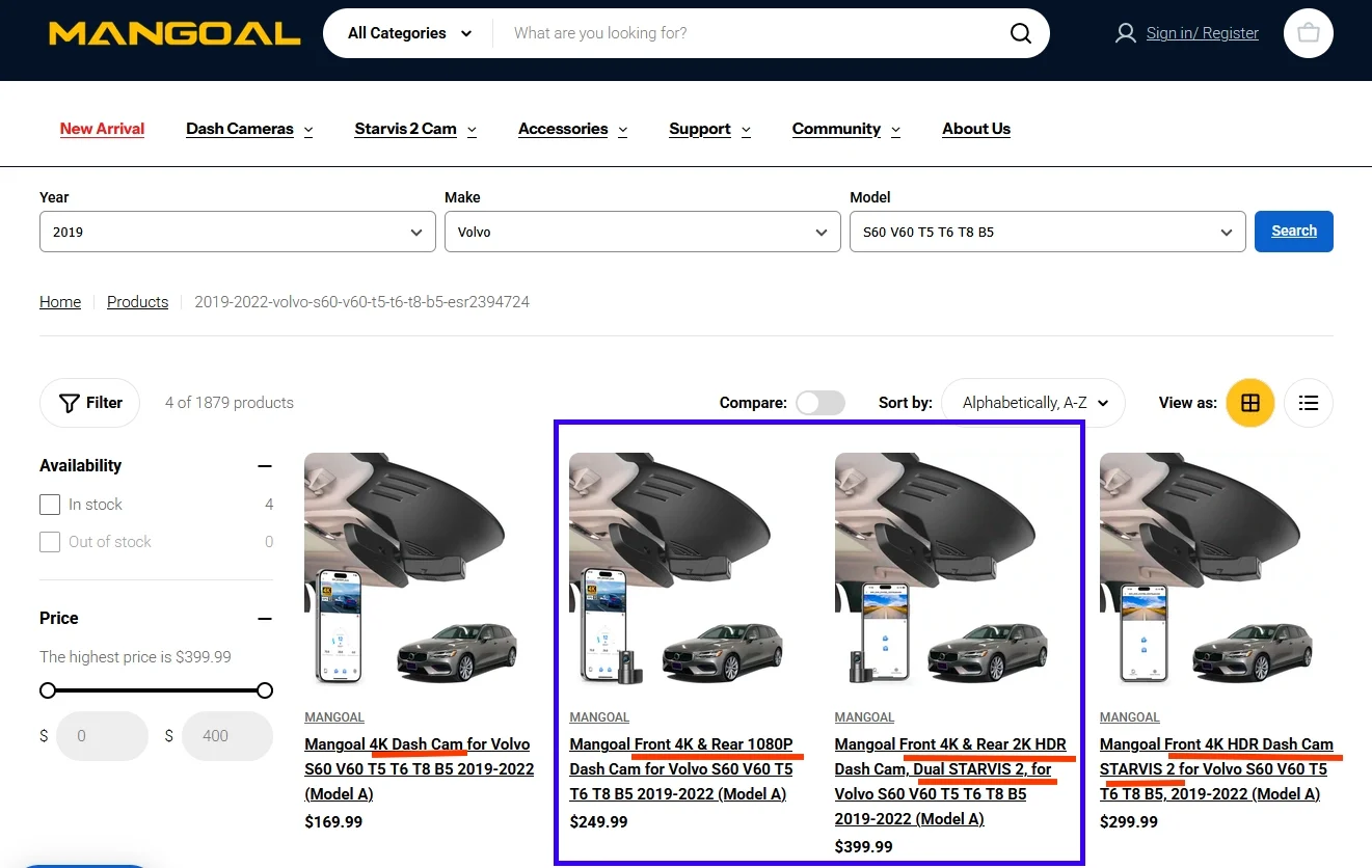

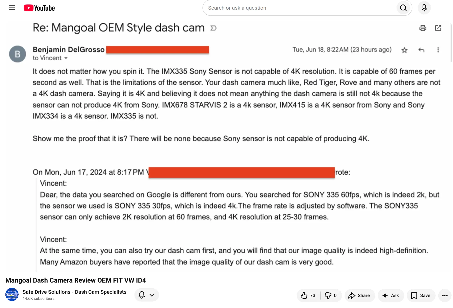

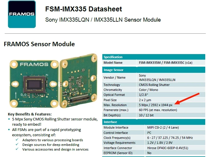

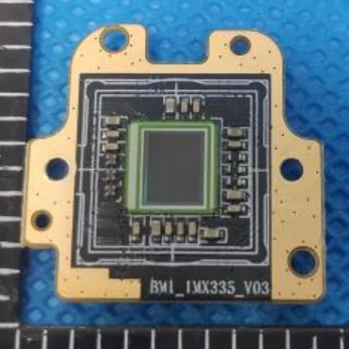

** IMPORTANT NOTE ABOUT SPECIFICATIONS AND PRODUCT LABELING **
The user's manual indicates two details that caught my eye:
- Sony IMX335 Video Sensor for the front camera (which has a maximum resolution of 2592x1944)
- 4K Ultra-HD 3840x2160 @30 fps
Both of these specifications cannot simultaneously be correct, there is a mismatch in resolutions. Perhaps I have a newer camera that was packaged with an older manual, I'm not sure right now. This prompted me to do some digging that I usually don't perform.
The MANGOAL webpage indicates four available dashcam models for my 2019 Volvo S60 (https://mangoal.com/collections/all/2019-2022-volvo-s60-v60-t5-t6-t8-b5-esr2394724). Each is labelled as a "Front 4K" camera, two of which are also labelled "HRD with Starvis 2." Two are listed as having a rear camera, one of the rear camera models is listed as "1080P" and the other is listed as "Rear 2K HDR and Dual Starvis." Below is a screen capture with red highlights added:
I searched for available products for my car and found what appear to be the same 4 variants: 1CH or 2CH, with either an IMX335 STARVIS 1 or IMX678 STARVIS 2 front camera.
It is unfortunate that Mangoal did not send you a STARVIS 2 model to test. Having read your review so far, perhaps they will consider sending you the other model so you can make a comparison.
Is the STARVIS 2 model new? I don't remember seeing that, but maybe I missed it. If it is new, dollars-to-doughnuts it has other improvements and "fixes", as smaller companies may leave old stock on the warehouse shelf even when they know they shouldn't ship it.
@Mangoal Dash Cam have offered to send you a STARVIS 2 model when it becomes available. This was posted in another thread:
Hi Eric, thanks for your careful observation on the model naming difference!
To clarify our model codes for everyone here:
MG is our standard dash cam model, equipped with 4K front camera + 1080P rear camera.
MGA stands for our upgraded STARVIS 2 version, featuring 4K front + 2K rear camera for improved night & detail performance.
Unfortunately, we haven’t released the MGA STARVIS 2 variant compatible with your vehicle yet, so we sent you the standard MG model for now.
Once the upgraded MGA version is available for your car model in the future, we’d be happy to send you one for a full experience!🚕
