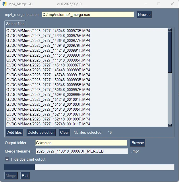

Hi,
I finally created a GUI in Python to control mp4_merge.
It was a good opportunity to practice using FreeSimpleGui.py 😉
For example, in this screenshot, the merging create à 20 Go viofo video file.
If you want to try it,, two options:
1/ An executable file
I created an one-file executable file called "GUImp4merge.exe"... But you will need to disable your antivirus because it may be detected as a virus, but it is a false positive.
the link is here and It's compressed in .rar format. You need to "unrar" it with 7zip, for example, which is free.
guimp4merge_v1.rar
rar file SHA1:
Size: 9813718 octets (9583 KiB)
SHA1: 3f6713245af1fb8fdc172397d7f0840cc8bb3791
Edit 2025/08/25:
Too many problem with the PyInstaller with the false positive virus detection!
So i've recreated a new package with the nuitka compiler that avoids this false positive issue!
You can download the package here and this time in ZIP format:
GUImp4merge_v1.0.zip
Once downloaded, unzip it, go to the subfolder GUImp4merge.dist.v1.0 and run GUImp4merge.exe
2/ to run the source python file (version 3 minimum)
If you prefer the Python source file, here it is:
GUIp4merge.py
To run it, you will need to have previously installed the FreeSimplegui.py library.
*** HOW TO MERGE WITH THIS APP ****
You will need to indicate where mp4_merge.exe is located on your system, which you will have previously downloaded in the post above.
Next, Once you have selected the files and chosen the destination directory, you can click on the ‘merge’ button.
Of course, you can modify the merge filename and/or the output folder.
A progress bar will show you the merging in progress.
A final pop-up will tell you if everything is OK or if there has been a problem.
