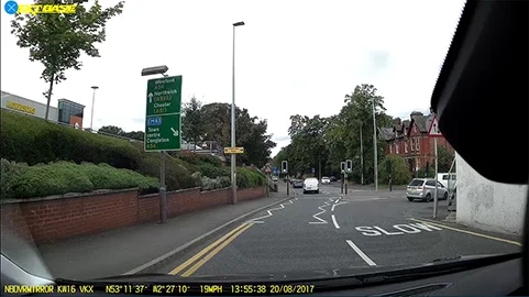

I do have a couple of reservations about the Mirror DashCam and the most important one is about its fundamental design. Because the mirror is angled towards the driver, in a RHD vehicle this means that the camera lens which sits on the left side of the mirror is set back from the windscreen (in my car at least) by a significant amount and unless adjusted would point pretty much towards the nearside. To make the camera point straight ahead with my seat configuration requires swiveling the lens to the extreme of its travel. If my seat were just a couple of notches nearer the steering wheel, thus increasing the mirror angle, I think it might be difficult to make the lens point straight ahead at all. Obviously this issue will vary according to the relative angles between the driver's seat and the rear-view mirror, and may not be a problem at all for a LHD vehicle but it is something to consider before you buy (which I didn't!). The other disadvantage of having a camera integral with the mirror is that it inevitably lines up with the mirror mounting which in my car comprises a large black box containing all the clever windscreen-related electrical gubbins you should never leave home without. This box produces a substantial and very obtrusive blind spot on the video which simply can't be avoided (see attached screenshot).
The only other negative observation so far is that the date/time stamp on video files seems to be a bit erratic, especially when starting up and before the GPS kicks in. One effect of this is that journey segments don't always play in the correct order when loaded into Replay3. I'm not sure yet whether this is because of something I'm doing wrong or if it's by design but from some of the comments in other threads I'm beginning to think it might be the latter...
