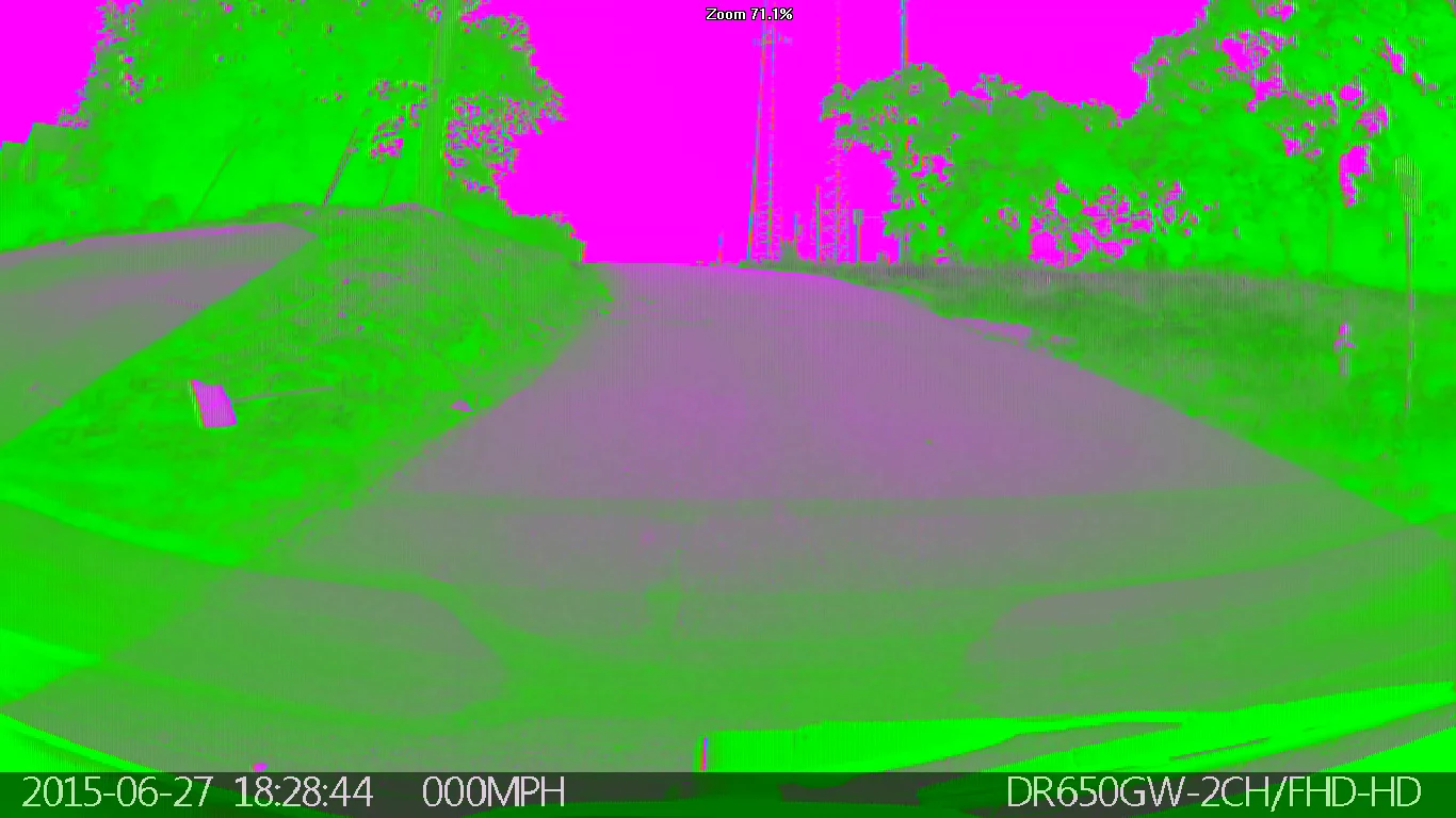

Only a few months old and now this?

i've seen a post about this before, now mine is doing it. i'm pretty sure it's not the cable. the cable is fixed, not pinched or abused, and the rear cam sits out of direct sunlight behind tint. any ideas?? by the way this is the rear camera...
rear connector coaxial cable on/off and 99% will work.
But it happens often, you should always check.

thanks for the replies... about the cable, you're saying to disconnect and re-connect the rear cable while the unit is on, or should i power it off first?
when reconnecting the connector of the coaxial cable unit always need off
if after 2-3 attempts at no change, then you need to look cmos

just making sure.... i'll give it a shot, thanks!
