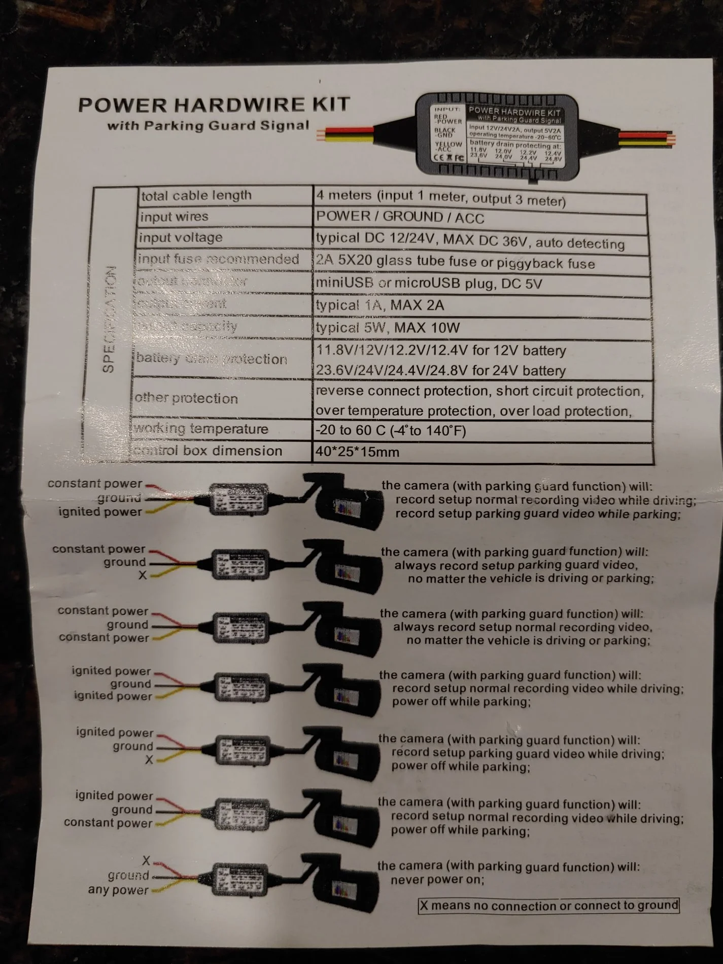

Just got the new one in the mail. Came with this nice guide. Will try to install tomorrow.20200105_211030.jpg
Yes, that's the guide I got with mine, exactly the same as well I think.
I think the same hardwire kit is sold under several brand names although the unit I have doesn't actually have any branding on it.
Tested it yesterday and seems to work! I only tested with the first two modes from the picture.
