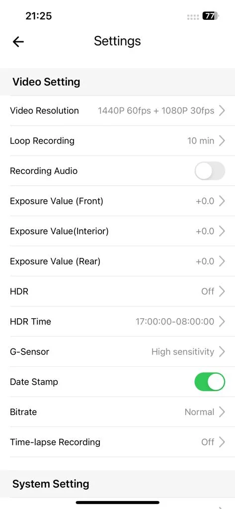

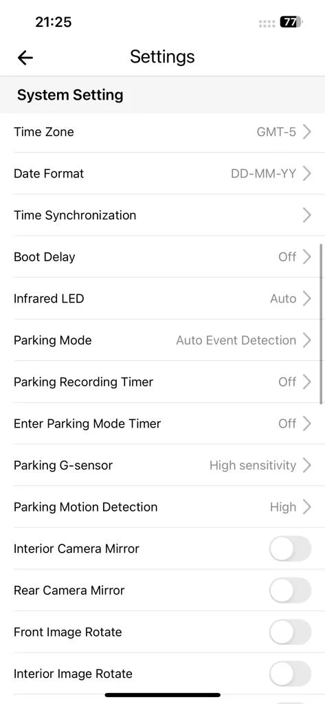

Please see the attached photos for the settings. The photos were screencap couple days back and I have changed some of the settings, please read the following notes:
Setting 1: The G-Sensor here is for driving. (I had it changed to low, because it has been saving videos after a small bump)
Setting 2: Parking Motion Detection was changed to Low.
