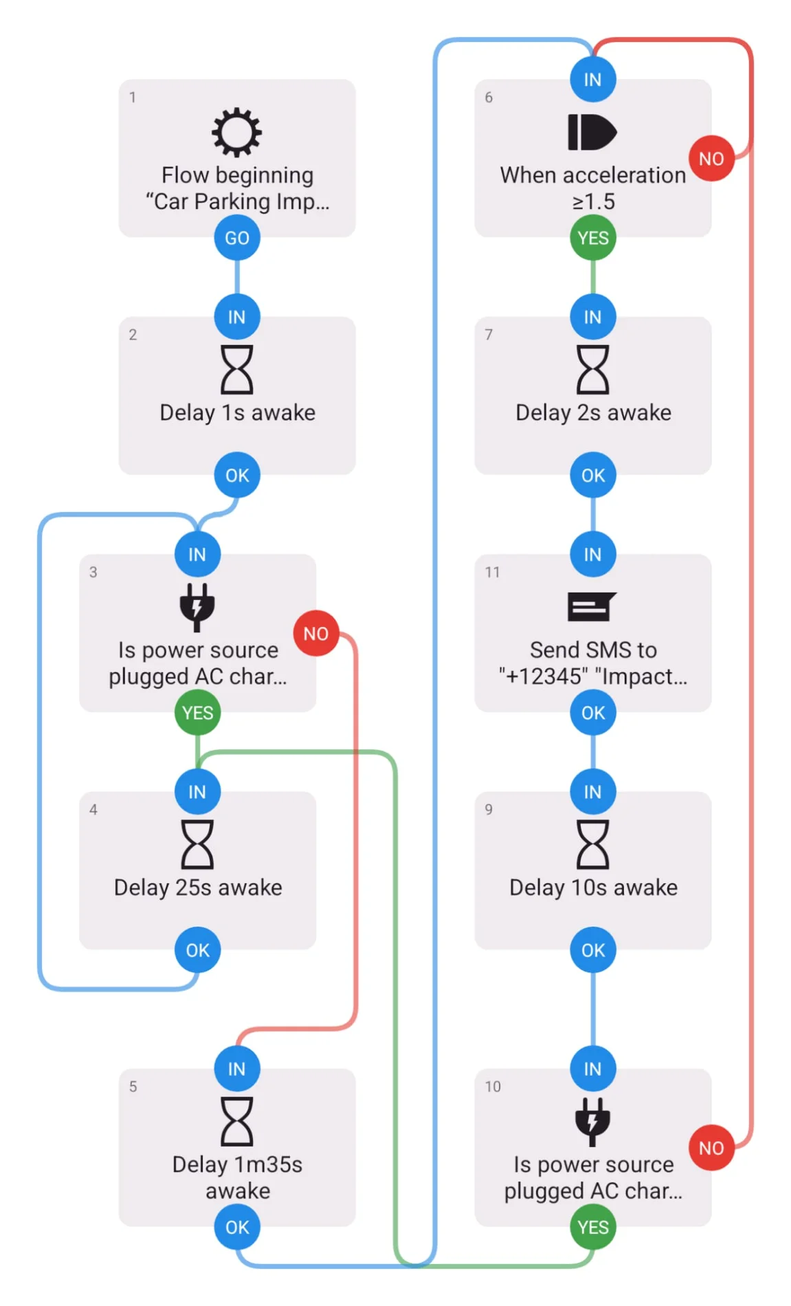

This is how it is looking the flow and you can edit with the values you want.

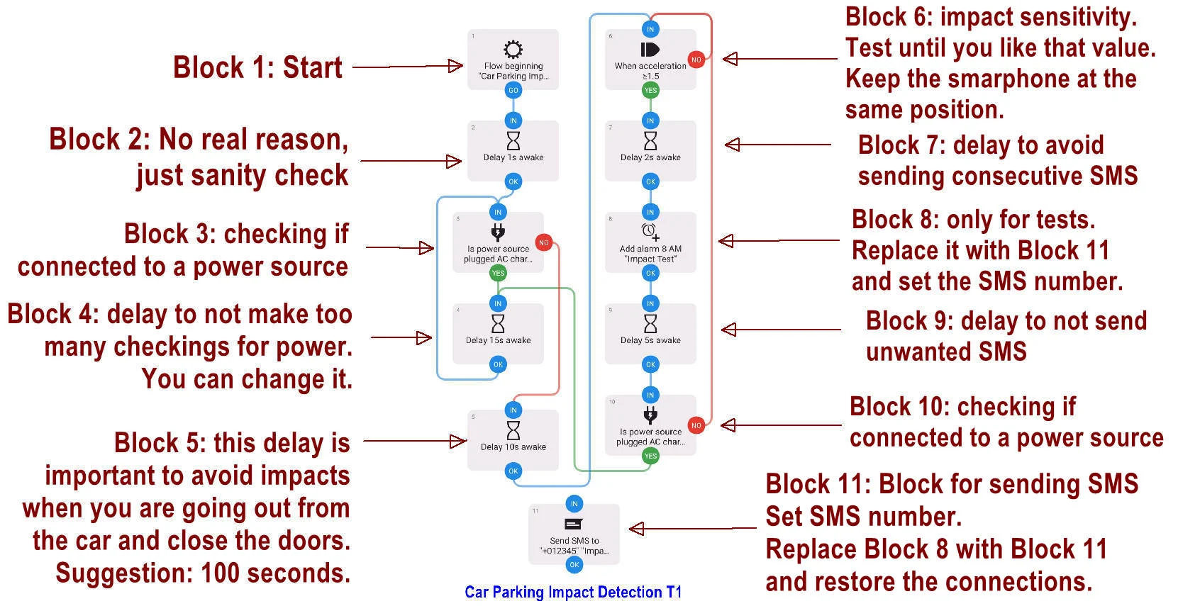

Some functions and explanations of the test version of the flow:
When you see in the log the @1... @2... @3, etc, they are the number of the Blocks. When you will see another block for Delay, for example, this means the smartphone detected something
For example, just look at the above LOG screenshot and the delay blocks meaning are:
Block 4 appears in the log only when there is a charger detected
Block 5 appears in the log only when there is no charger detected
Block 7 appears in the log only before sending the SMS (or alarm set)
