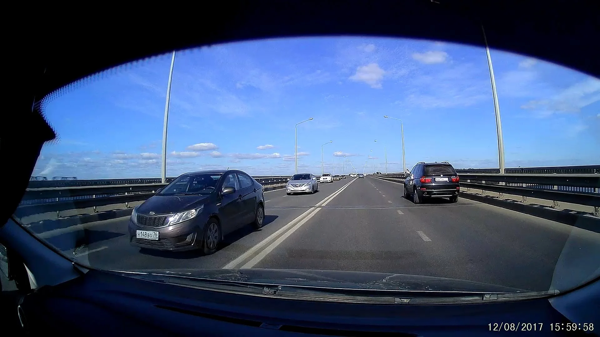

The experiment with another lens, holder is metal. + - 130°
TDR-700  и Крис П , мост через Волгу.MP4_snapshot_00.07_[2017.09.13_19.02.37].jpg
The lens holder needs to be !
It was established in the first issue 119S !
