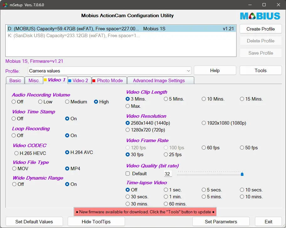

If it helps you, here are my M1S image quality settings:
I use MP4 and H264, and maximum bitrate.

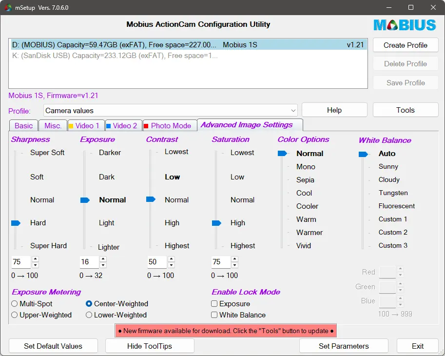

I have a telephoto lens in my M1S so you may find different settings work for your lens. Here's a sample video frame in good lighting.

Thanks, this was helpful. I think changing the metering to center-weighed helped as did increasing the saturation. I still find the playback to be choppy vs the old camera videos so I am wondering if I need a faster SD card.
