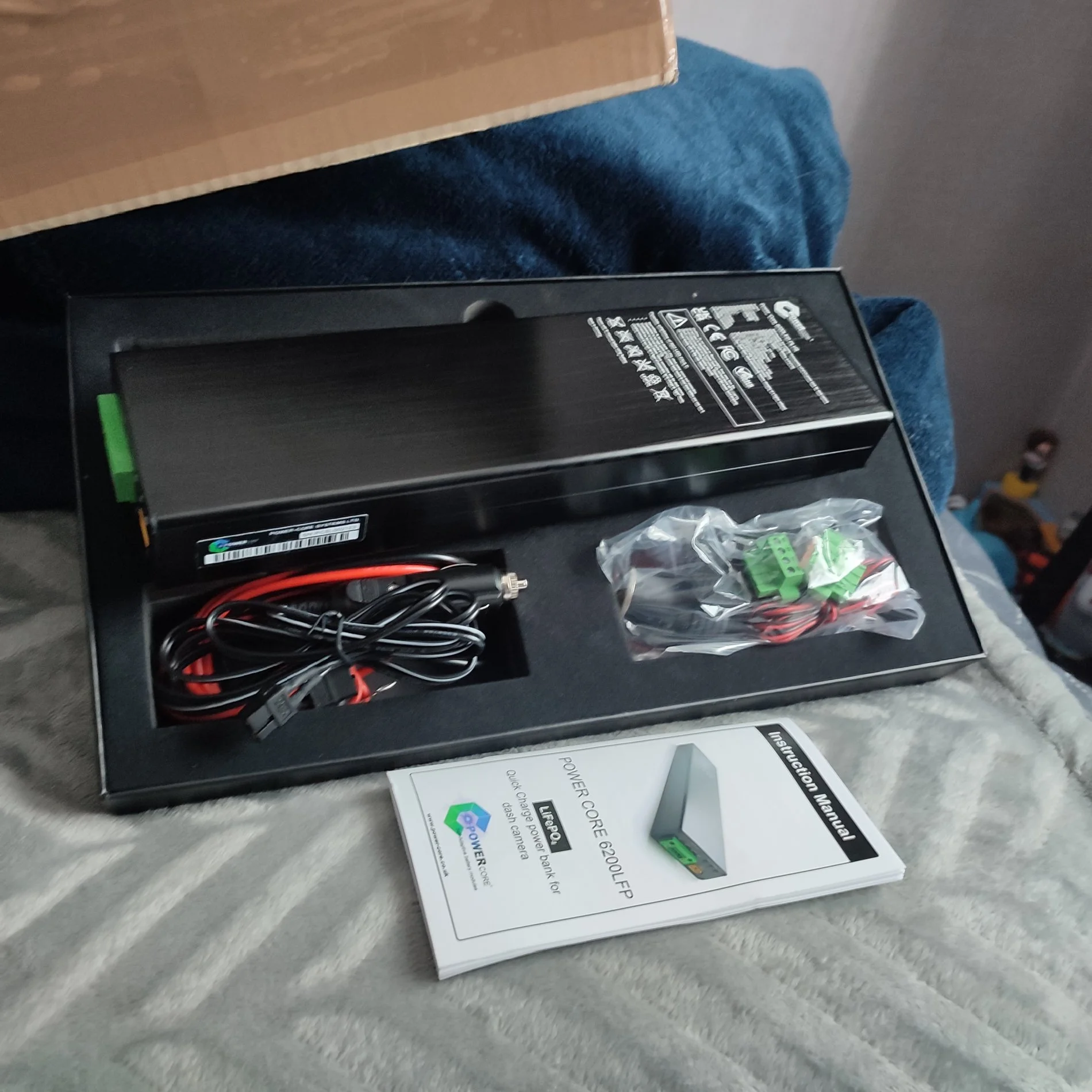

New battery arrived today, i have to admit it feels well made, prolly install it tomm if no rain, just going to use the velcro attachments to go under glove compartment on the outside in the footwell.

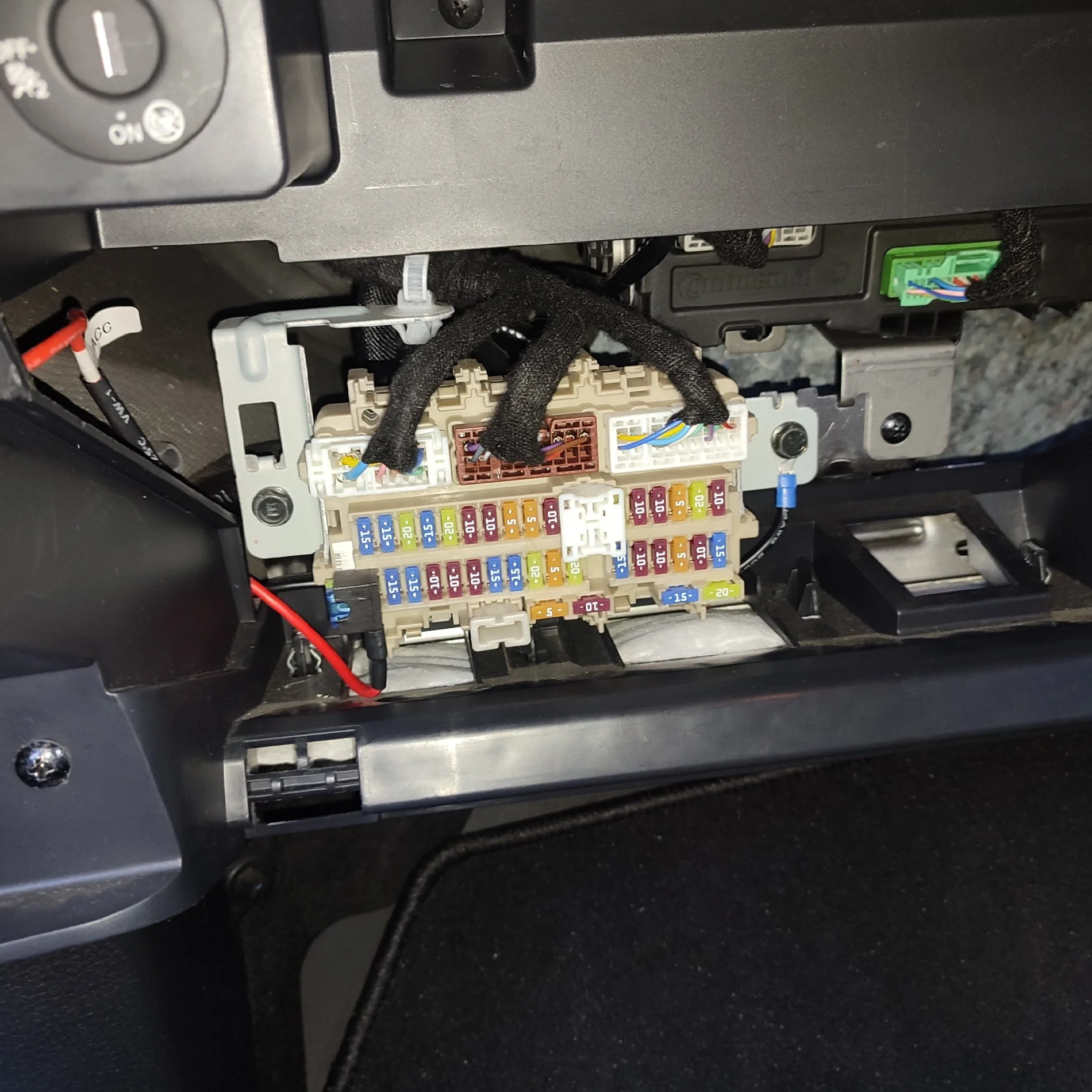

So tonight I installed the battery under the seat, all sorted then fault light, till I realised the engine wasn't running so car battery must have been low, started engine and everything worked as it should. I have left the battery in front of the seat for a few days to make sure all is good, wanted to use a spare heated seat fuse but the piggy back would not fit so wired to the 20a blower fuse.
