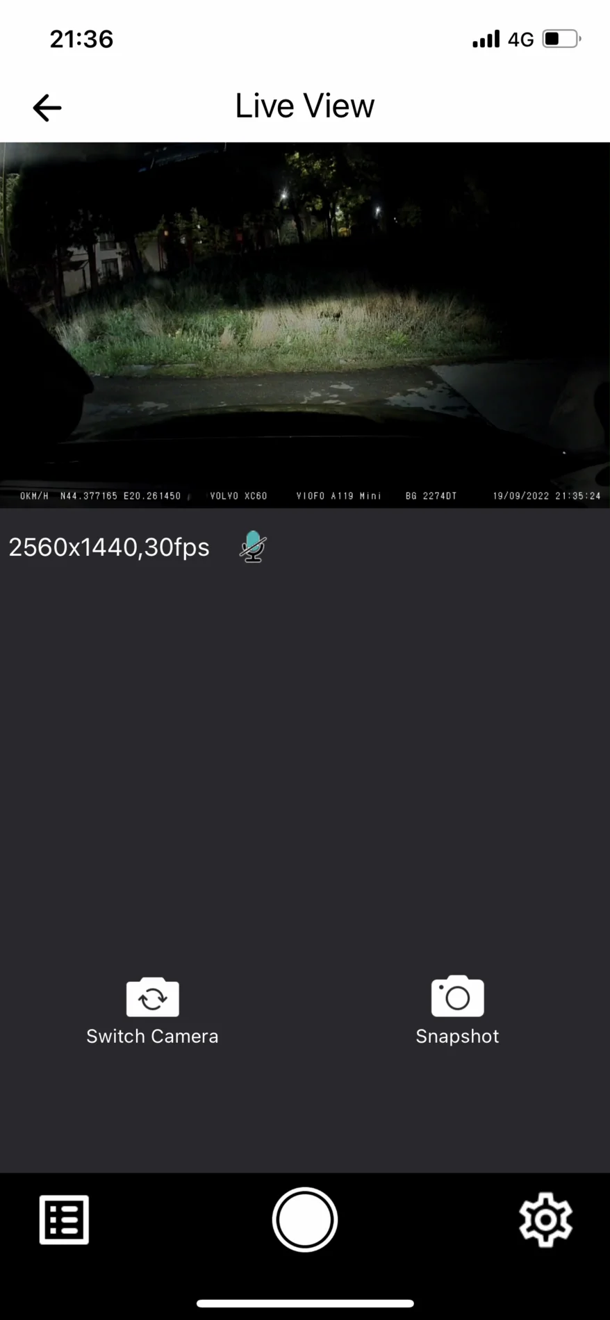

I choose 1440, 60fps but it keep 30fps???
Restarting camera didn’t help.
Should I try factory reset?
FW: A119 Mini_V1.1.20220817
App version: 2.9

It appears from your settings that HDR is set to "Auto" and the "HDR Time" setting has a value of On = 19:00 and Off = 07:00. When HDR is active, the fps will be dropped to 30 fps.
There is a bug related to the restoration of the fps value to 60 fps when outside of the HDR Time time period. I just tested an updated test firmware that appears to resolve the issue.
You may want to review this other thread about the same issue: https://dashcamtalk.com/forum/threa...amera-changes-the-resolution-by-itself.47670/
I came to same solution. HDR is an issue.
