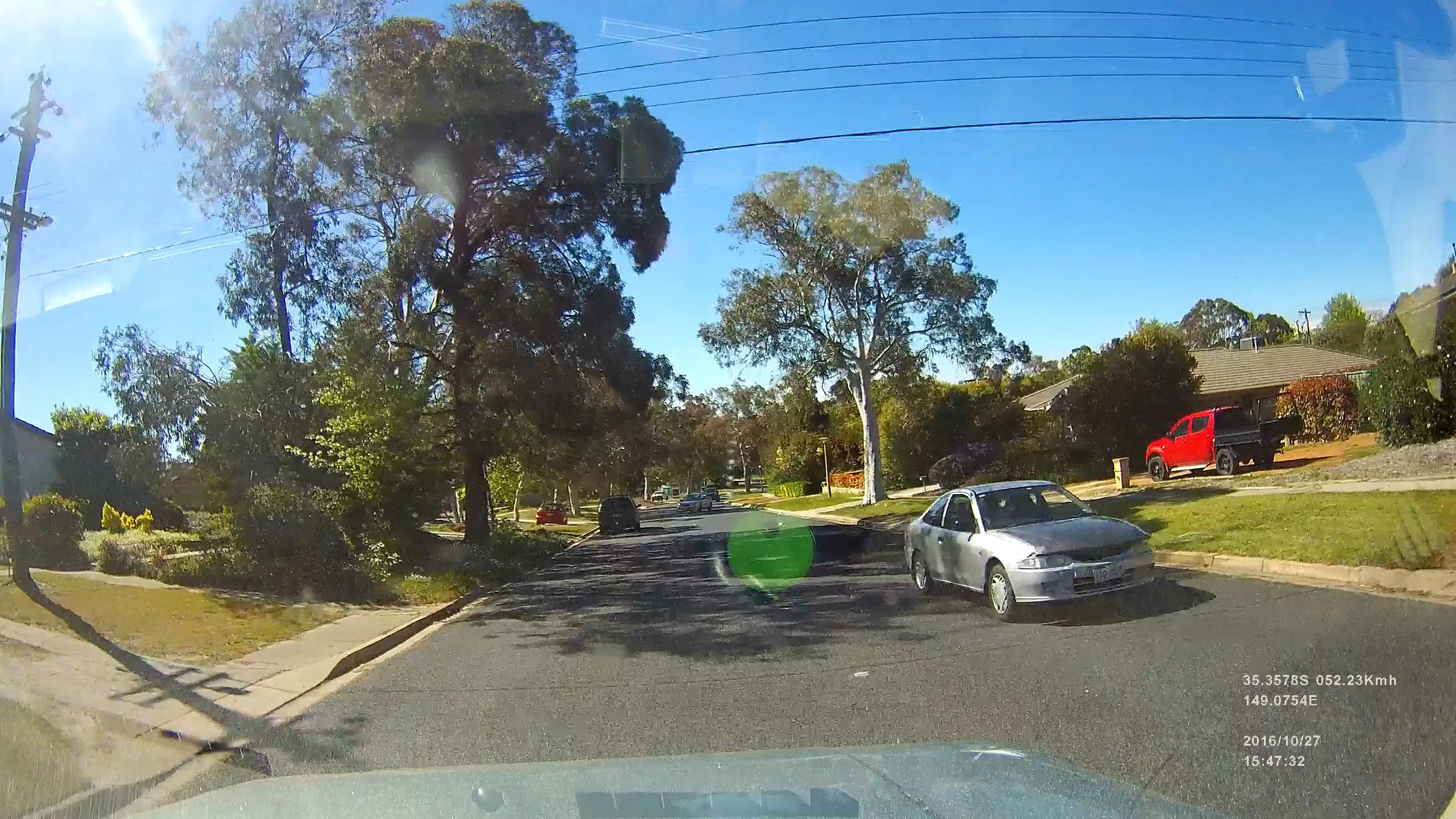

Today I had an incident where two cars up in front of me had a coming together and one took off passing me going the other way - tracked the car as it came towards me then as it went away - all caught on the dash cam but neither at the front or the rear was I able to read the number plate.
From the front - the silver car about 20' away zooming in does not help

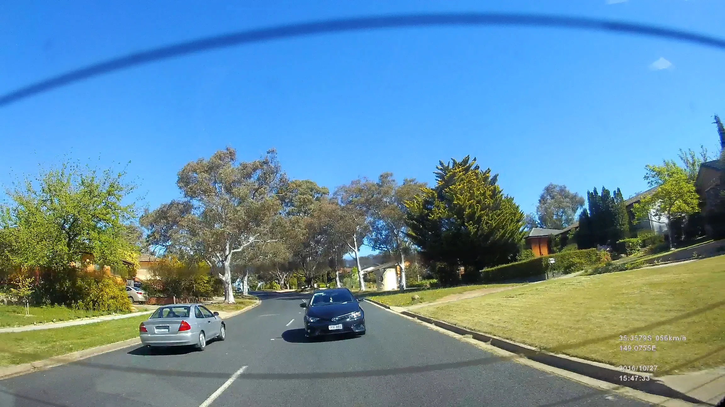

From the rear - zooming in does not help reading the number plate of the silver car but the blue car is easily read. The camera was looking straight at the blue car but the silver one is a fair way to the left.

This is the first time I have really needed to use the dash cam for an accident and while the general vision is moving vision is available and OK, it is not good enough to read the number plate of the silver car even when the movie and still pics are zoomed in. So it has failed my needs.

Also - resolution would seem to be best what the camera is looking at like the blue car but not so good at its extremities which I guess it understandable.

Thanks for the comments - changed the resolution but number plates are still readable - I think it is the lens in the dash cam and the glass in the windscreen. When looking straight ahead directly through the windscreen, the camera does alright however at a wider angle where the light travels at an angle through the windscreen glass and comes in at an angle through the lens things like number plates are not readable.

My take on this from my limited knowledge of cameras - 3 factors in my opinion:
1. Many cheaper lenses as often fitted to dashcams often fall off in performance at the edges (there are reasons why eg Canon pro camera lenses cost £1,000K+ per lens)
2. Window glass - get more reflection and aberrations from this when looking at an acute angle
3. The car behind is travelling in the same direction as you and therefore the relative speed difference between your vehicle and that is near zero. The car on the other side of the road is coming towards you so the speed difference is the sum of your 2 speeds eg at 30mph, 30 + 30 mph = 60 mph.
Now you're probably wondering what the significance of the relative speed is. Well it's to do with the rate of change of the data the camera is recording. The car behind, because it's hardly moving relative to yours, hardly changes from frame to frame, so needs very little compression (I understand many compression systems work by comparing the current frame with the previous frame and just recoding the data change). The more change and data to be recorded, the higher the compression and the more data is discarded resulting in more inaccuracy in the uncompressed picture. That's why when you watch people's dashcam videos with trees at the side of the road, often the car in front and road are sharp, but all the trees at the side are full of artefacts and blur = a lot of data in the leaves and a lot of change from frame to frame in that data = very high compression needed, and a lot of subsequent data loss.
There's also little blur frame to frame, as the car behind is either moving straight away or closer with any speed change, so any change in position during the exposure time translates to a slight zoom in or out = a slight fattening of the letters. The car coming the other way on the other hand, is moving it's position a lot from frame to frame (closing speed around 60mph at 30mph each), and so needs a lot more compression as the data change in this area high as it's position is changing rapidly, and compression = artefacts = a less clear picture. The plate is also moving a lot relative to your position as it's not coming straight at you but from an ever changing sidewards angle and so any distance travelled during the exposure time per frame translates much more to blur as the sides of the letter blur sideways during the exposure due to the fact it's travelling sideways across the frame relative to your position. This tends to make the letters blend together and become unreadable. So, in summary, it's harder for the camera to deal with the faster sideways (in the frame) moving object of the car coming towards you.
