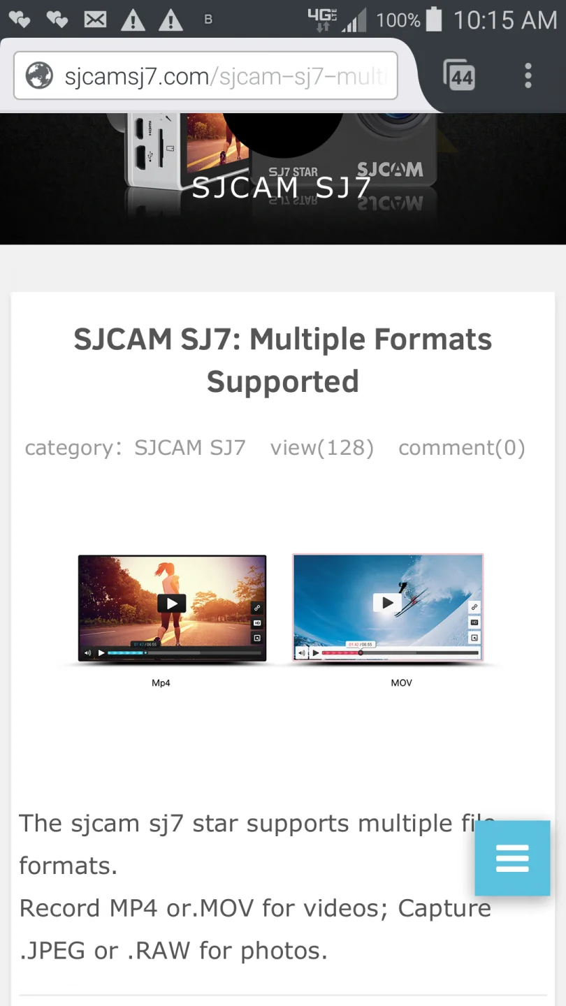

And here's one of there adverts I read while researching whether to buy a sj7...it clearly states RAW as a feature.

Hello Guys, we are waiting for RAW support from Ambarella. This feature should be able to be added in the near future. Thanks for your patience.
