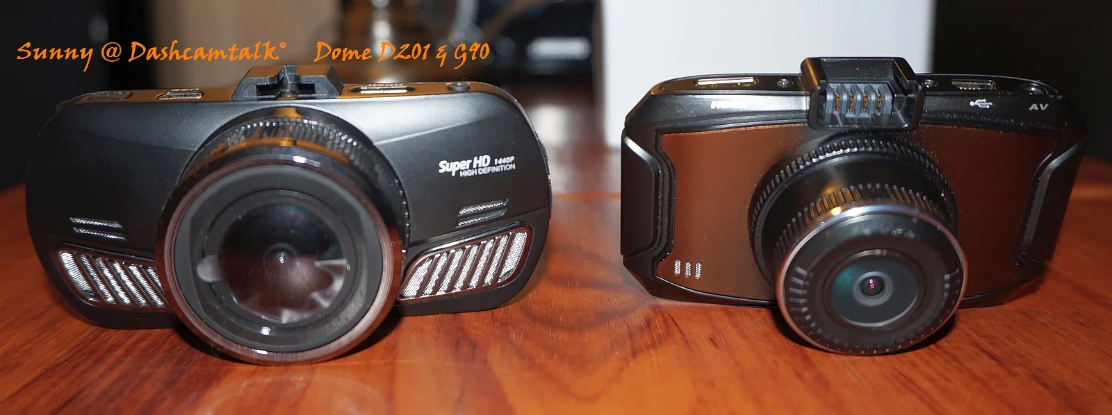

Camera looks like it's built good.
The front has some vents that are not black but everything else is black.
Lens housing is huge (as with most Dome dashcams) so is the lens.

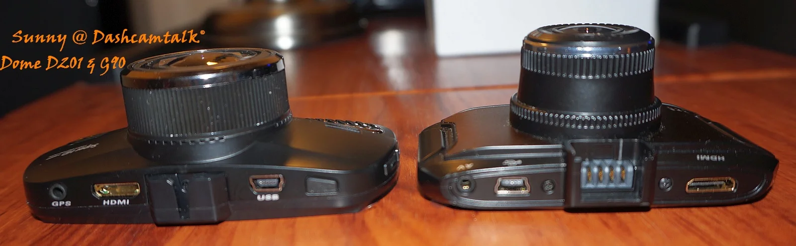

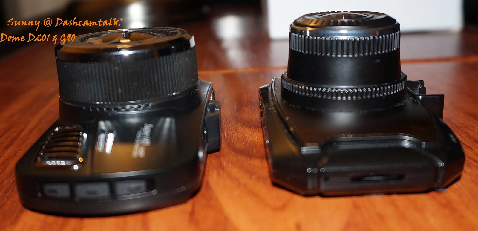

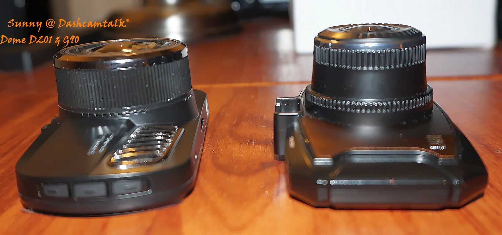

Side-by-side with Dome G90 7S: It's slightly wider and thicker body but overall height is less than G90. G90 is taller due to the lens housing.
Front:
Back: 2.7" LCD with labels for buttons but actual buttons are on the sides.
Top: 2.5mm GPS port, mini HDMI, mount, mini USB and Power buttons.
Mount just slides in and out, no locking mechanism.
Bottom: MicroSD card slot.
Left side from back: Mode, Menu and Event buttons.
Right side from back: Up, Down and OK buttons.

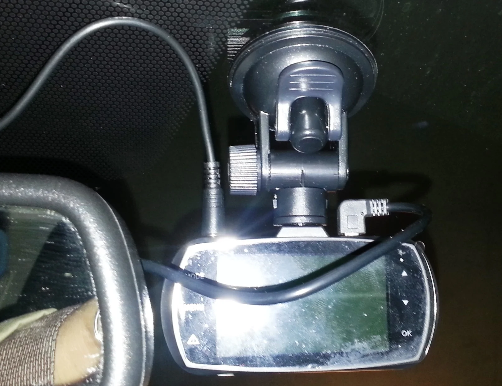

The right angled tip looks weird if mounting on the right side of RV mirror but left of RV will be better looking.
Should be fine for taking it around the headliner though.

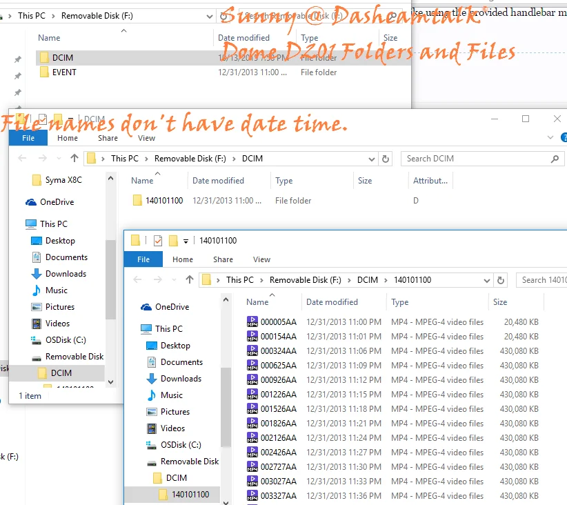

Folders and Files:
This has weird folders unlike other Dome dashcams.
Root folder has DCIM and EVENT folders.
DCIM has a folder that's named very weird like some generic Novatek based dashcams.
Files are also named generic without date and time.
Definitely some backward move there.

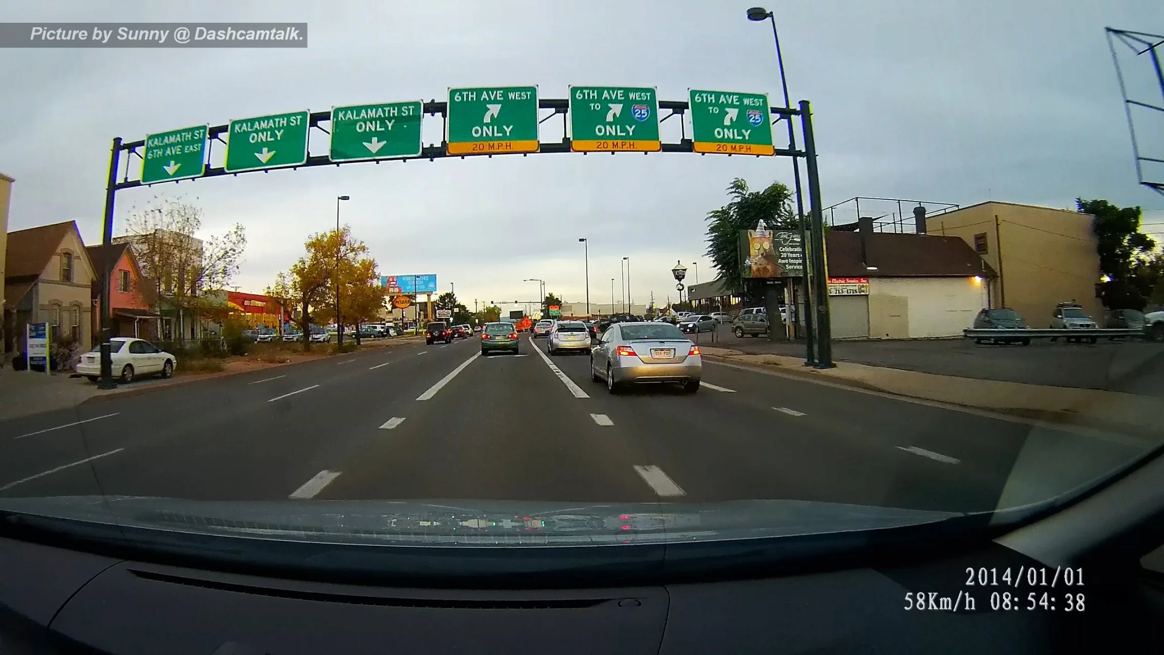

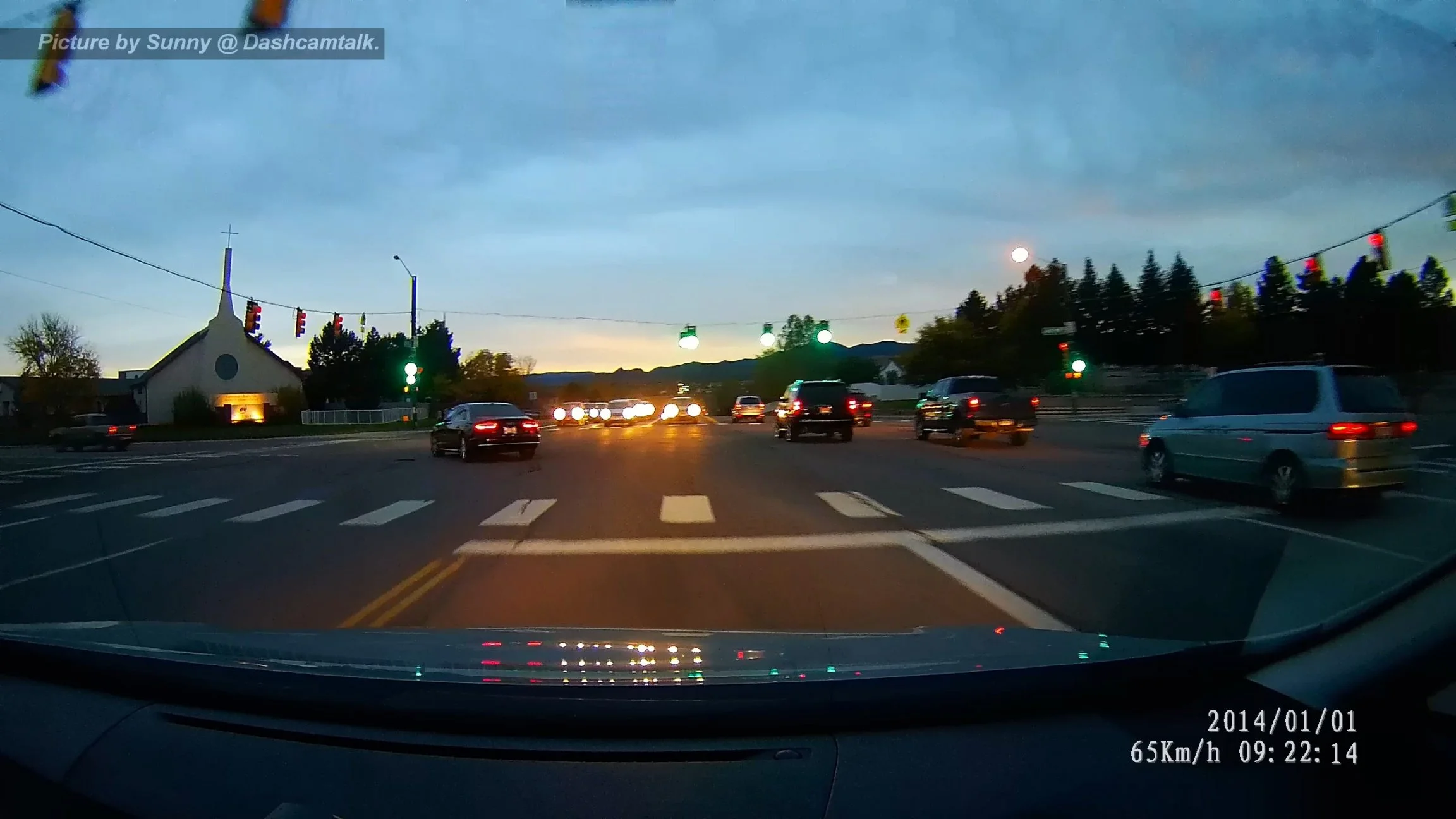

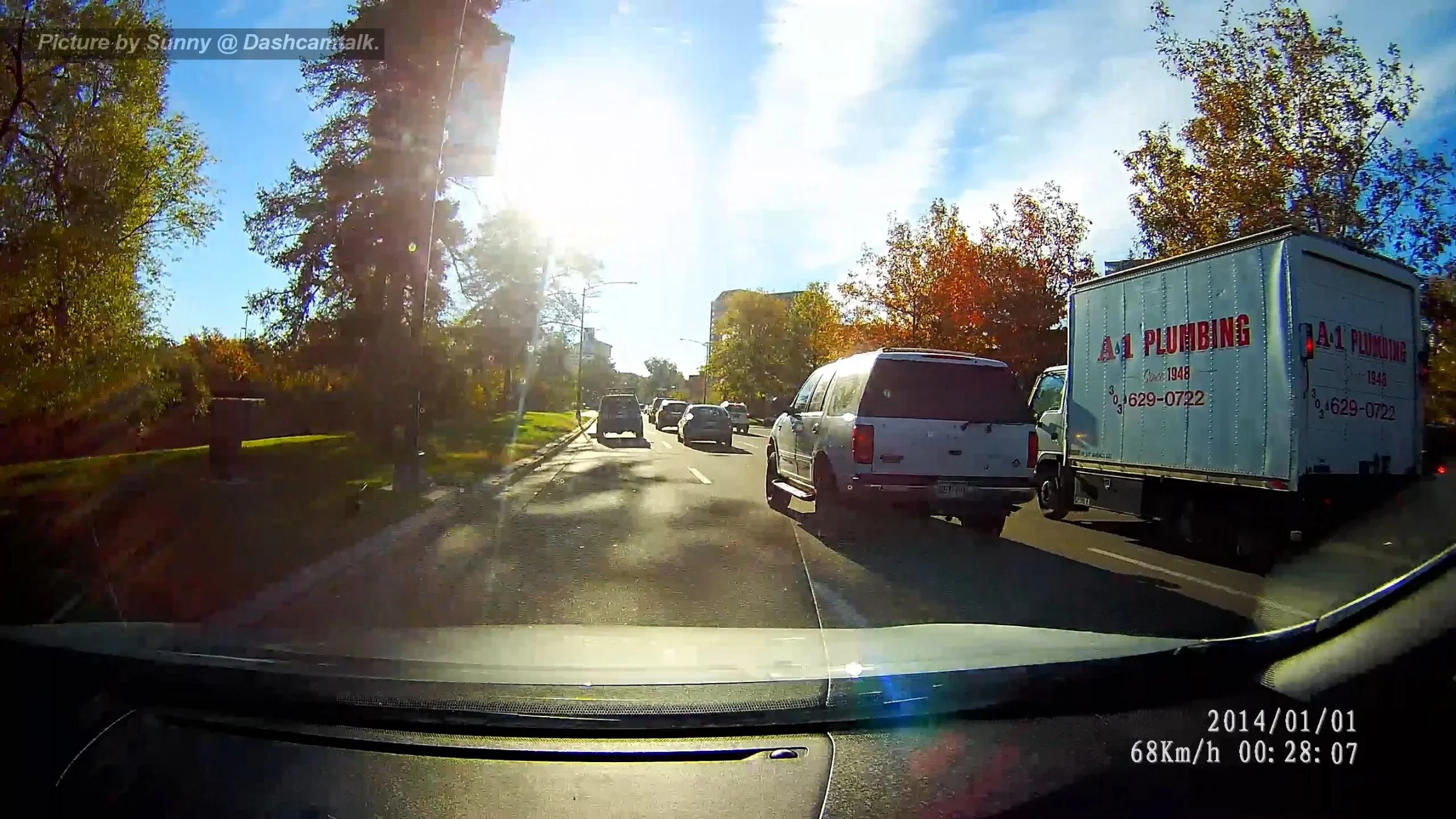

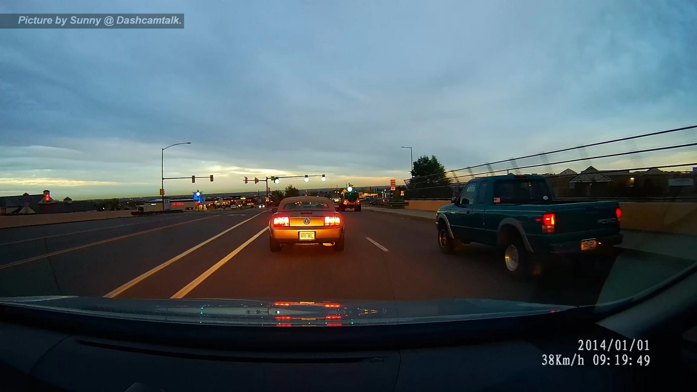

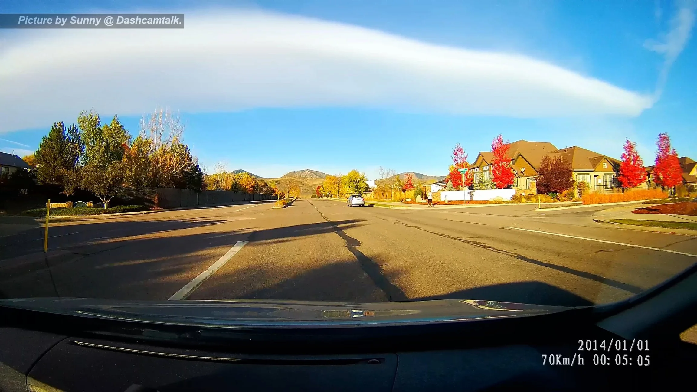

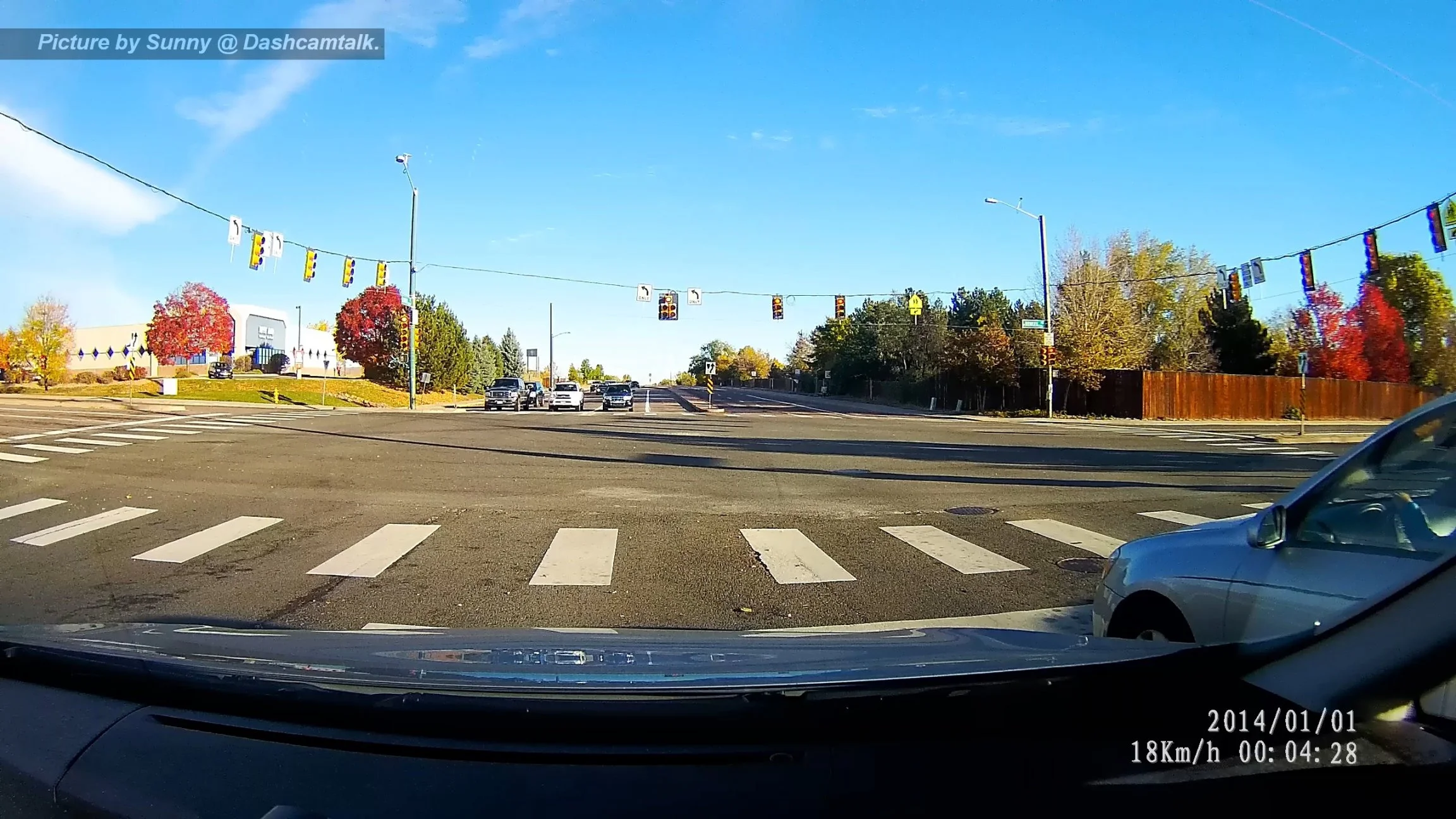

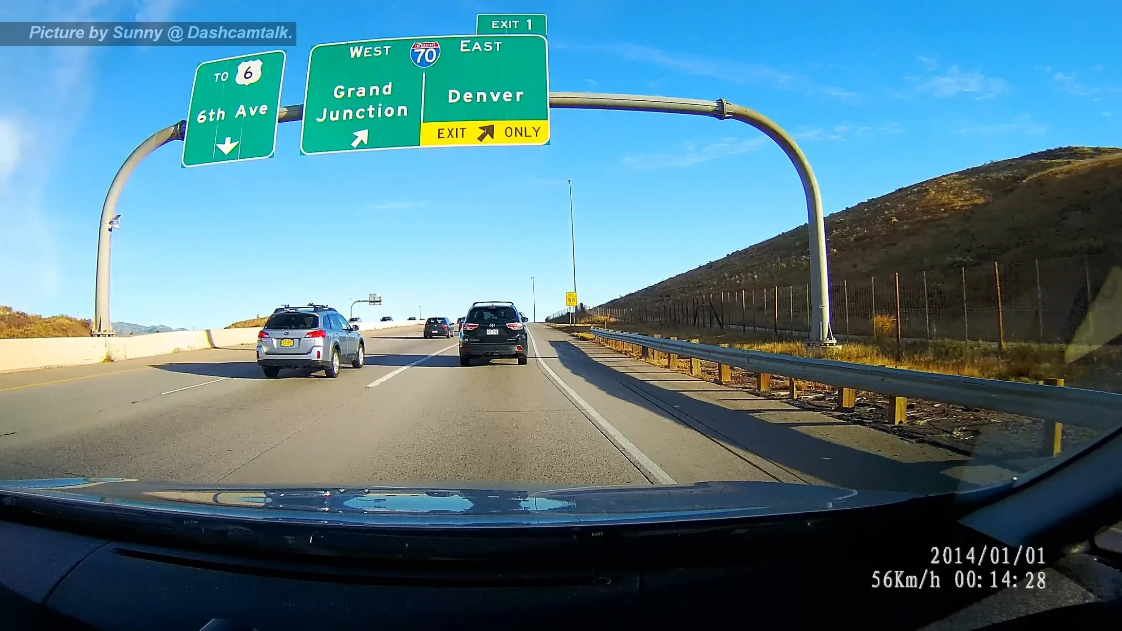

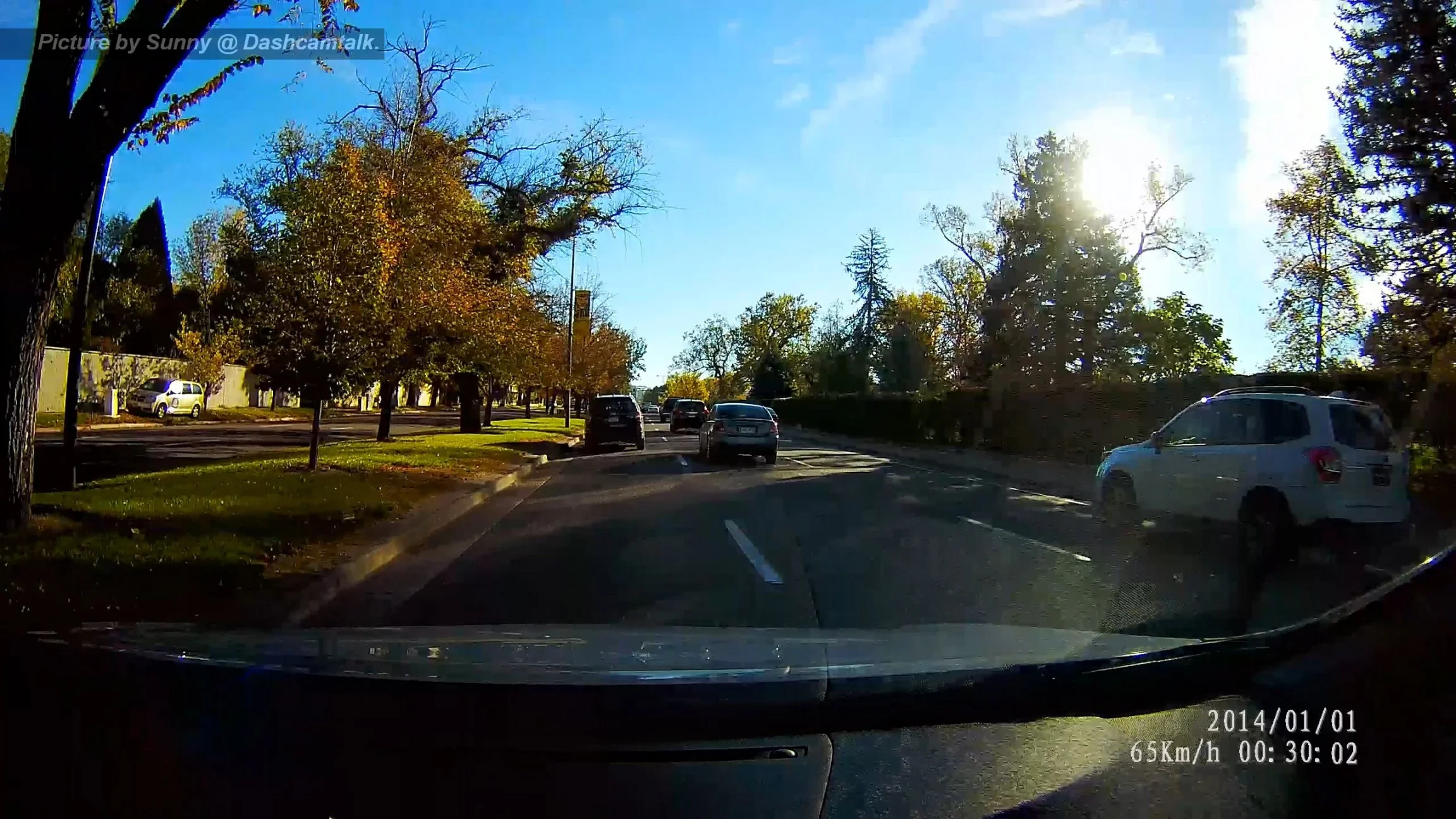

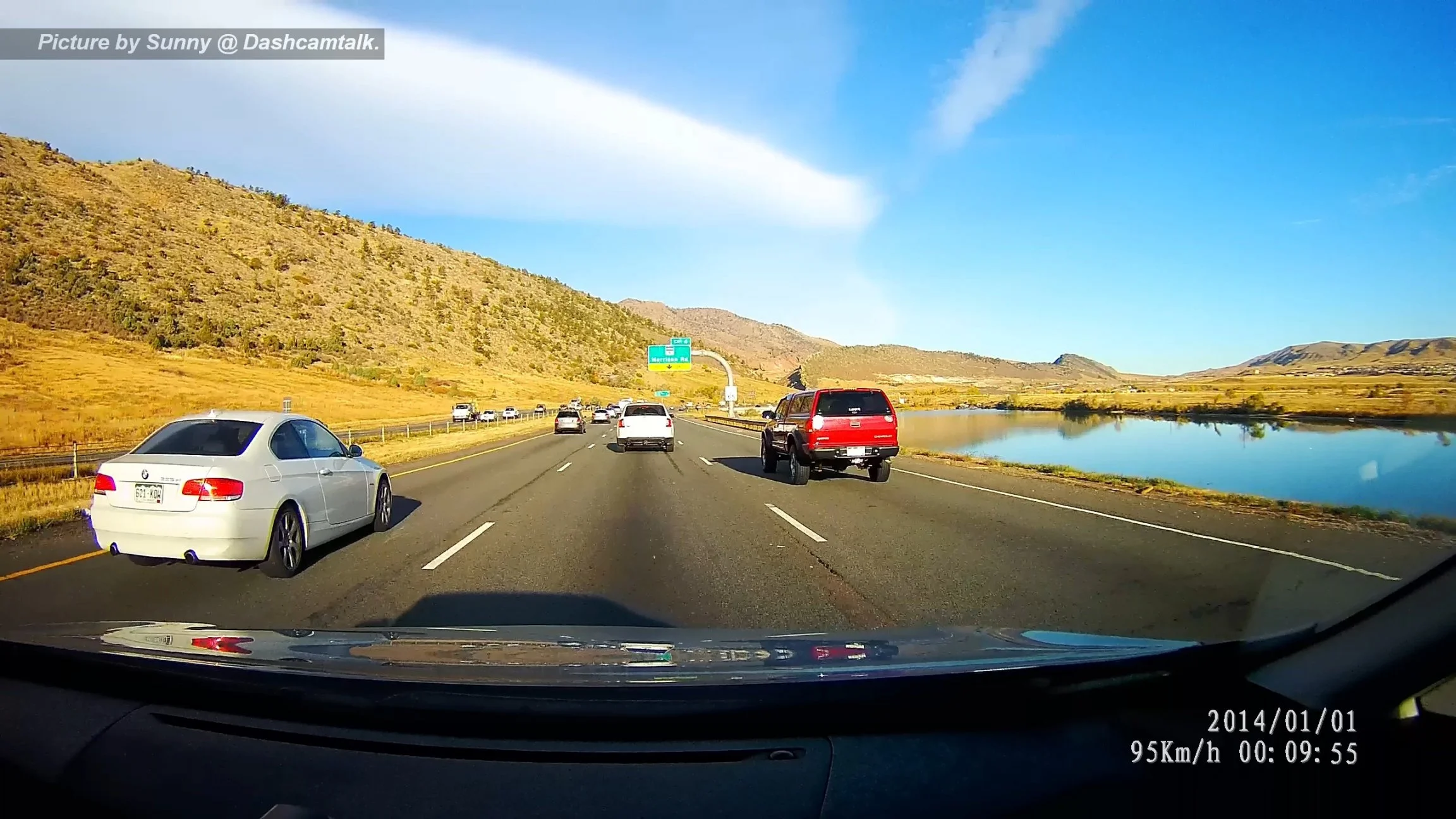

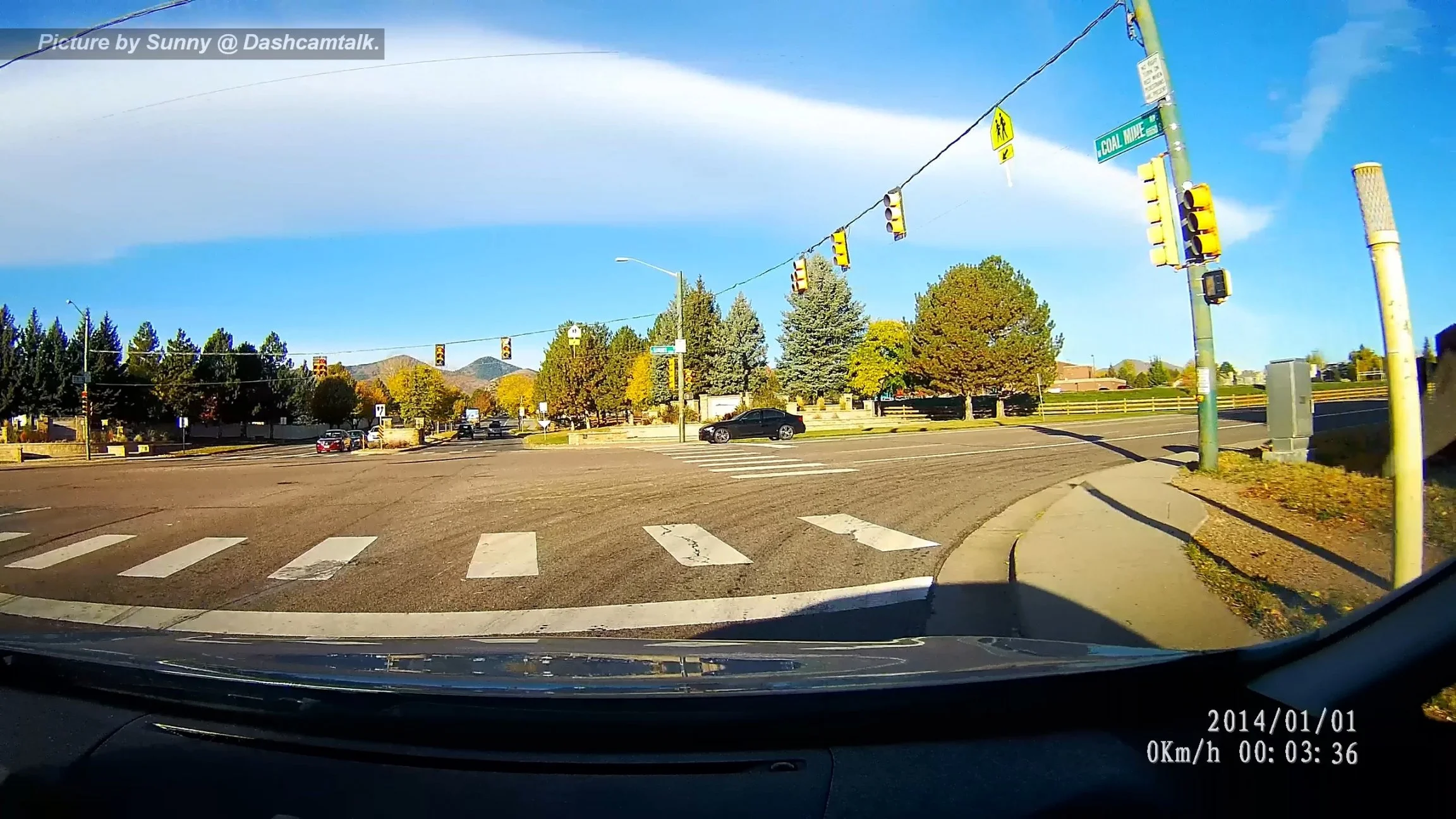

Daytime Screenshots (part1):
My i5 laptop can't play the video smoothly.
It plays but I see it like slow mo. :(
Video is excellent quality.
The resolution is really good. Everything looks smoother and cleaner.
Colors are good and exposure is very good.
000324AA.MP4_20151028_192623.343.jpg 000324AA.MP4_20151028_192652.562.jpg 000324AA.MP4_20151028_192702.406.jpg 000625AA.MP4_20151028_192850.640.jpg 000625AA.MP4_20151028_192904.296.jpg 000926AA.MP4_20151028_192959.546.jpg 001226AA.MP4_20151028_193030.703.jpg 001226AA.MP4_20151028_193042.500.jpg 002727AA.MP4_20151028_193217.968.jpg 002727AA.MP4_20151028_193334.093.jpg

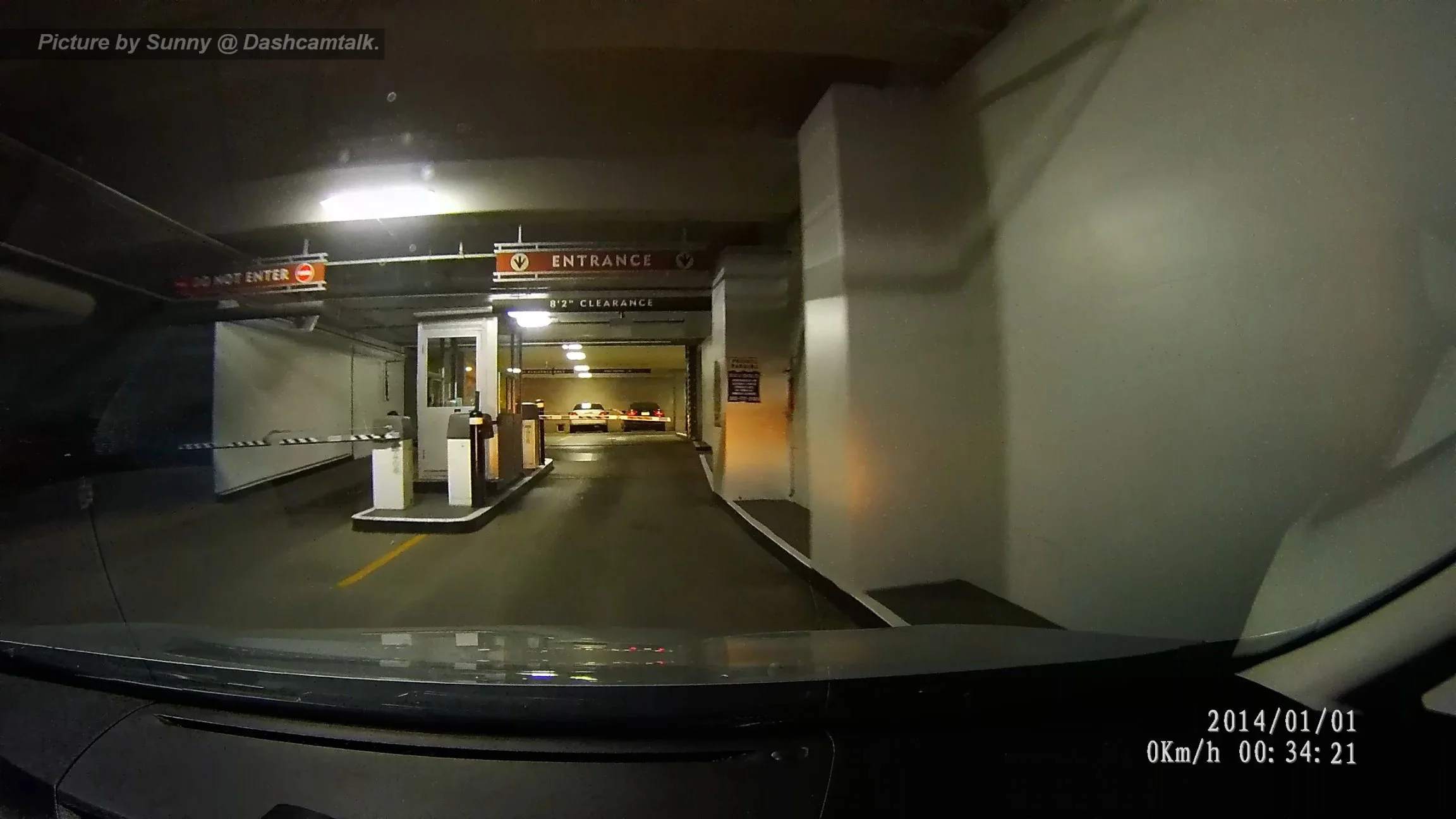

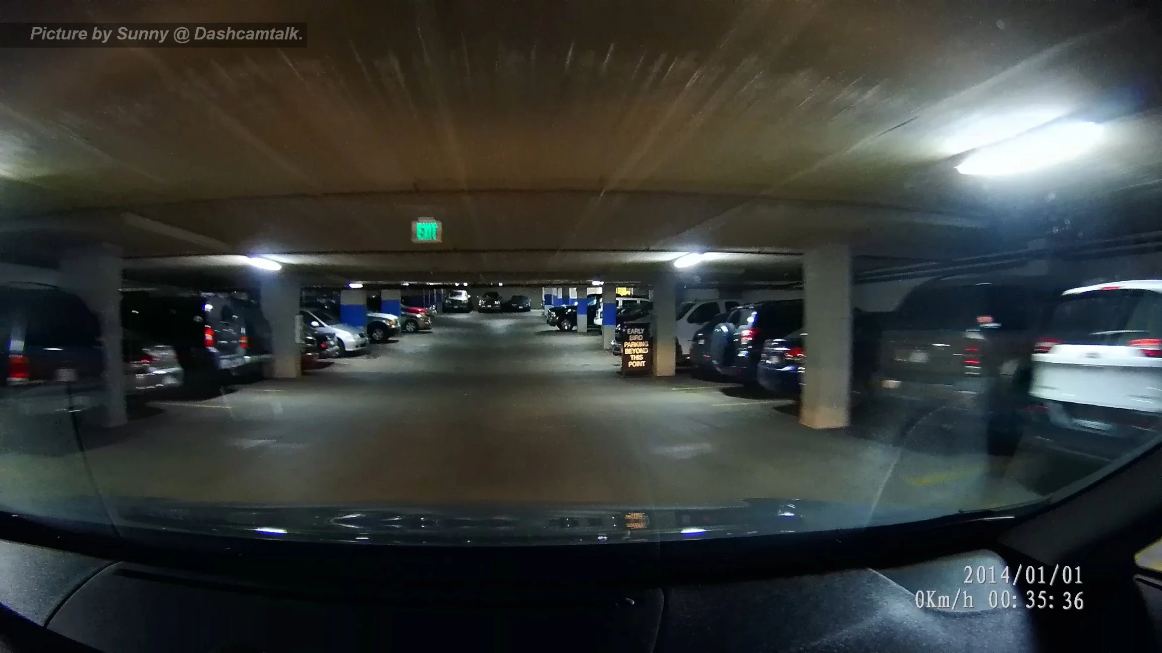

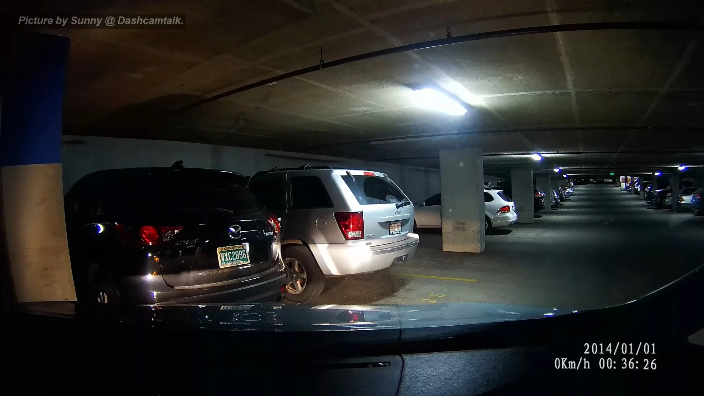

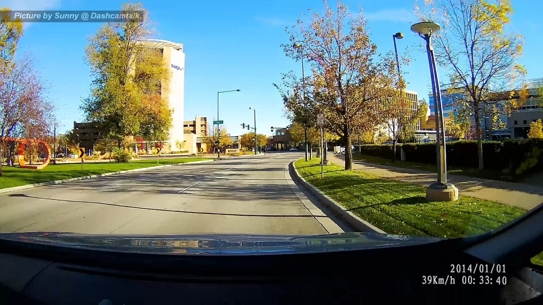

Daytime screenshots continued including underground parking garage:
@Dashcam Man
I uploaded 2560x1440p screenshots but looks like the images are limited to 2304x1296p.
I thought you mentioned forum allows 2560p.
Thanks for checking.

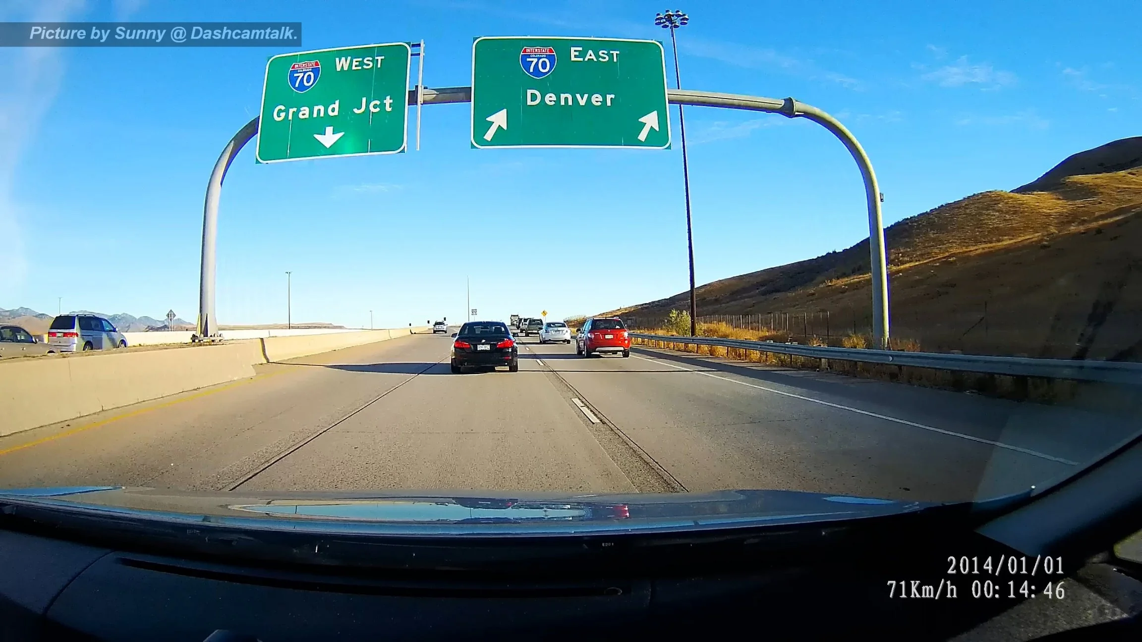

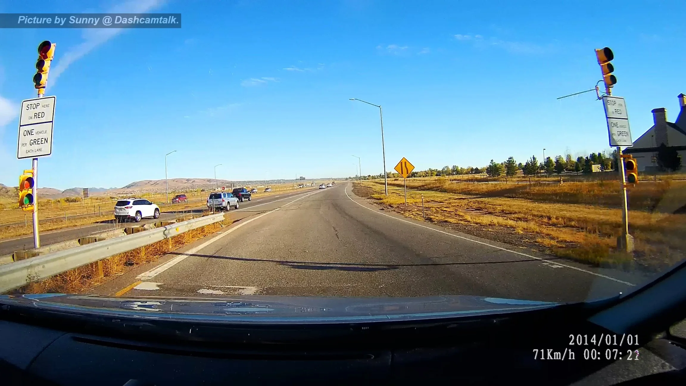

Daytime Videos: Video is excellent. Looking at 2nd video below, video appears as if it's slightly filtered.
Audio has some hiss/low frequency rumble at times but still clear and good volume.
Residential Area: Fall colors starting at 1:00, 1:50, 2:10 marks.
Highway: This small silver car has a dashcam but hard to see what model. Who can guess? ;)
Video appears as if it's slightly filtered.
Mountains and surroundings are little brighter and less yellow tone in real than what footage has.
Looks like what I see through one of my sunglasses.
Underground Parking: Very good quality for lighted underground garage video.
