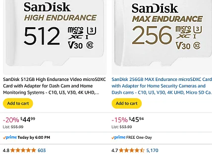

I've been using the SanDisk High Endurance 512GB SD card without any issues for 3 weeks (in multiple DR970X Plus').
Id previously been using 256GB SanDisk High Endurance in previous BlackVue without any issues too.

What's the verdict here? Samsung pro endurance or SanDisk max/high endurance?
Cheers
Both are probably equal.
I've used the Samsung Pro Endurance in previous DR750S and DR900S without any issues.
I changed to the SanDisk with the DR900X Plus and DR970X Plus.
As far as I'm aware, Samsung Pro Endurance doesn't come is a 512GB variant.
*Beware of the fake version of Samsung Pro Endurance 512GB being sold online for really cheap.
