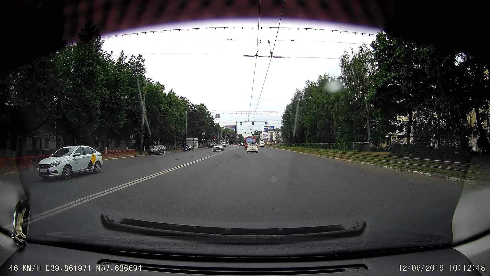

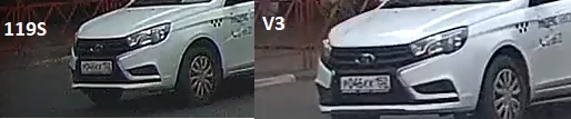

- Viofo 119V3
A119V3 and A119S.
A119V3
Stock ON V1.0 bitrate 25.8 Mbit / s
2560 * 1440 30 frames / s
Lens F1.6 = 95 ° in the horizon
Expo - (- 1/3)
WDR-OFF
CPL- NO
A119S
MOD software V2.61 with a high bit rate of 28 Mbit / s
1920 * 1080 30 frames / sec
Lens F1.6 = 120 ° in the horizon (alternative lens)
Expo - (- 1/3)
WDR-OFF
CPL- NO
Video originals, readability through one lane:
