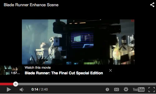

That's great! Some say that the CIA and NSA actually have software that can do that but the algorithms and hardware they do it with are highly classified.
As far as I know, the whole meme of zooming into a tiny reflection in an image started all the way back in 1982 with the computer detail enhance scene from Blade Runner.

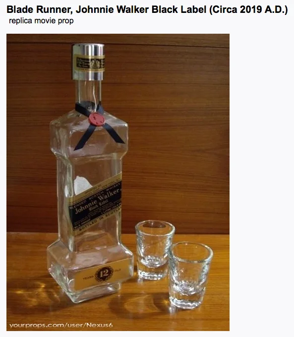

That's very interesting that you noticed that @niko but it's actually not Jack Daniels! :) It's a bottle of Johnnie Walker Black Label that Deckard pours a drink from. There are also two more identical Johnnie Walker Black bottles sitting on the table to the right of the computer. Then about a minute and a half later the computer zooms in on yet another identical bottle of Johnnie Walker Black on the dresser in the photograph he's enhancing. Apparently, this was an early example of movie product placement and that same whiskey bottle appears in several other scenes in the film as well.

It really was "detective" work and it kind of blows my mind because if it weren't for you mentioning the Jack Daniels I wouldn't have noticed the similar looking whiskey bottle that the computer zooms in on and seen that the iconic Johnnie Walker label was the same. That got me to do a search for "Blade Runner whiskey bottle" and I discovered a whole world of Blade Runner movie prop collectibles I never knew about before and learned of the product placement in the film. There's even a whole "thing" surrounding the unique Old Fashioned glass Deckard drinks the whiskey from. Up until then I was only aware of the holy grail collectible insanity about reproductions of the famous pistol Harrison Ford uses in the movie.
