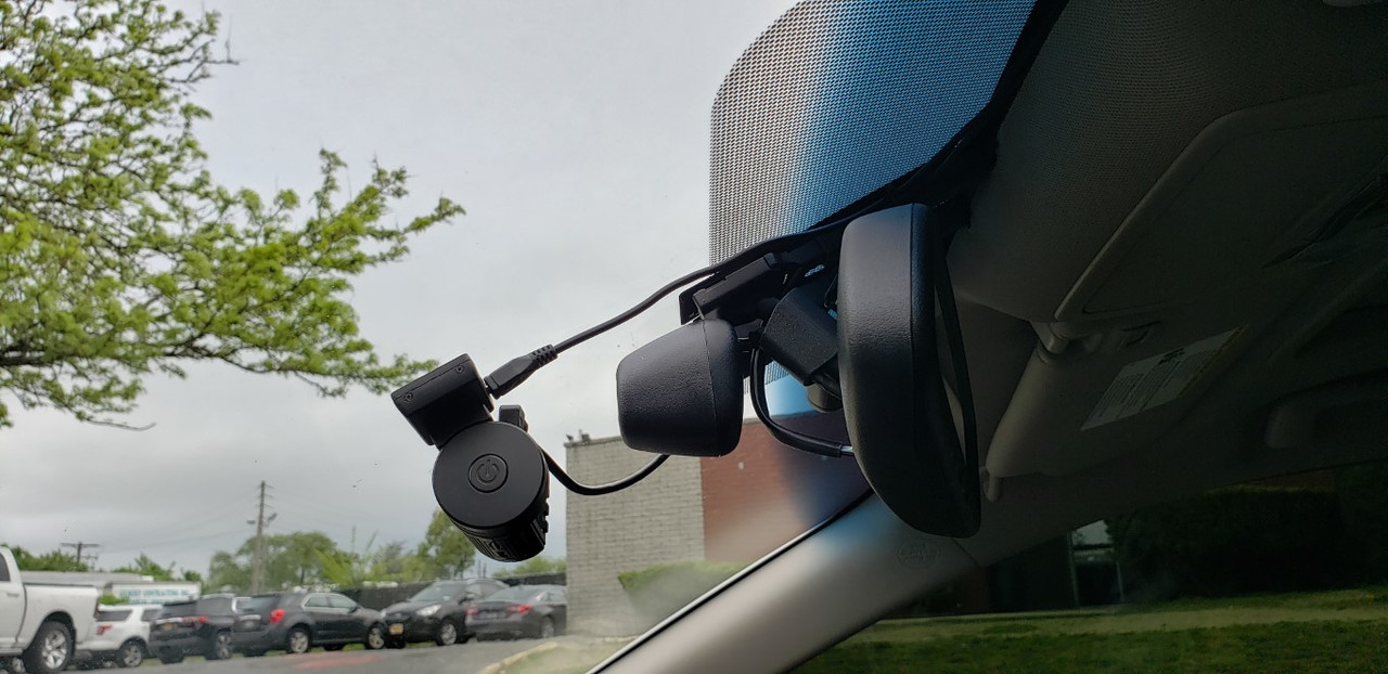

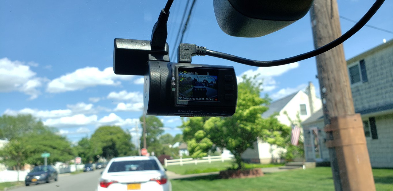

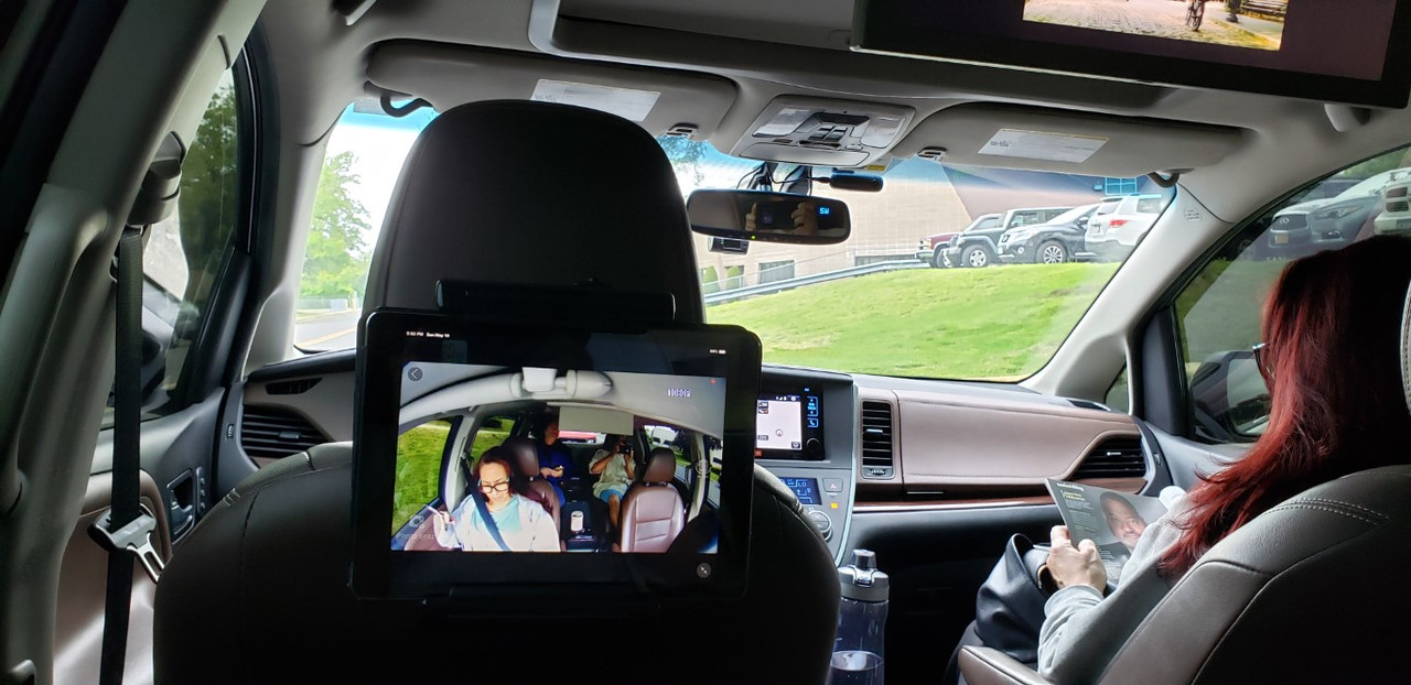

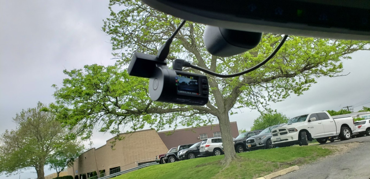

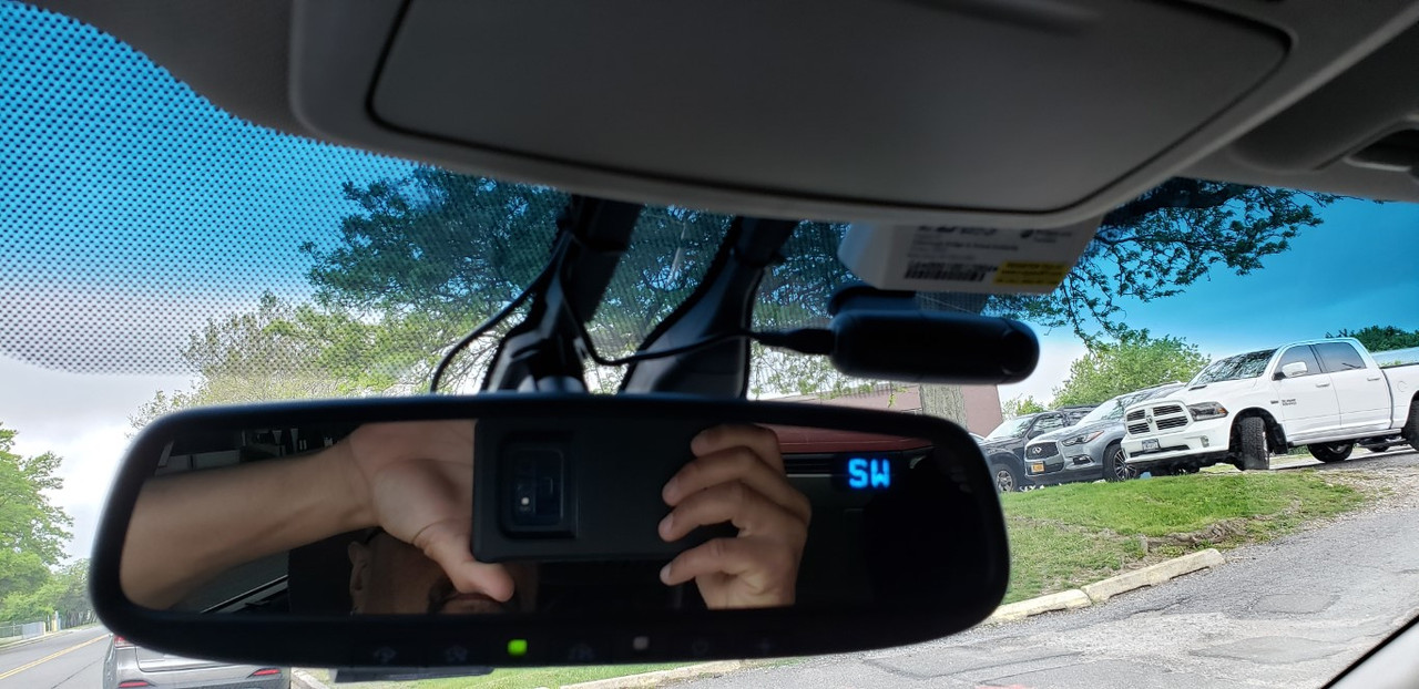

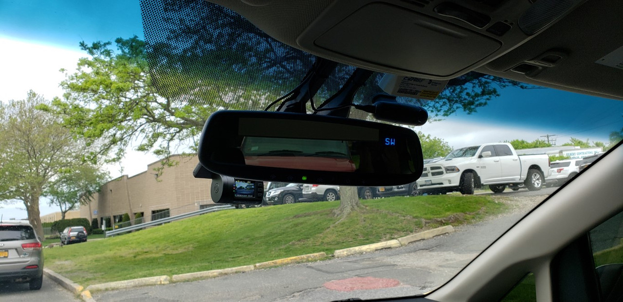

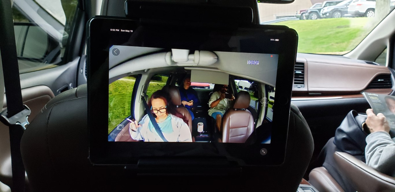

Recently picked up a replacement vehicle (2016 Toyota Sienna) and the first thing I did was install a Mini 0906 and a B1W for the interior.
Not too long after the install, it captured this accident while passing through Georgia

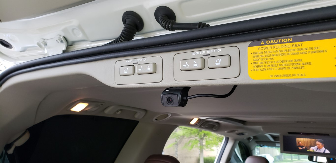

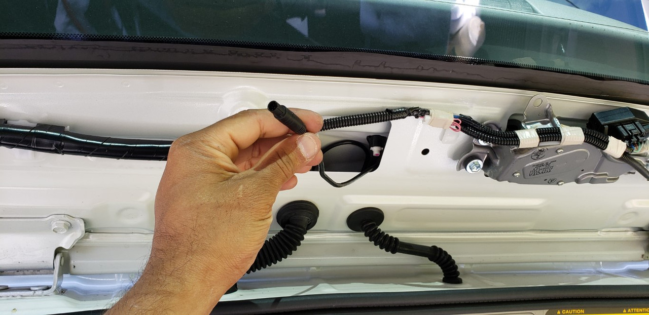

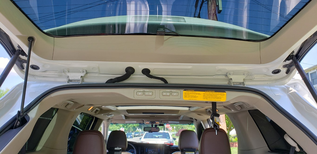

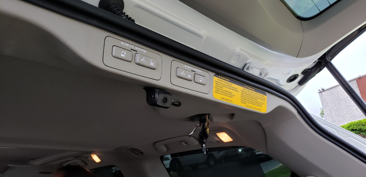

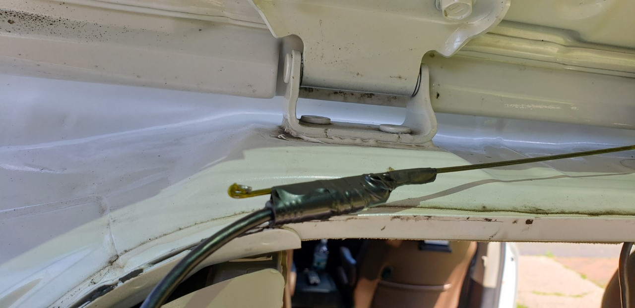

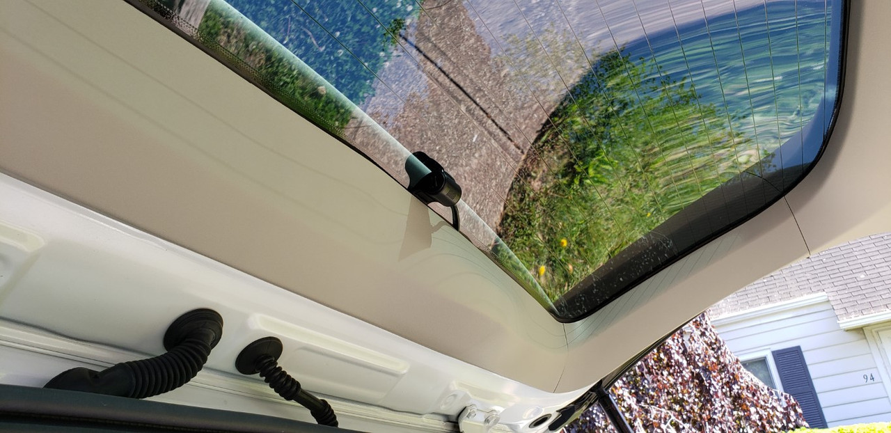

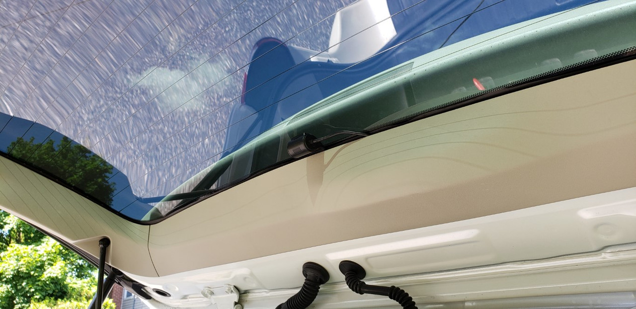

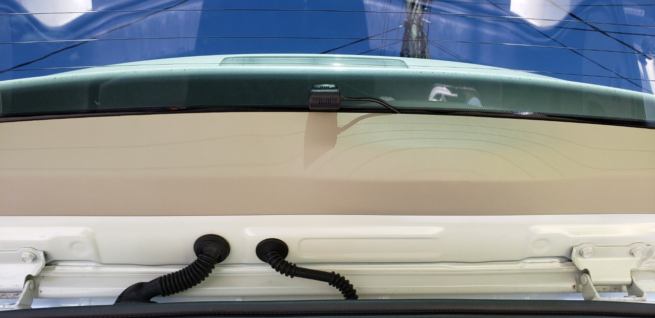

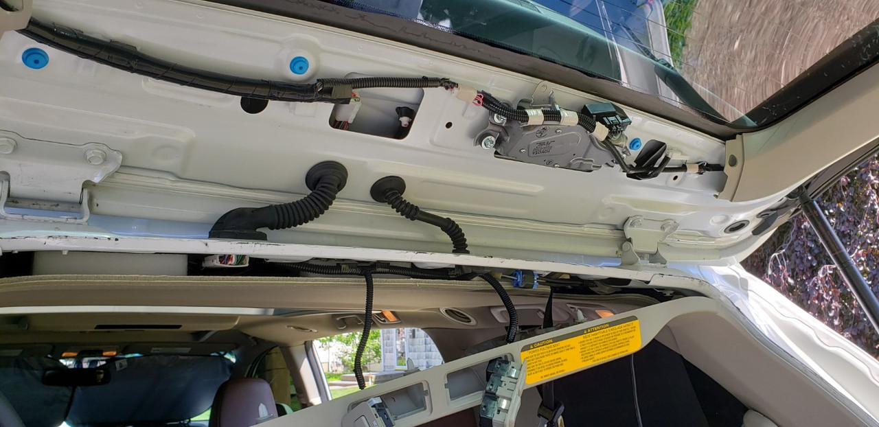

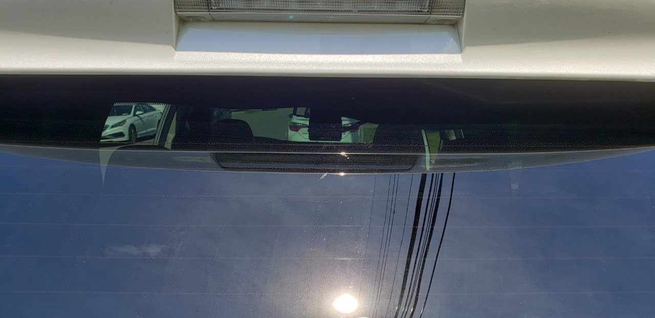

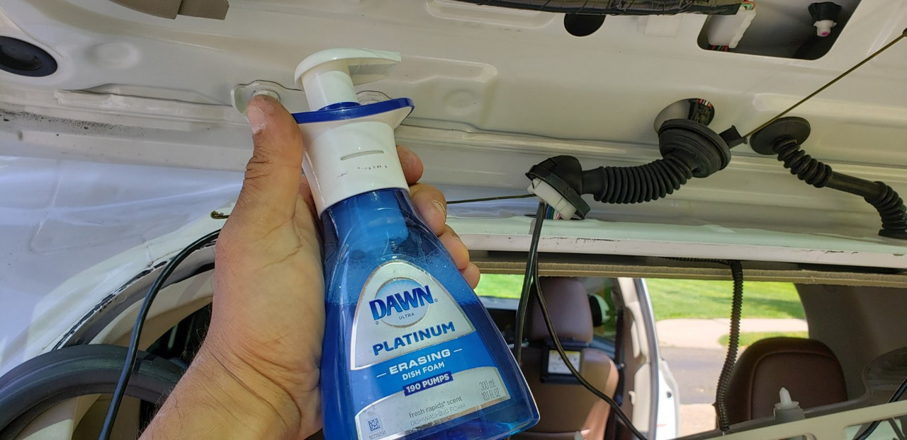

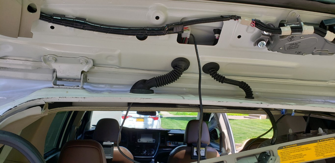

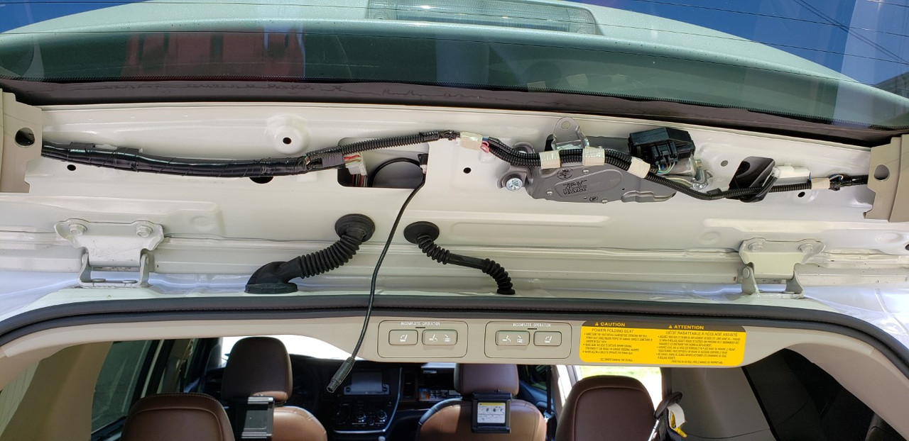

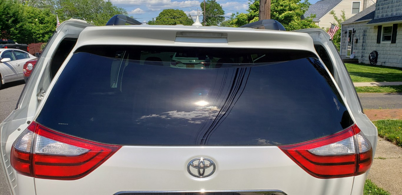

Anyways, here are some pix of my initial install with the rear camera mounted under the rear switch panel:

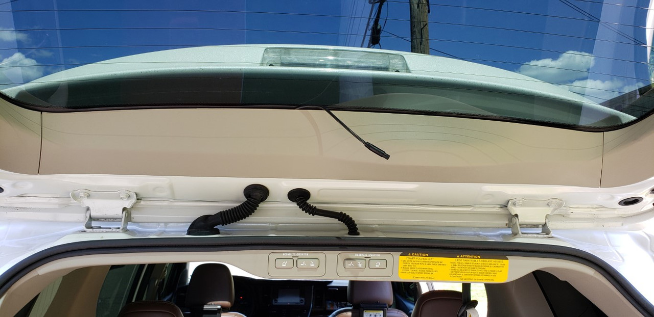

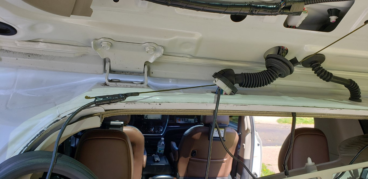

![siennadashcam-1.jpg](/forum/proxy.php?image=https%3A%2F%2Fi.postimg.cc%2FVLntjCtk%2Fsiennadashcam-1.jpg&hash=e0b2d10a7c08322eba4f5b146097c61e)
![siennadashcam-2.jpg](/forum/proxy.php?image=https%3A%2F%2Fi.postimg.cc%2FmDkZV06S%2Fsiennadashcam-2.jpg&hash=58a6032a3919e39c0290d8e509fa3759)
![siennadashcam-3.jpg](/forum/proxy.php?image=https%3A%2F%2Fi.postimg.cc%2FfknwzkWH%2Fsiennadashcam-3.jpg&hash=ec39829fc182b20cb59fc127d2c3af7c)
![siennadashcam-4.jpg](/forum/proxy.php?image=https%3A%2F%2Fi.postimg.cc%2Fc1KwLj4Y%2Fsiennadashcam-4.jpg&hash=f102570f8681c3d0f0054058c08fabf2)
![siennadashcam-5.jpg](/forum/proxy.php?image=https%3A%2F%2Fi.postimg.cc%2FDftsJg8N%2Fsiennadashcam-5.jpg&hash=7db199391e2d2a55f306819d7133a99e)
![siennadashcam-6.jpg](/forum/proxy.php?image=https%3A%2F%2Fi.postimg.cc%2FYSbq6p89%2Fsiennadashcam-6.jpg&hash=5ecd2e147b1d725cef655b8375b0c258)
