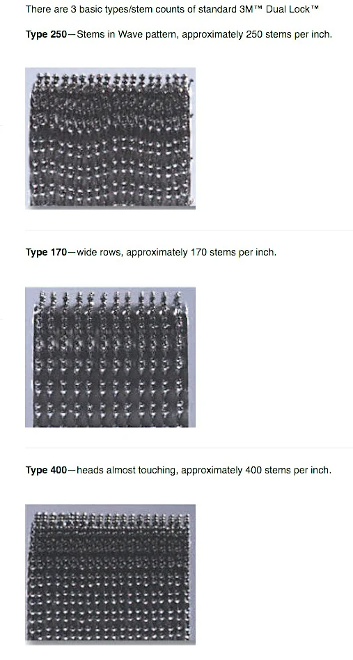

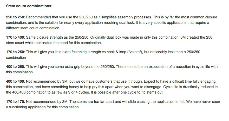

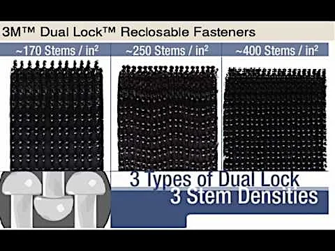

3M Dual Lock tape is marketed with different stalk counts per inch and in different patterns. They all work well and each has it's own properties and holding power. I believe some of their 106 Dual Lock products may offer different kinds of adhesives for application to different surfaces. The different types can be mixed and matched depending on your usage scenario, although newer versions have eliminated the need for this in some circumstances.
