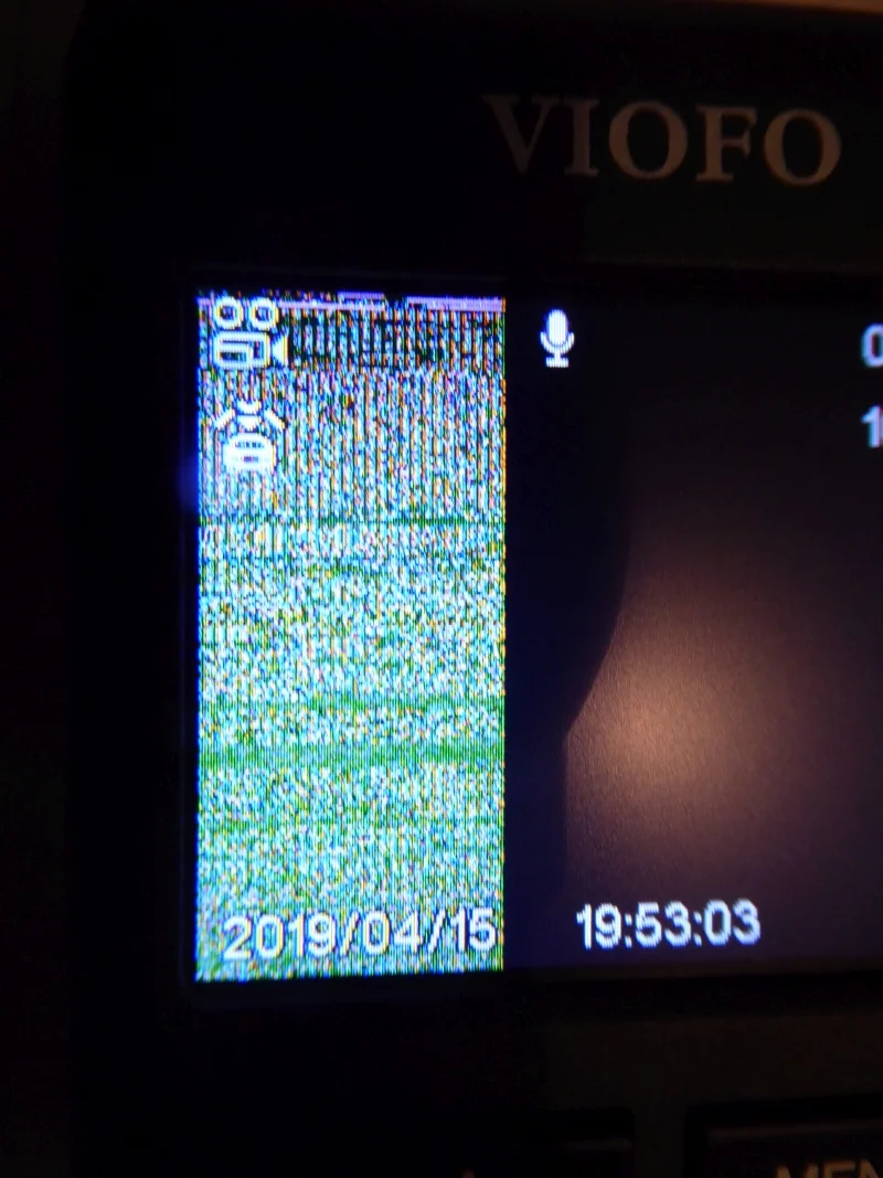

The dashcam is not working and has thrown up an icon not listed in the manual.Could this relate to a corrupt TF card?Unable to get into the menu to reset default values...record button constantly flashing!
Icon is below the 'movie camera'...could it be G sensor? Help please. Dashcam.webp
Remove your memory card and start up the camera with a USB wall charger (phone charger). Go into settings and manually default the cameras settings. This should bring the camera back. Might take a couple of tries. Once you get the camera working again, update to V4.0 as this was a bug fixed awhile back.
Phew!All good, after a few goes of trying to install v4.0 of the firmware,all of which failed for some reason [maybe duplicating Bin]I installed the modded version of v4.3,everything back as it should be.Many thanks.
I think that is the icon for forward collision avoidance and lane departure warning.
