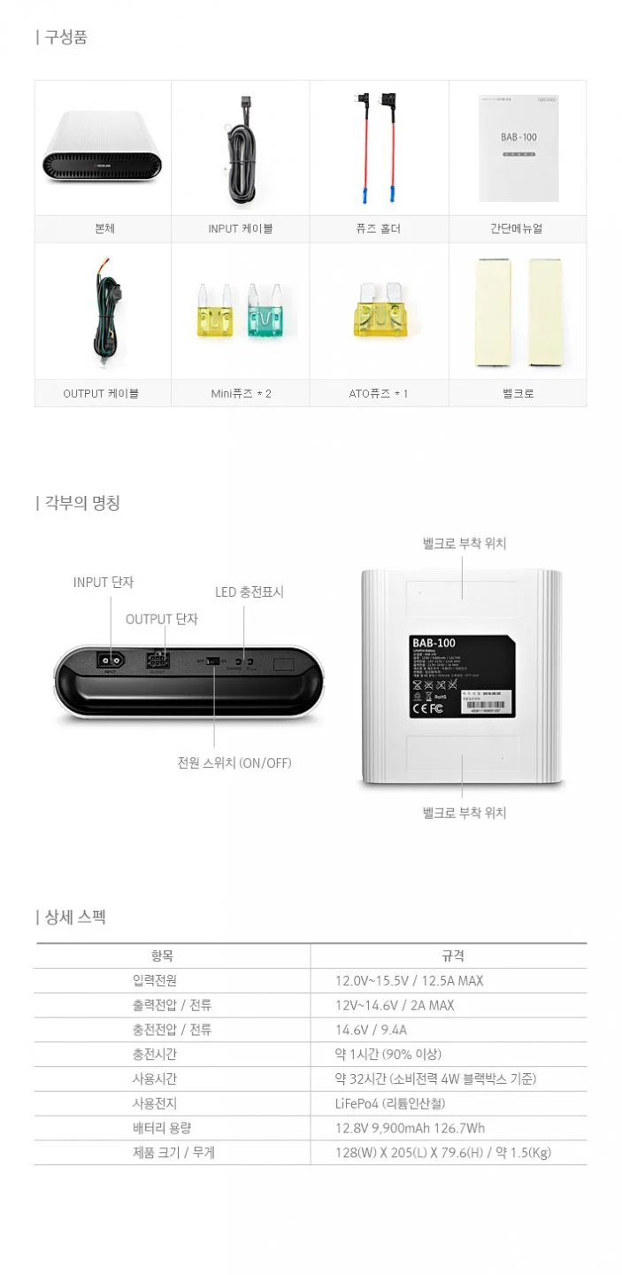

Thinkware Dash Cam External Battery Boost Couple your Thinkware Dash Cam with the latest external battery boost by Thinkware.
  • Single Channel of up to 43 hours (2.9Wh)
  • Dual Channel of up to 36 hours (3.5Wh)
  • Charging Time 1 hour 20 mins (Charges 90% in an hour)
  • Charging Voltage 14.6V / 9.4A
  • Battery Capacity 12.8V 9,900mAh 126.7Wh
Price in Korea around 300$

Looks like proprietary connectors so wouldn't be useful for most people and the price is extreme :eek: I don't see marketing success here even though I like the concept.
Charging time is really fast but I wonder at what temperature can the 9900mAH battery lasts 36 hours for a dual channel cam. But I guess not many people will treat the dashcam as a CCTV

Regarding the 12V plug on the output cable, the Thinkware hardwire cable will work on a lot of other Korean dashcams (e.g., BlackSys, Lukas, Blackvue DR750, FineVu, and more) meaning in their domestic market this battery pack would be compatible with a lot of other devices. That being said, it's easy enough to splice in a different hardwire kit on that output cable as long as you match the ACC/battery wires correctly. Should also be easy enough to switch it out to a 12V cigarette socket to work with dash cams like Vicovation or Blackvue DR650S, but I would be careful with this as not all dash cams will work in parking mode with that method.

Working in Korean domestic market doesn't mean it works with the marker here in North America. Not to mention they are compatible with most of the devices. As Sawmaster said proprietary connectors is not the way to go. You may have a portion of market share but still isn't compatible with a lot other brands. It might be easy for some of us to splice wires and make it work with our dashcams but not all of us are comfortable with wiring. Why not just simply leave it as open 3 (or 2) wire connection and have it compatible with all of the dashcams? I also don't like to idea of having the battery charged with the cigarette socket. What's the point of having a battery that has quick charge capability but charge it with a slower current input?

Looks like these just come with the 3 open wire connection as do the Cellinks. It's up to the installer to connect the hardwire kit to the output of the battery pack
While it's true cigarette socket is a compromised charging method, about 30% of Cellink users go with this method as they're not comfortable hardwiring or were scared by their dealer to avoid touching the fuse box/hardwiring whatsoever.

The iVOLT looks intriguing since it can charge faster (hardwired Cellink = 7A) and has ~60% greater capacity than the Cellink. Always good to have options and competition in the market!

Had a closer look at the specs and its a bit concerning that they include fuse taps with 20A fuses. The iVolt has a max input current of 12.6A, which is a whopper to put on top of an existing (in-use) circuit. I don't see a current limiting switch either like the Cellink.
Looking at the beefy 14AWG wire used for the Constant B+ and Ground, it looks like the iVolt needs be hardwired directly to the car battery and the ACC wire can be fuse tapped, but I dont see a fuse included on the B+ wire....
