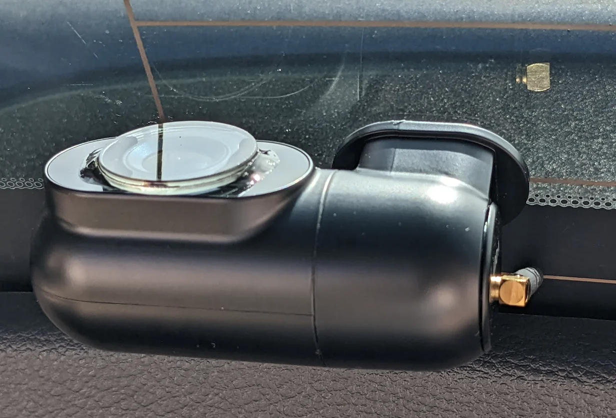

My DIY CPL for the A139 rear camera has not worked out very well because I'm getting extensive haze or fogging around the CPL. There is a small air gap - the UV cement is not a complete ring - but perhaps it needs more air?I simply re-used an old dashcam CPL (from my SG9665GC, but any circular CPL could be used). It's held in place by a couple of dabs of UV glue. This was a bit tricky to install within the car since the camera is not removable from its mount.
If I like the result after a few weeks of testing I'll dismount the camera and re-affix the CPL with a tidier glue edge, then re-mount the camera on the rear screen.

I removed the CPL yesterday and found that the fogging is trapped between the two layers of the CPL, so it seems to be a CPL failure rather than a ventilation issue.My DIY CPL for the A139 rear camera has not worked out very well because I'm getting extensive haze or fogging around the CPL. There is a small air gap - the UV cement is not a complete ring - but perhaps it needs more air?
Why does the CPL have two layers?I removed the CPL yesterday and found that the fogging is trapped between the two layers of the CPL, so it seems to be a CPL failure rather than a ventilation issue.
I don't know why it has two layers, but it's not a protective layer for shipping. The Viofo CPL has similar construction.Why does the CPL have two layers?

Edit: Looking at your image, maybe the UV cement has split the two layers of glass? But I don't know why there are two layers...
