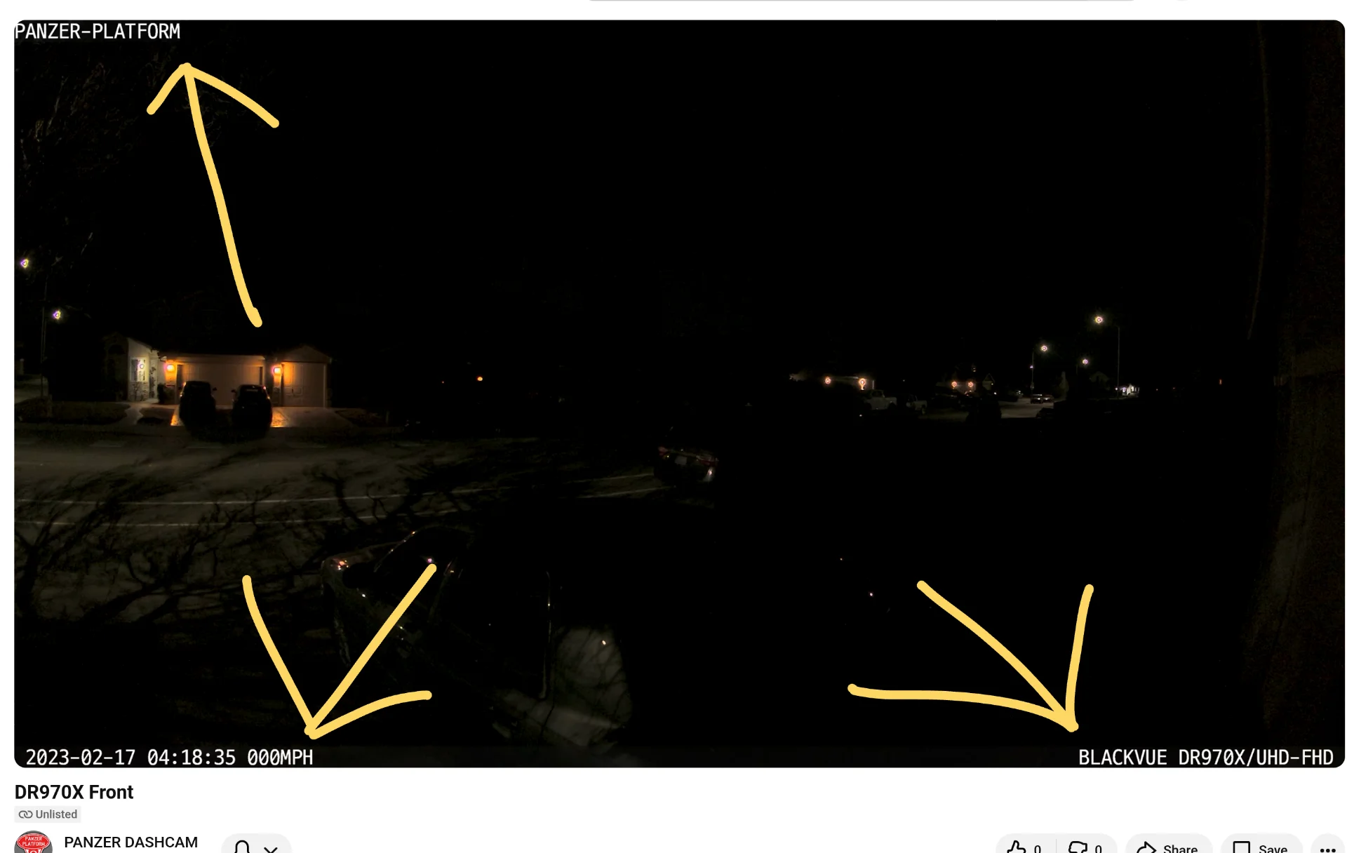

Look at the last second of the last recorded file, take note of the voltage display on the text stamp.
