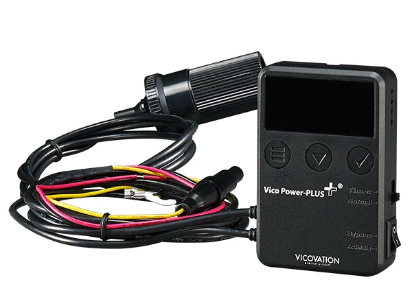

There is wide range of universal hardwire kits.
Vico-Power PLUS is probably the most advanced one. Features include Low Voltage Protection , Timer Protection, Over Temperature Protection, Over Current/Surge Current Protection.
Another example is Black Vue Power Magic Pro. Features include Low Voltage Protection and Timer Protection
In my Honda CR-V I installed Blac Vue Power Magic Pro and I'm going to replace it with Viofo Hardwire Kit. One of the reasons (and disadvantage of Power Magic) is switching off power after short voltage drop.
It's happening during this scenario: cars stops, the engine is switched off and power magic switch to the parking mode. Then, during opening trunk using automatic trunk opening voltage drops (for very short period) and Power Magic is switching parking mode off... Short voltage drop due to electric trunk opening is one of example, another equipment, operating while engine is switch off can cause the same problem. It can be automatic parking brake etc.
this model has been deleted so anyone looking for one should grab it soon
I tried with a couple of suppliers here, looks like stock is over.
