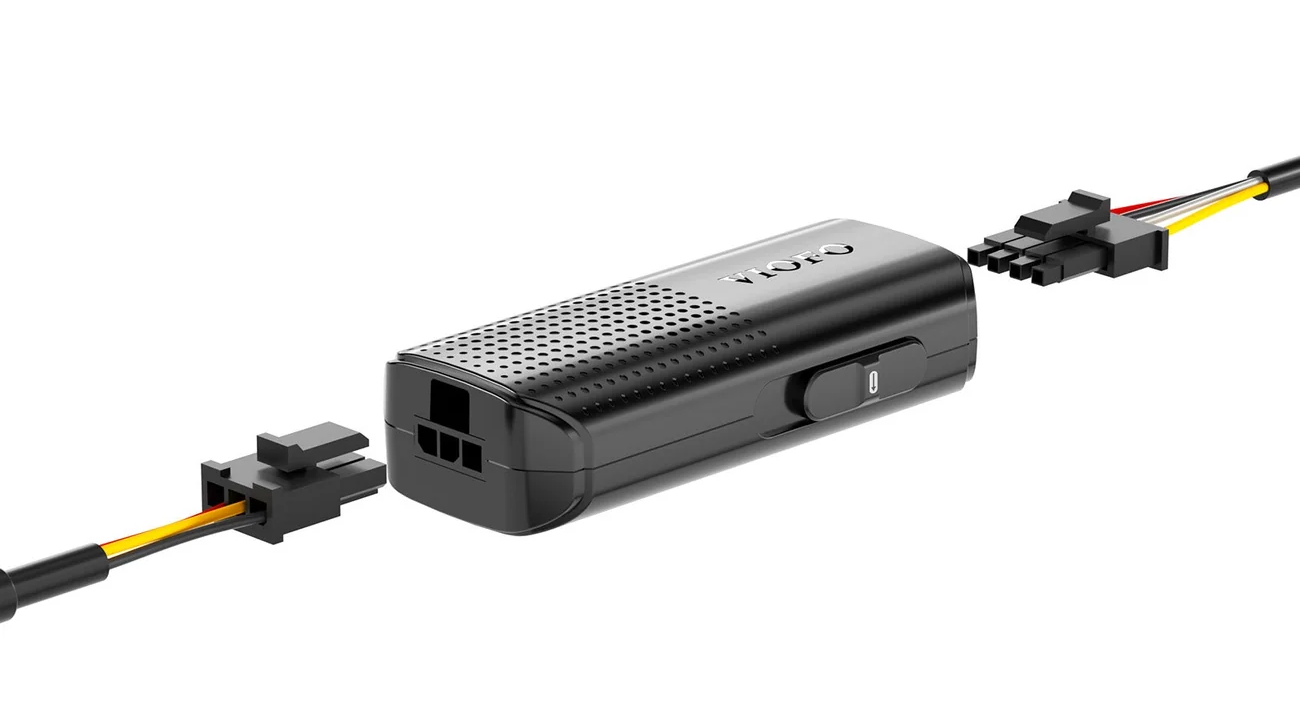

HK6 will prevent full capacity usage because lowest cut-off voltage is 11.8V.

Since HK6 has a modular design (two clips on each end) it can easily be replaced with VIOFO’s “special” HK6 that has the 12.4V cut-off setting modified to “no cut-off”.
This means you can drain full capacity from BP100.
You can request a special no cut-off HK6 by SUBMIT A TICKET
