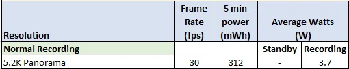

In collision detection mode, the sensor is off and the E360 relies on the g-sensor to wake it up. This is the lowest power consumption option, and thus the lowest heat generated.
In motion detection mode, the sensor is on and the E360 is checking for movement all the time but not recording. This consumes as much power as when the camera is in normal recording mode.
You can see my power consumption test results here: https://dashcamtalk.com/forum/threads/review-vantrue-e360-ace-lt01-360°-dashcam-4g-lte-module.52407/post-633588
Thanks for sharing this! I definitely need to change my parking mode to Collision Detection and then adjust it to Power Savings.
Just be aware that the E360 takes 17 seconds to start recording after the collision is detected using the power saving mode. You get loads of battery life, but it might not record quick enough depending on the situation.
Like you said, 17 seconds. At that length of time, most people who bump your vehicle are long gone by then. I had previously read your review that you posted a link to but it makes much more sense now that I have the E360. I have it hardwired to my truck's battery. Mainly I am looking for parking mode while I am overnight at hotel. Do you have a conversion from your 96 Wh battery to a regular 12V vehicle battery? I can then equate your 96Wh battery runtimes to my 12V truck battery that I have set the low voltage cut off at 12V? Thanks for researching this and sharing it with everyone. Also, I typically have the cabin camera off with just the front and rear camera activated. Does the cabin and rear camera use about the same electricity?
