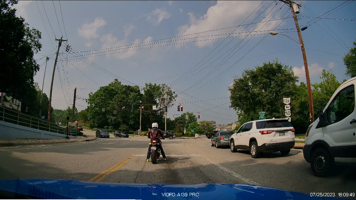

Hey guys,
I wired up the A139 this weekend (probably purchased in March or April), and when I checked the video yesterday, the image was shockingly blurry to the point that no license plates are readable. Here is an example of when I was stopped at a light at 5PM on a sunny evening:
From reading other posts, I know the first order of business is to update to the latest firmware and check my bitrate setting to see if it's max or not, but should I check any other settings? I am currently running one channel with the intention of adding in the rear camera, and using the Viofo hardwire kit direct to my car battery. It's currently set at 4K max settings on the Sandisk High Endurance 256gb card.
One other thing I considered was that this is screenshot of the video playback on my phone. Could the video on phones be super compressed and this is a result of that, as opposed to viewing it on a computer?
Thanks for any help
Possible. First thing is to view the actual video as it is on the memory card. That way you eliminate potential outside causes.

Here's the screenshot from the raw video file paused in VLC and using Snipping Tool for the image. It's a bit better, but the license plates are still not very clear. I'm about to reformat the card and upload the latest firmware, so I'll report back on my findings next time I'm out in the car
Rather than pausing and 'snipping' take a snapshot from within VLC. Again, we're eliminating as many outside influences as we can. Likewise, if you have a different video player (I assume you do) do the same with it and compare the results. The whole purpose of this is to determine if it's the camera or some other cause.

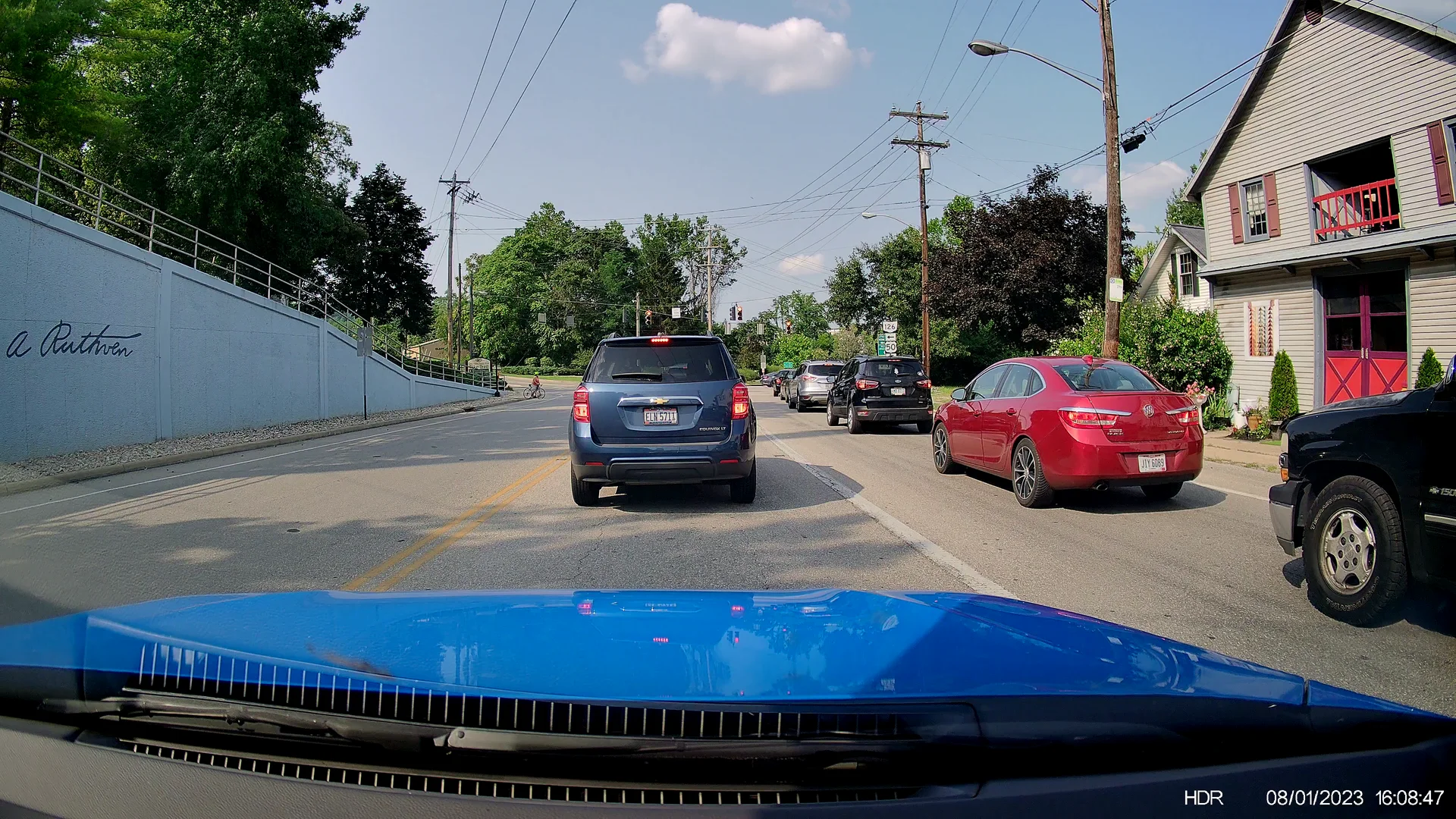

I went kayaking this evening and was at the same intersection at around the same time and conditions, so it was almost a perfect comparison. After following the suggestions of everyone, upgrading the firmware and making sure the settings were maxed, the results were MUCH better, even with it being slightly down-scaled because of the two channel recording. I adjusted the front camera down a bit, but not quite 50/50. There's a ton of dash when it's 50/50 and I'm afraid of potentially missing info at the top of the screen, but this is still better than before. No CPL on either, haven't played with that yet.
Here are the front and rear images with the snapshot taken from VLC itself:
I have a dual monitor setup, but both are a few years old and I highly doubt they're 4K monitors. Probably just 1080.
If you have a look at the display properties on your computer's system it will tell you the resolution of your two monitors along with other useful info. If you're not quite sure how to do that a simple Google search will explain what to do depending on which OS you've got.
