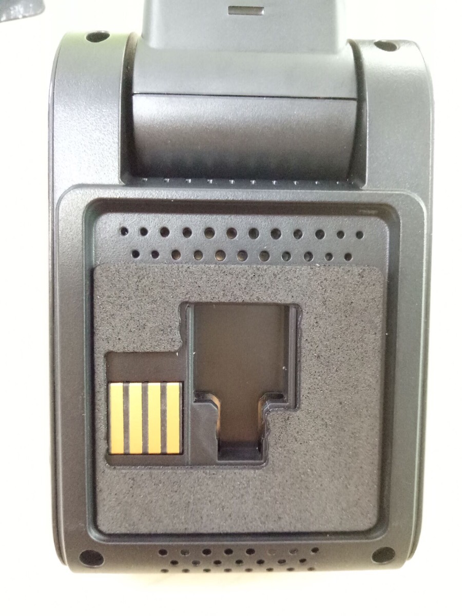

I've come up with an easy solution to the rocking GPS mount fix. Just use a small zip tie and wedge into the gap on the right side of the mount and dash cam. My method using a small zip tie as a wedge removes all rocking. Watch my video to see how effective it is.
The 2nd batch of A119S V2 shipping next week will contain custom die cut 0.5mm EVA foam pads. All you need to do is add one piece to the camera side and the mount will remain snug. (Vibration/Wobble free)
I should have some spare EVA pads to send OCD Tronic customers as needed soon as well. (And can create an accessory listing for others)
