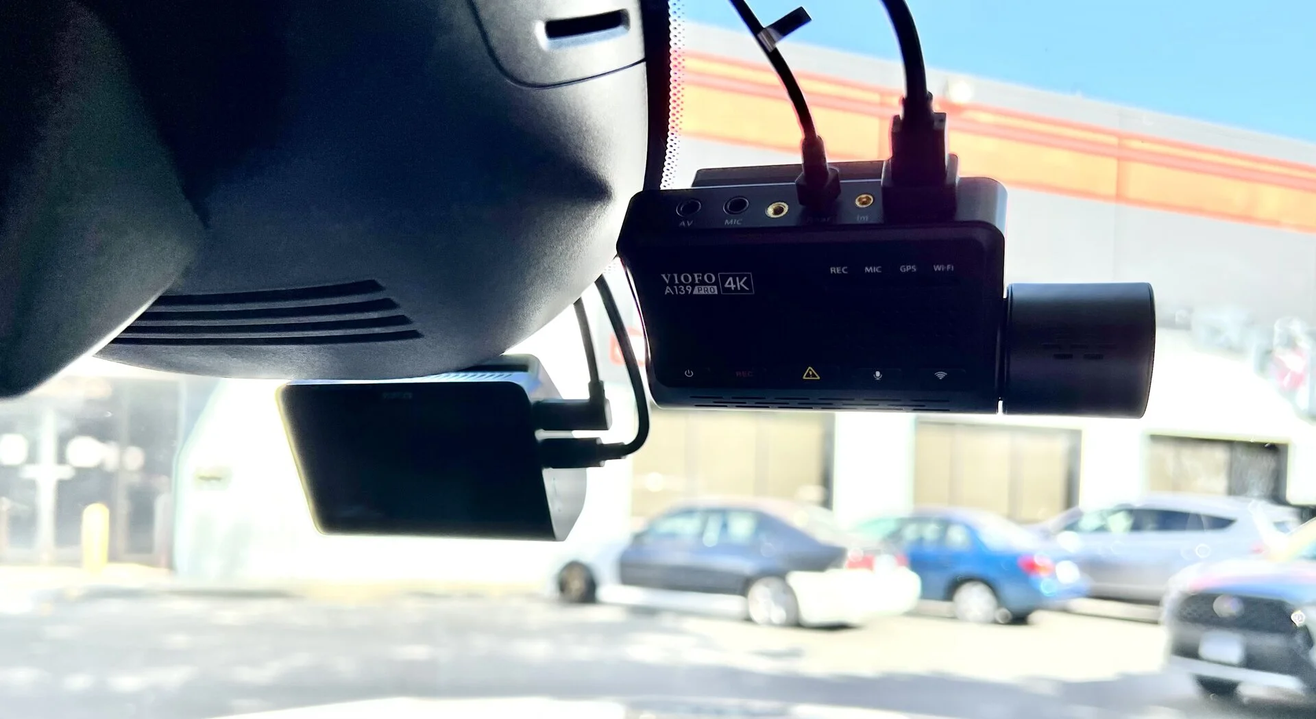

The Setup:

I was heavily inspired by the style of @Vortex Radar and his comparison videos and magnification of license plates. I tried my best to synchronize both clips and to capture the best still frame from each camera. Each license plate you see in each frozen frame of the video is under 400% magnification. In some low-light scenarios, you will see the differences between 70mai and Viofo's DOL implementation as both do not use Clear HDR.
You may find the 70mai video footage to be not as smooth as the Viofo as the 70mai A810 records in 25fps vs the Viofo A139 Pro at 30fps.
