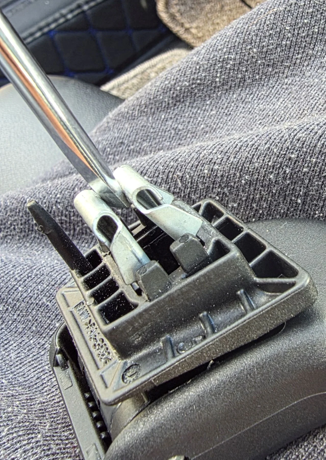

A couple of teas later we decided to open the A pillar trim by prying off the airbag plastic tab, thin blade will do this easily, undo the Torx screw and a firm pull will pop of the top of the trim, if you want to fully remove it you need to wiggle it towards and away from the windscreen to get the two prongs out. This allowed us to run a finger along the headliner, door seal and B pillar. We then removed the front grab handle, this bit was by far the hardest, most time consuming part. With the help of the headliner removal PDF and YouTube we finally managed to remove the handle. Use a trim removal tool to pry off the plastic covers, then a flat blade screwdriver to lever out the clips. Insert screwdriver in green highlighted area and lever the screwdriver down then do the same with the red highlight levering the screwdriver up. The top part is quite well hidden.
When re-installing the handle if it feels loose and the covers are really hard to get back in, pry apart the clips with a screwdriver and it should go back in good and tight.

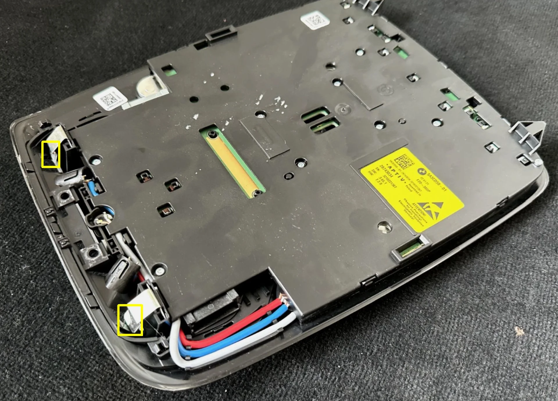

We also removed the small square plastic bit (what is this called and for?) only held in by one Torx screw, near the rear grab handle. This allowed us enough play to get a hand up into the roof (and crucially not crease the roof lining -small hand help here) to try and grab the push rods. Please note the airbag is up here so be careful not to mess with that.

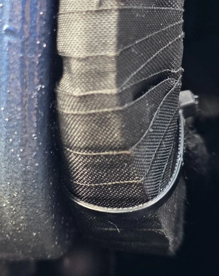

After several attempts successfully grab the push rod and pull it out. Tape the cable to the other end and gently pull the rods though, guide the cable up to the A pillar. When pulling the rod back out try and use the rod to keep the cable away from the airbag. Use the trim removal tool to push the cable under the front of the headliner up to the dashcam and plug the cable into the unit. This was the bit I wasn’t looking forward to as it seems to be on really tight, however the trim tool made this really easy and you would never know it had been disturbed.

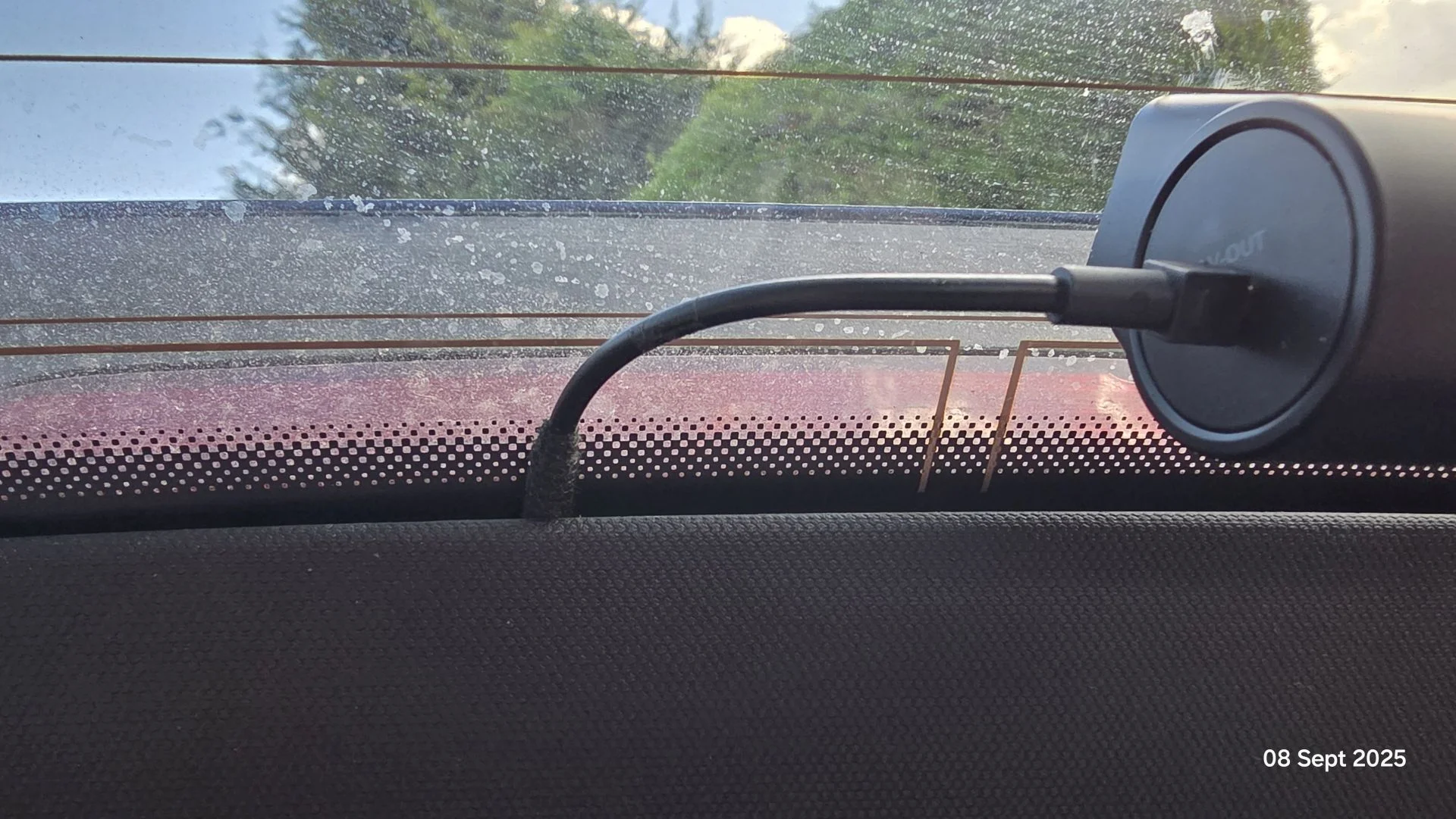

The glass hatch boot trim will just pop off with a good pull. I went with small cable ties to secure the cable to the cable run on the boot hinge (don’t put the ties around the whole hinge as it will interfere with re-installing the cover) securing the cable on the inside of the cable run.
I decided to coil the excess and store it behind the boot trim, I thought this would be better than in the roof liner, my theory being less to interfere with the hinge, and less to rattle in the roof not that I think that would be much of an issue.
