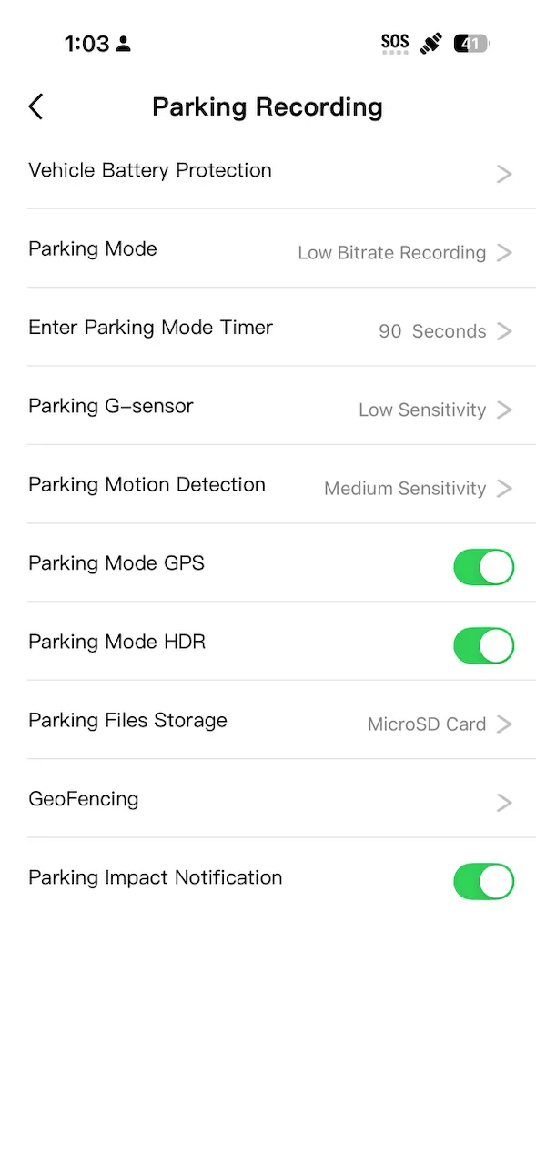

I set the dash cam to disable parking mode when parked at home using the GPS feature, but I don't think it's working because the battery keeps dying. I'm worried that this is damaging the battery life.

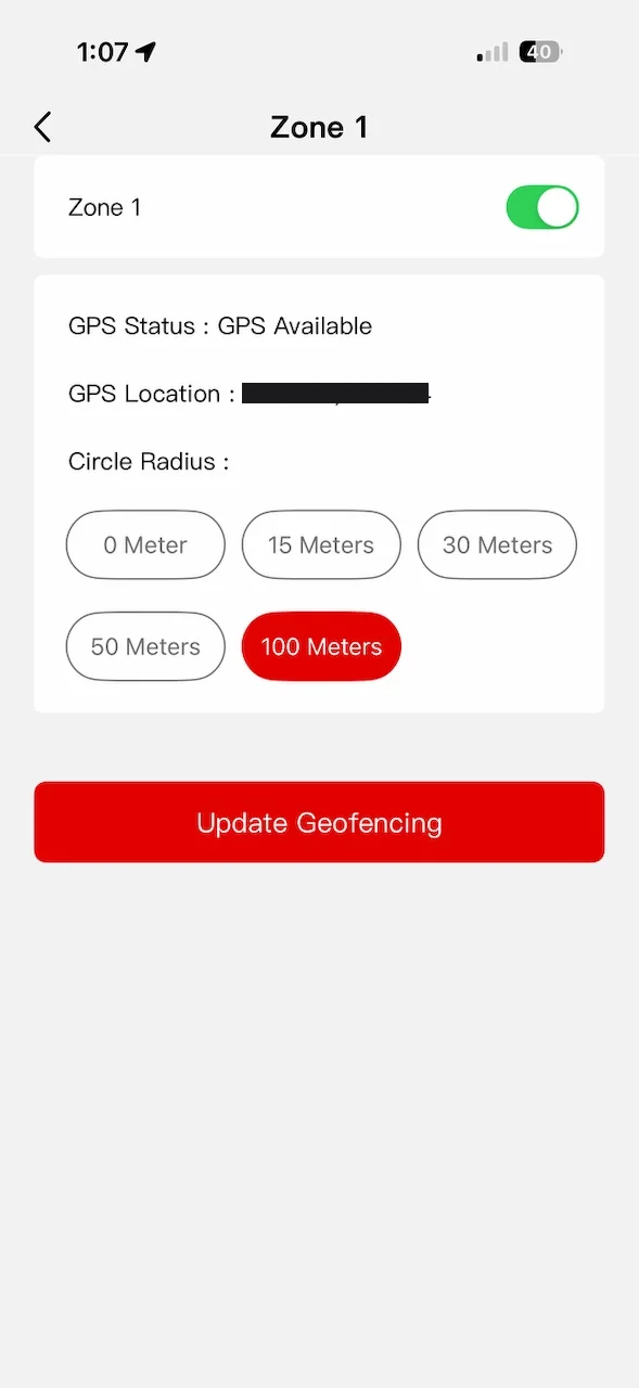

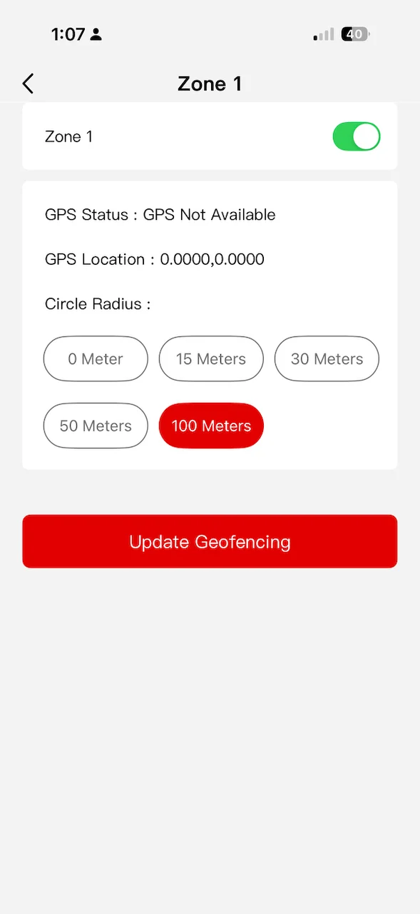

The dash cam says "GPS Available" when the car is parked in my driveway and I set it to 100 meters. However, the it says "GPS Not Available" when the car is parked in my single home garage. I just recreated the GPS zone again in my driveway, but still get "GPS Not Available" when parked in my garage.

If GPS is not available at the location you're parking your vehicle, the GPS based Zone feature isn't going to be helpful. You can step back to the older [pre GPS Zone feature] steps of either using the menu/power button to power down the dash camera or if you have the BTR200 Bluetooth button, you can assign one of the buttons to the "Power Off" action.
The menu/power button option would be: 1 click of power/menu button to turn on the screen [if the screen is off], then a super long press-and-hold of that button. The settings menu will appear [still keep holding] and then the dash camera will power off.

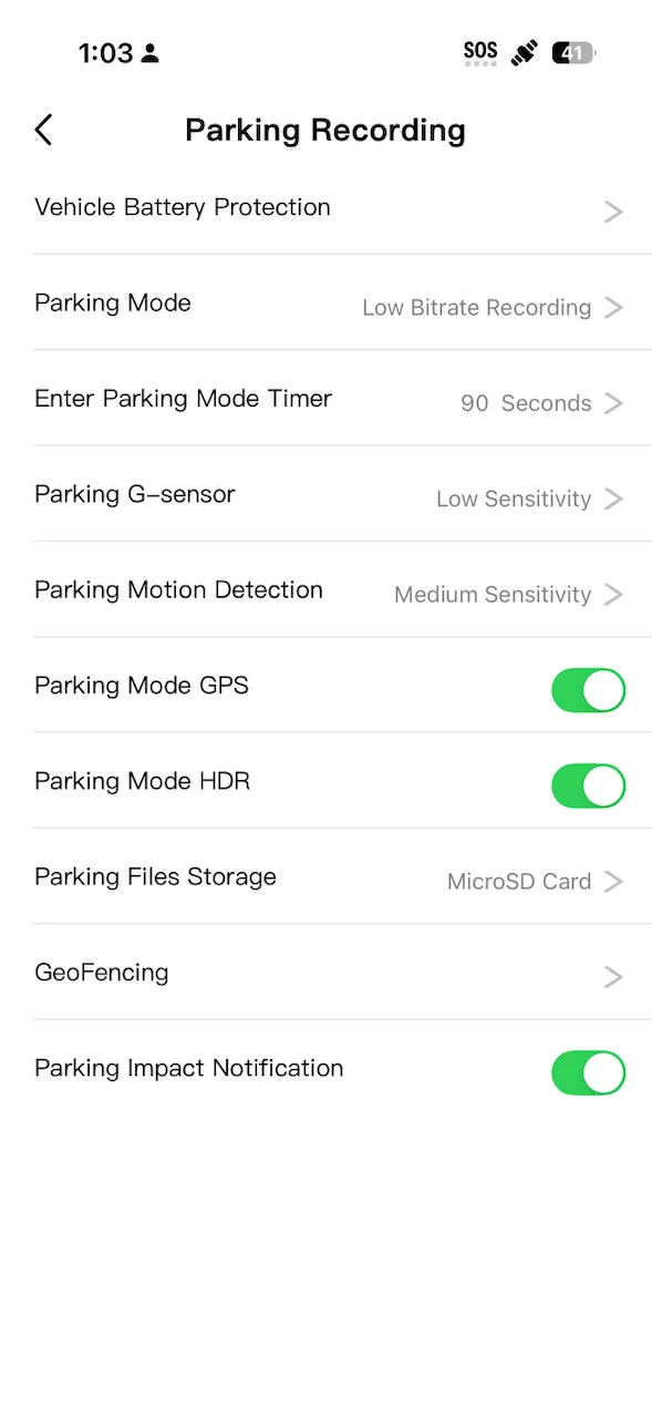

The "Parking Mode GPS" enabled or disabled is irrelevant to the geofencing function.
I recommend disabling it to minimize parking power consumption.
Ensure that GPS is enabled for Driving Mode.
Park the car outside of your garage with the engine running and dashcam is in normal recording mode.
If you just started the engine, you may need to wait a minute or two to acquire a GPS signal and then go to settings to set up a geofence.
A 100-meter radius is not necessary—a smaller value will suffice.

Are the GPS coordinates and/or speed displayed in the status bar? (assuming it is enabled)
If not, the GPS module is defective.
I recently encountered this exact same issue with my A229 Plus.
I replaced the GPS module—and now everything is working properly.
