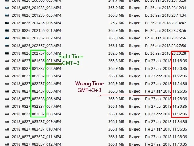

Also from Snip2, it was noted that unlike the analyzed file (in GMT), the previous older files on the PC, such as file 2018_0822_205728_071.MP4, show the "Date" column to read 7 hours earlier than the "Date Modified" column. These files were recorded with Time Zone set for Pacific Daylight Time (GMT - 7 hours). I doubled checked this by recording and analyzing a new file with my Time Zone setting (not documented here). So for files using a Time Zone setting:
- The "Date" column for my time zone (Pacific Daylight Time, GMT-7) is seven hours earlier than the end Date/time of the original file recording in local time , but is the same as the video end Date/time when recording in the GMT (GMT 0) Time Zone. This is likely a Firmware bug since it makes no sense to me to display such a time. Presently, the Date/time displayed in the "Date" column is equal to the original video end GMT Date/time plus twice the Time Zone offset setting. @Minuel, this might be the problem you are experiencing.

@viofo, there does appear to be a problem with the "Date" data as viewed on Windows 10 File Explorer when a Time Zone other than GMT 0 is being used. Credits to
@Minuel and
@DAP for recognizing and insisting that there was a problem here. I only looked at the "Date Created" and "Date Modified" data in my previous posts so I missed the problem with the "Date" data.
