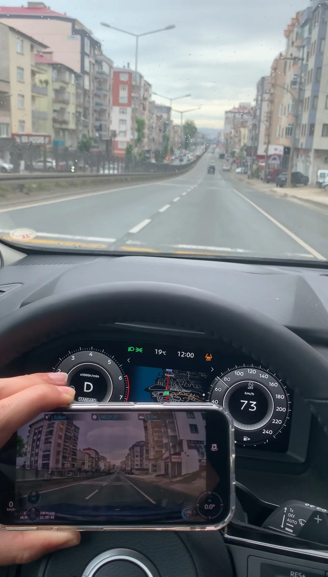

Is anyone else experiencing an issue where the DDPAI Z90 Master shows 0 km/h while driving? Has there been any update or fix?
Thanks.

I have already tried the following:
  1. My device is a DDPAI Z90 Master and it has GPS functionality.
  2. In the photo I sent, the altitude is approximately 5 meters above sea level, and I had already been driving for about 25 minutes when the photo was taken.
  3. I even removed the camera from the windshield and held it outside the vehicle to test GPS reception.
  4. I restarted the device.
  5. I reset the device to factory settings.
Despite all these steps, the GPS still does not acquire a signal properly and the speed remains at 0 km/h while driving.
Could you please confirm whether this is a known issue with the latest firmware version? If so, is there a firmware update planned to address it?

If possible, please provide the picture showing the speed remaining at 0 km/h while driving, as this may help the support team further diagnose the problem.
