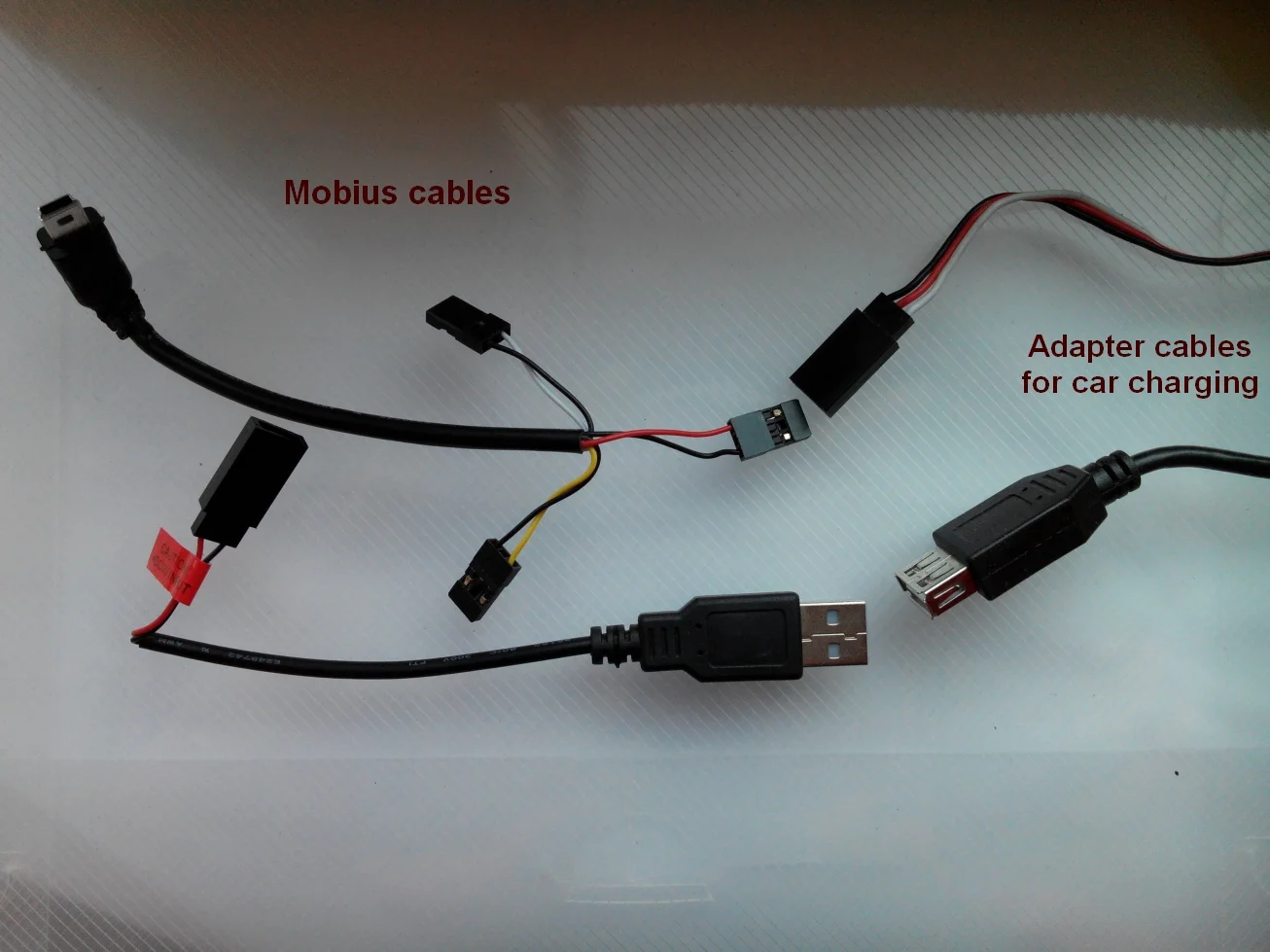

This is what the cable looks like. There is audio out as well as video but I've never attempted to use it.
It would be "clunky" to operate but then again the Mobius was designed for people (us "enthusiasts") who like to tinker. Speaking of clunky, only people like us would tolerate the firmware update procedures, for example.
The Mobius is not a typical "consumer" product and so such a cable really isn't intended for attractiveness. I think the Mobius is finding its way into other uses than RC or dash cams. For example, I have been experimenting with it for wildlife observation as it lends itself to easy concealment and even remote operation. (on - off via long length bus powered USB cable)

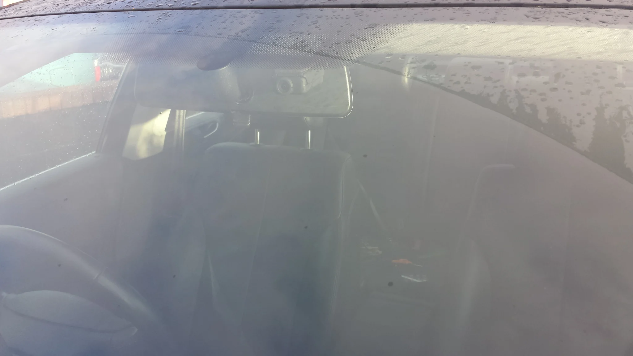

I have made DIY magnetic bracket for Mobius, will post full step by step project soon. Just want to show how it looks installed behind rerview mirror. In my car there is a limited space between mirror and windshield so even using L-shape plug I struggled to mount into the place I wanted ( as close to the mirror bracked and as up as can for discrete look ). I succeeded but had to do some extra DIY to the L-shape plug.

Good pictures because of rain. I can see the wipers cleaned area and propose better positions.
It is not important to hide a camera from your eyes but from stranger eyes. I saw this at most of the forum users. Also in the red position you can see the LED if you want.
