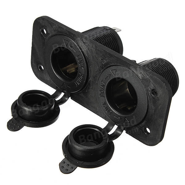

You could allso use 2 of this dual sockets.
