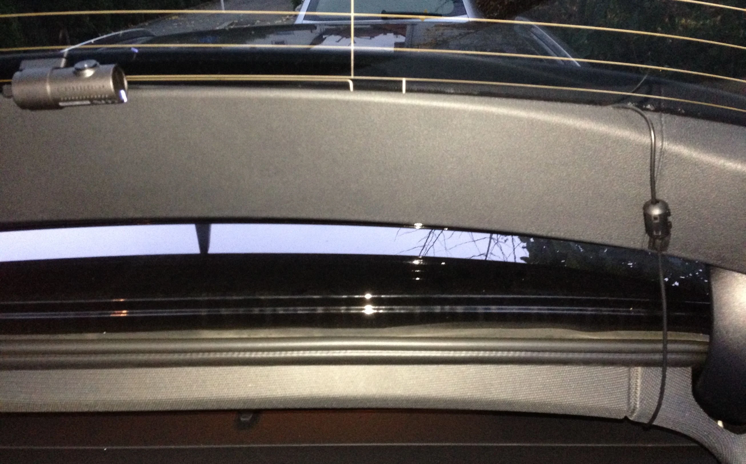

with 5 ferrits (total cost 8€) it looks like the problem is gone.
at the pictures you see a quick and dirty solution 🙂
