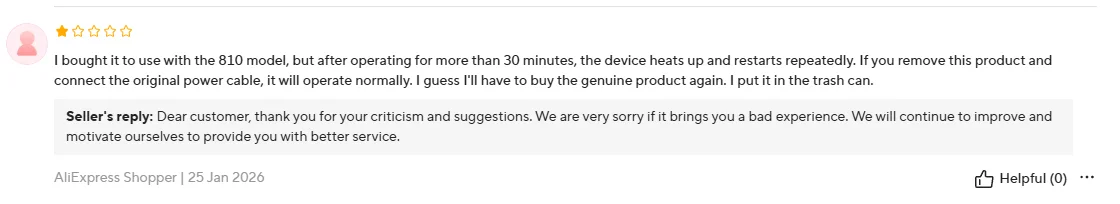

This is the 2-nd power line used , and i see in the comment section someone told, it is working just fine with 810s 🙂 i guess not for me 🙂)))

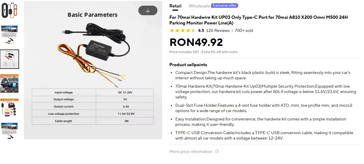

Yes i am inclined to think it is a power issue, but i would have thought the UP03 HW kit was just fine for that.
I have a 2020 BMW G20. The issue is that the original 70mai power kit only provides 5V / 2.0A output, which might not be sufficient for the A810S under load.

I was just on 70mais own page, but for A810S it do not list a particular HW kit, and under accessories it have 3 hard wire kits, the one you have, the 4G one i have and then the one for OBD port connection.
but under the hard wire kits i can not click any of them to maybe see what models they support.

I'm sure the fuse and the fuse box are not the issue here. I suspect the power module might be overheating and causing the device to reboot.
