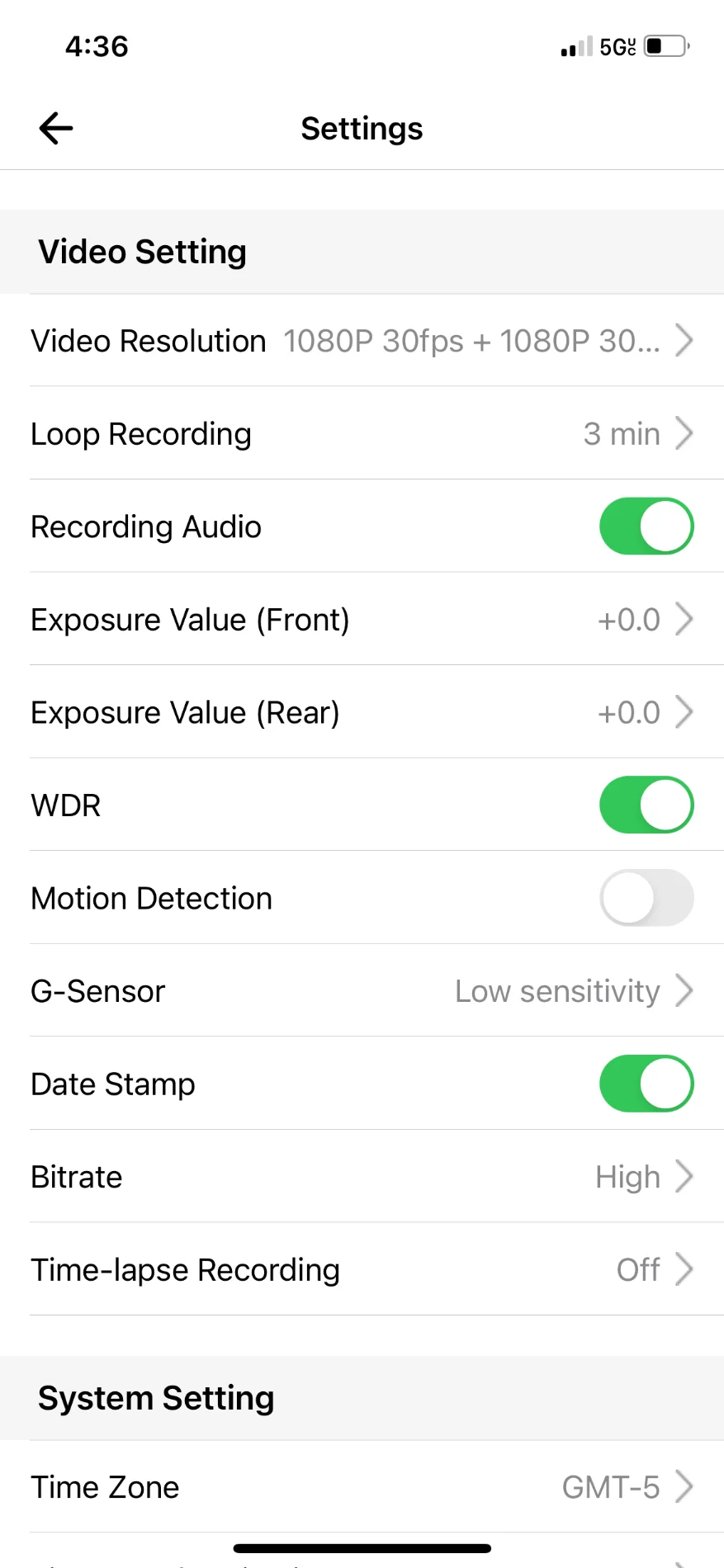

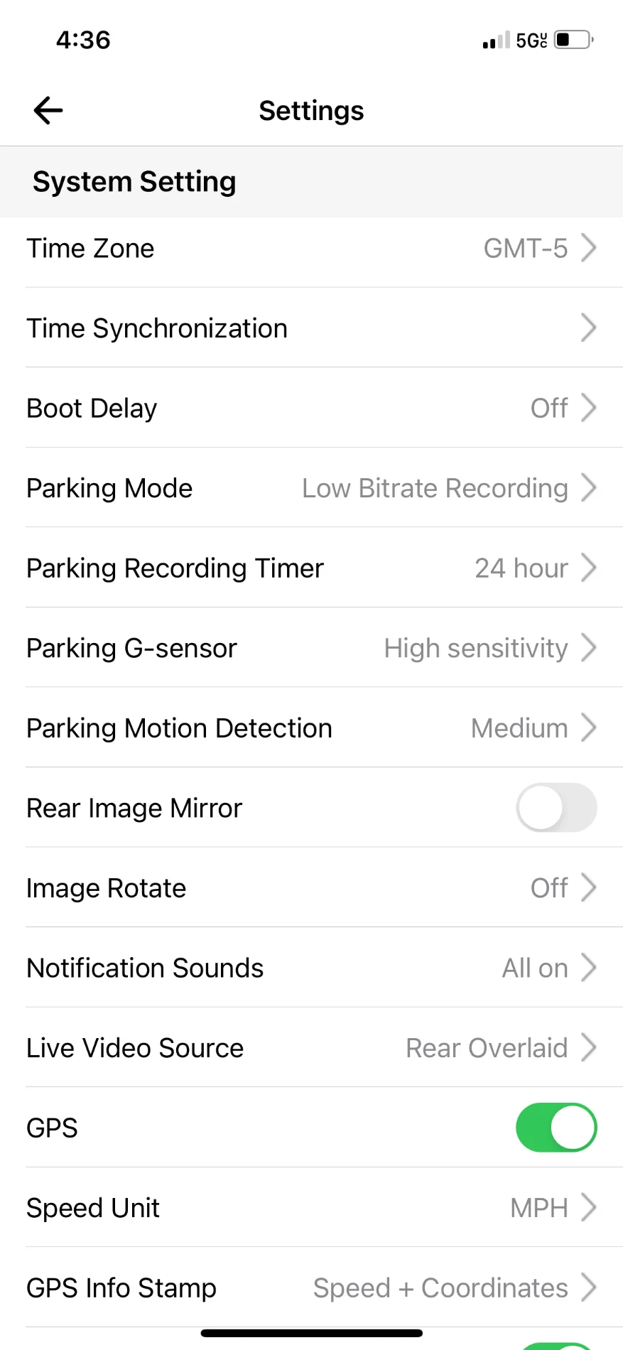

"Parking Recording Timer" must be new. That wasn't a setting on the previous firmware that I had. It's currently set at 24 hour though.
Attached pics of settings. Frequenzy is set for 60hz
There is a 90 second delay from when the hardwire kit senses voltage below the cutoff and when it actually powers off the camera.
