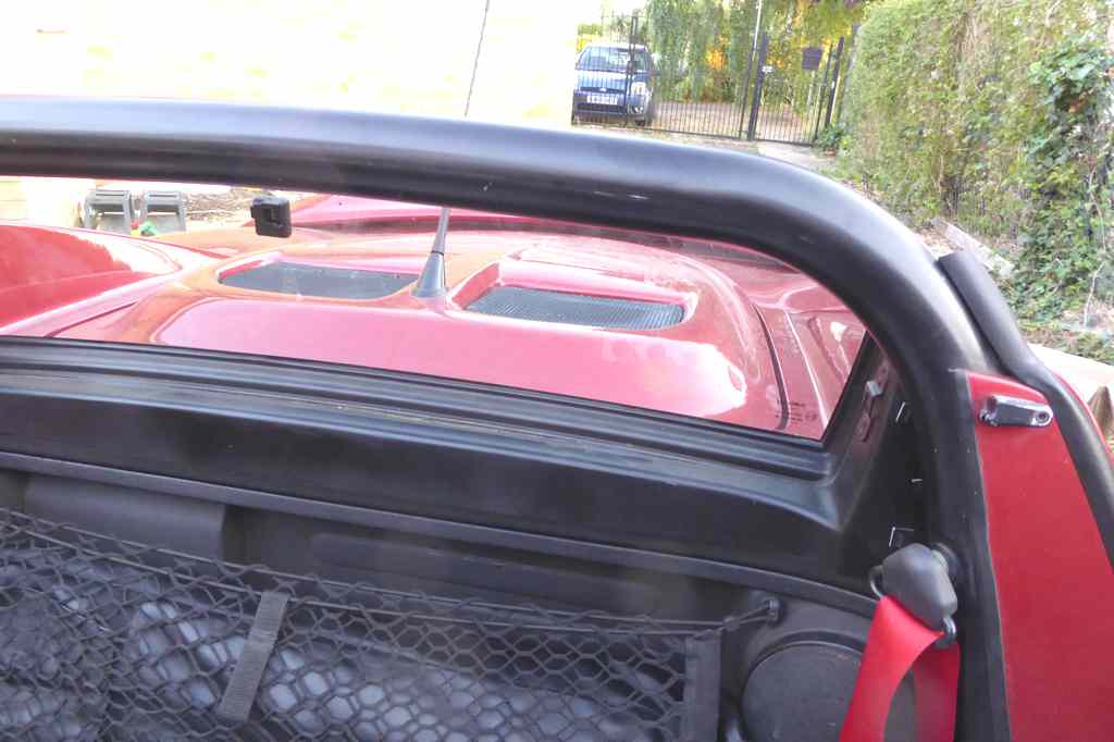

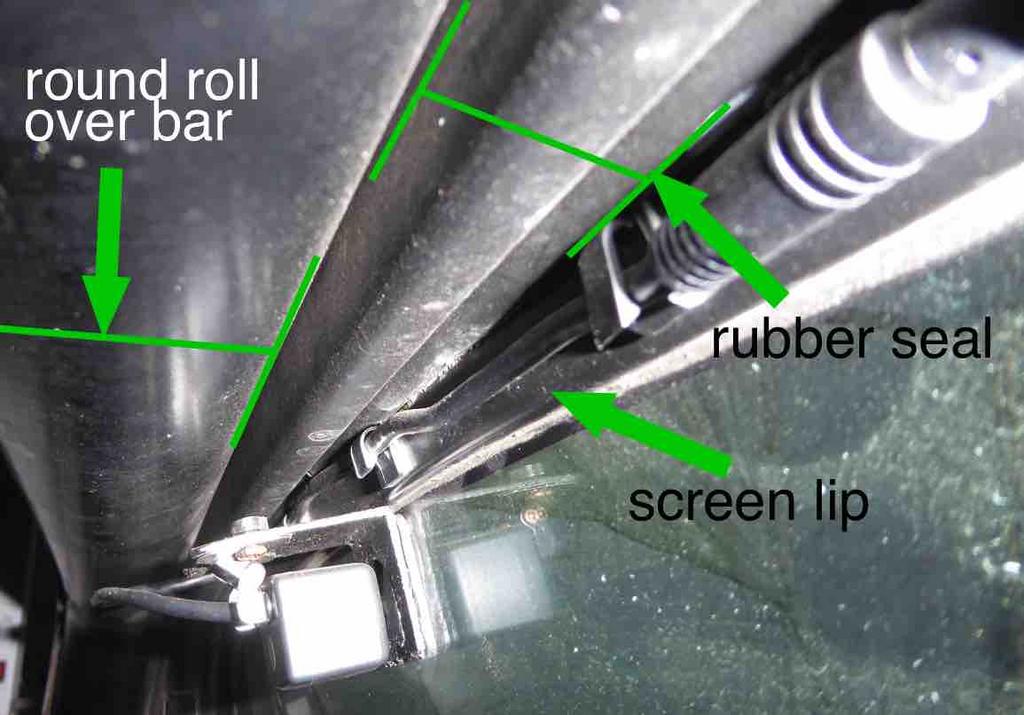

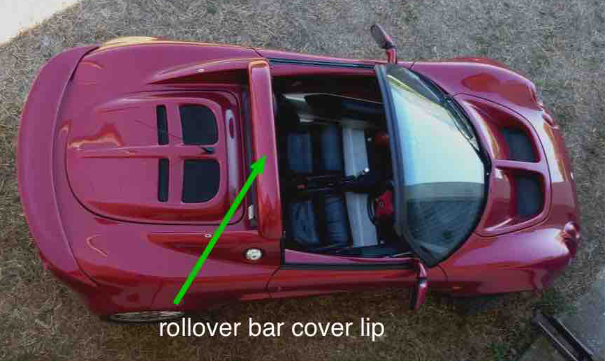

I’m not sure these images show well the type of rear screen setup I have
my rear screen and surround is nothing like on a conventional car with a rear screen
as mentioned, the rear screen is vertical with a thin lip around the screen edge
that’s not what’s unusual about the rear screen or it’s surround. the rear screen is made to be taken out so the screen has a thick rubber seal, then after this is a round rollover bar,
so the only option is to mount the DVR on the glass, any bracket attached to the rollover bar like a large jubilee clip will interfere with the rollover bar cover
I do think using the wedges will be my best bet, unless Viofo make different angled shimmies to use on the rear camera

Please consider mounting on round roll over bar using curved adhesive mount.
Don't think a curved adhesive mount would work well, doubt it would stick, but could use an exhaust clamp around the bar and clamp a strip of Aluminium on the bottom and then stick the standard camera mount to that, could be solid enough not to suffer vibration while being long enough to get the camera in the right place.

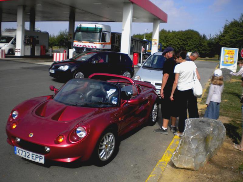

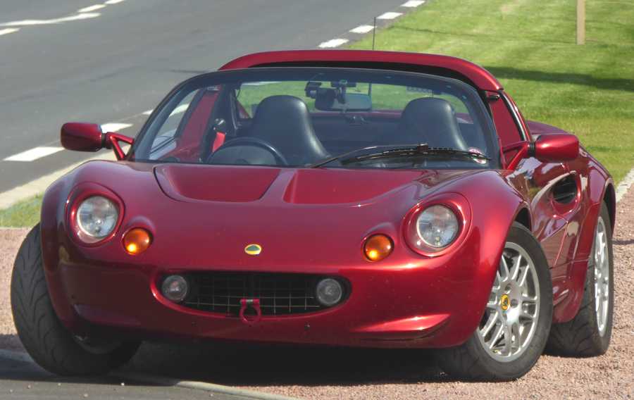

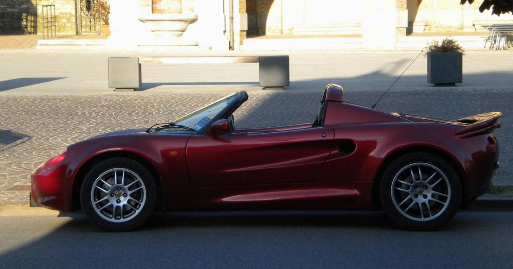

off topic... what kind of car is that OP? Lotus? It looks pretty cool.
way off topic, but it is my thread :)
yes it’s a Lotus, Elise S1 made in 2000, I’ve owned it for 9 years and have used it to drive to Italy each summer of those 9 years
at most places I stop (in Europe) I get people either looking at it or taking photos of it
for your entertainment :)

Some installs just require a custom-fabricated mount as nothing 'standard' will work. Luckily it's not hard to make something based on a metal bracket bent to shape and painted, or 3-D printed for top-level DIY :cool: Soon we'll have some options for water-resistant remote cams which might also help.
