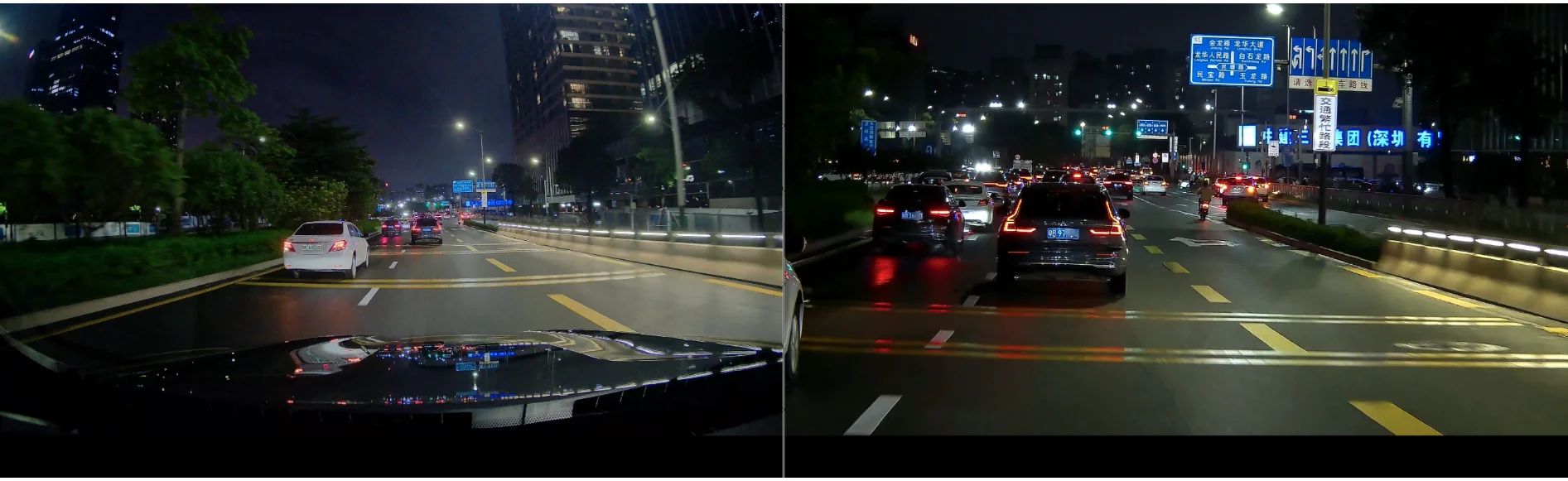

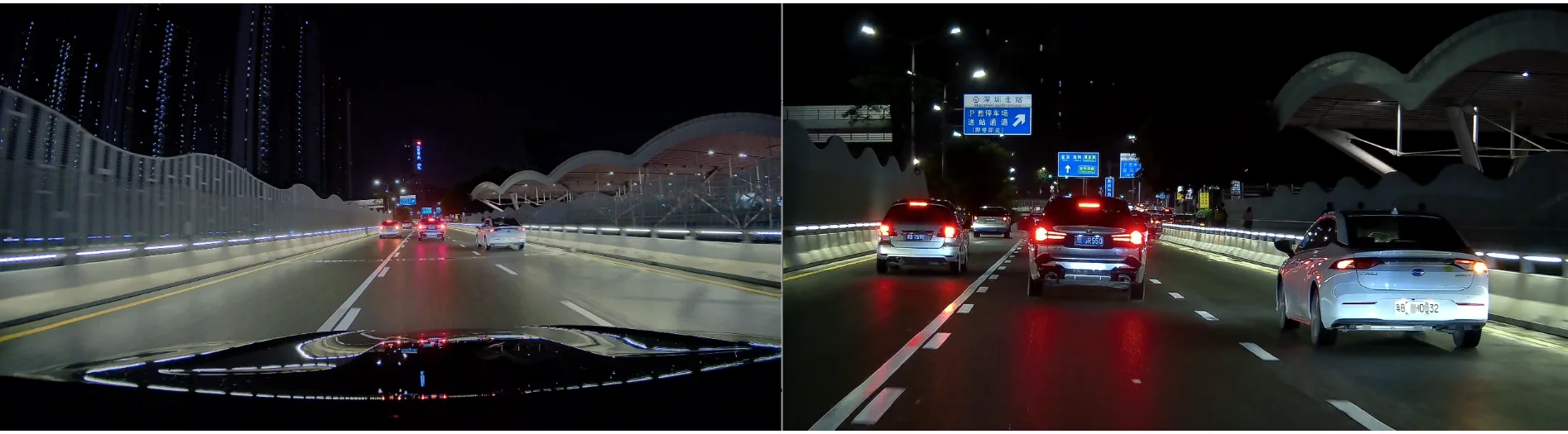

Just looking at those single frames, the performance looks good to me.
The telephoto is darker than the wide angle, but IMO that helps to minimise motion blur and preserve highlight detail. Personally I don't mind the telephoto being a bit darker than the wide angle, since both are working together to record the scene, but other users may have a different opinion?
Are you testing the telephoto lens on a STARVIS 2 camera with HDR, perhaps the 5MP IMX675?
I agree with the comments above by @Dashmellow about offering a short telephoto around 8mm focal length, to ensure the oncoming lane is covered even on curved roads.

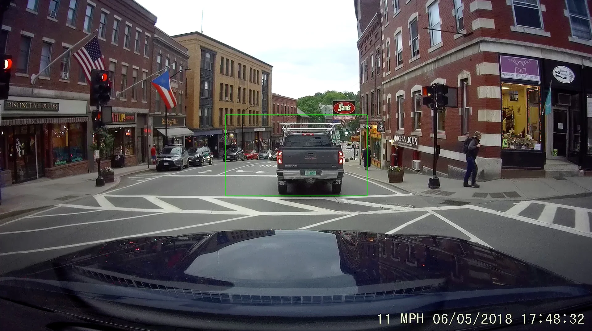

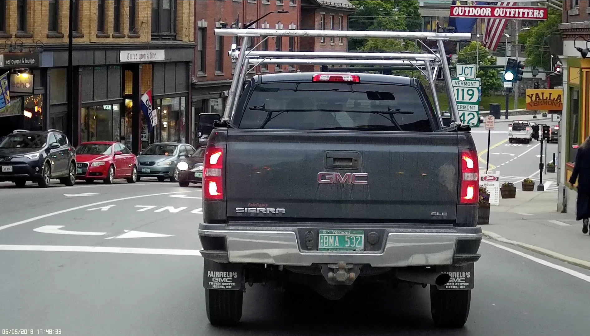

Some time ago, you asked about what telephoto focal length would be best. As you know, I was the first person on DCT to demonstrate a telephoto dash cam six years ago. Over time, my views about how long a telephoto lens should be used have evolved. I've learned that it depends on how you want to use the camera and what your personal needs are. These days I prefer a wider, less powerful lens because I often travel on smaller two lane roads and I find it useful to capture cars and license plates of vehicles coming towards me in the other lane. If I have too much magnification, I miss that.
Originally, I preferred a stronger magnification like this:

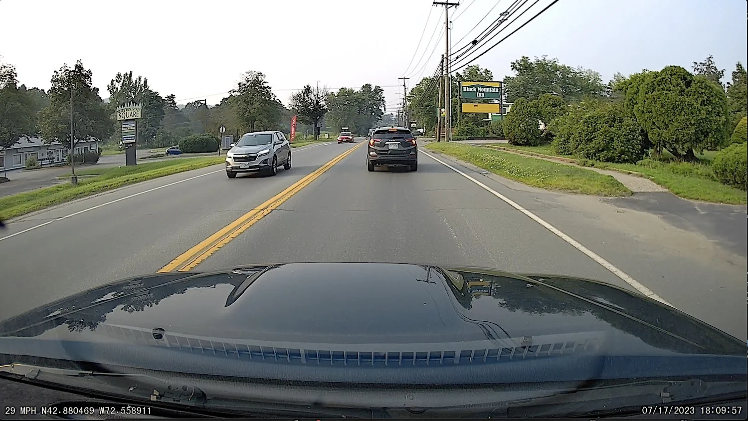

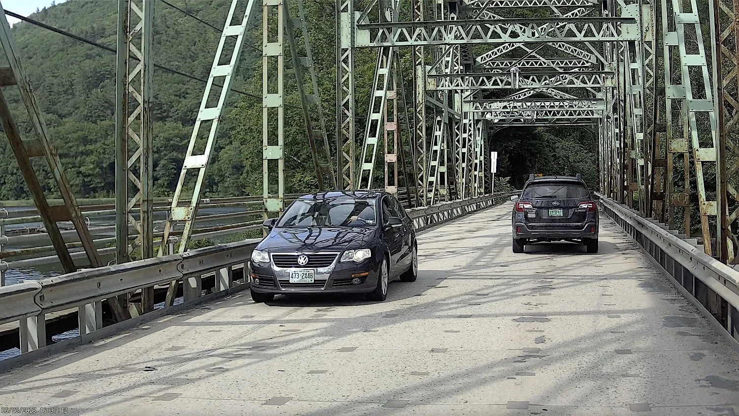

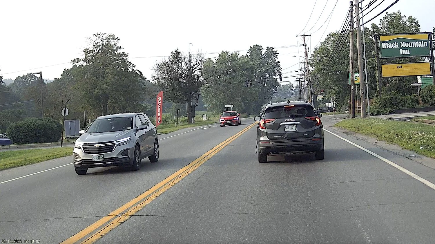

These days I use a less powerful 8mm lens that allows me to capture the oncoming lane as well. I sometimes even turn the lens slightly to the left to enhance oncoming lane capture.
Here is the corresponding frame from the Viofo A119 V3 for context.
