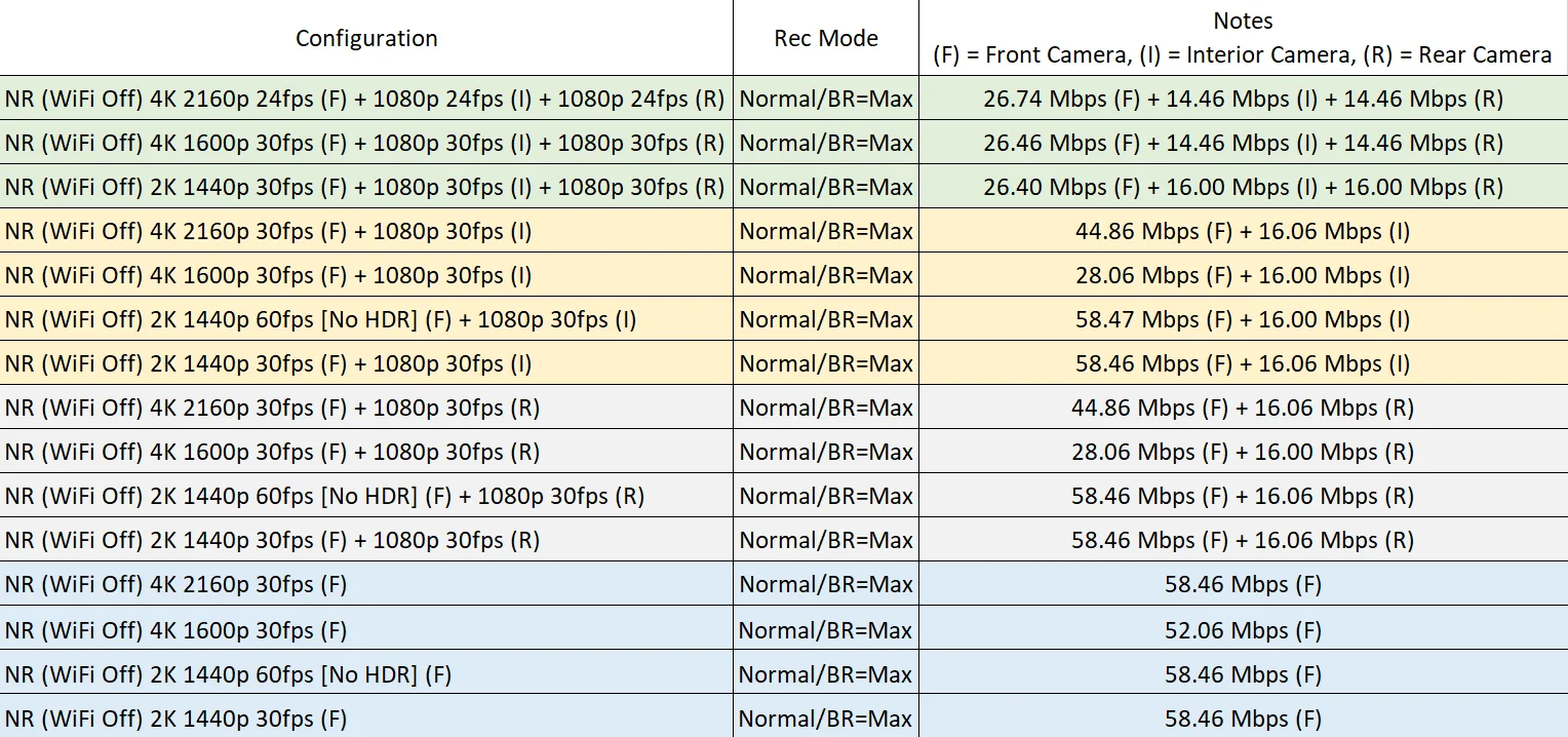

When I gathered my power consumption data, I also gathered the Mbps bitrate for the various recording modes and I placed that in the "Notes" section of my power consumption spreadsheets that I posted in my A139 Pro review thread.
I've consolidated the four camera configurations 3-Channels (Front+Interior+Rear), 2-Channels (Front+Interior), 2-Channels (Front+Rear) and 1-Channel into one spreadsheet showing the bitrate differences in each of those configurations. All of those tests were with the bitrate setting set to "Maximum". As the number of cameras (channels) decreases or if the video resolution is reduced, the higher the video bitrate becomes and thus the larger file sizes. The one exception being the reduction of video resolution from 3840x2160 to 3840x1600 does not result in a higher bitrate.

Those bitrates are with the v1.0_1105 test firmware and using my preproduction unit. I’m still waiting for my two production units
I'm getting 58-60Mbps in 1CH 4K mode on my retail unit. It seems to run at a similar temp to my regular A139 in 3CH mode, just going by a simple touch test.

58 mbit are not that wild, at least not compared with action cameras that will easy do 100 mbit
But when you have been used to see 18 - 20 mbit for 1080p cameras for a long time, it is something you notice.

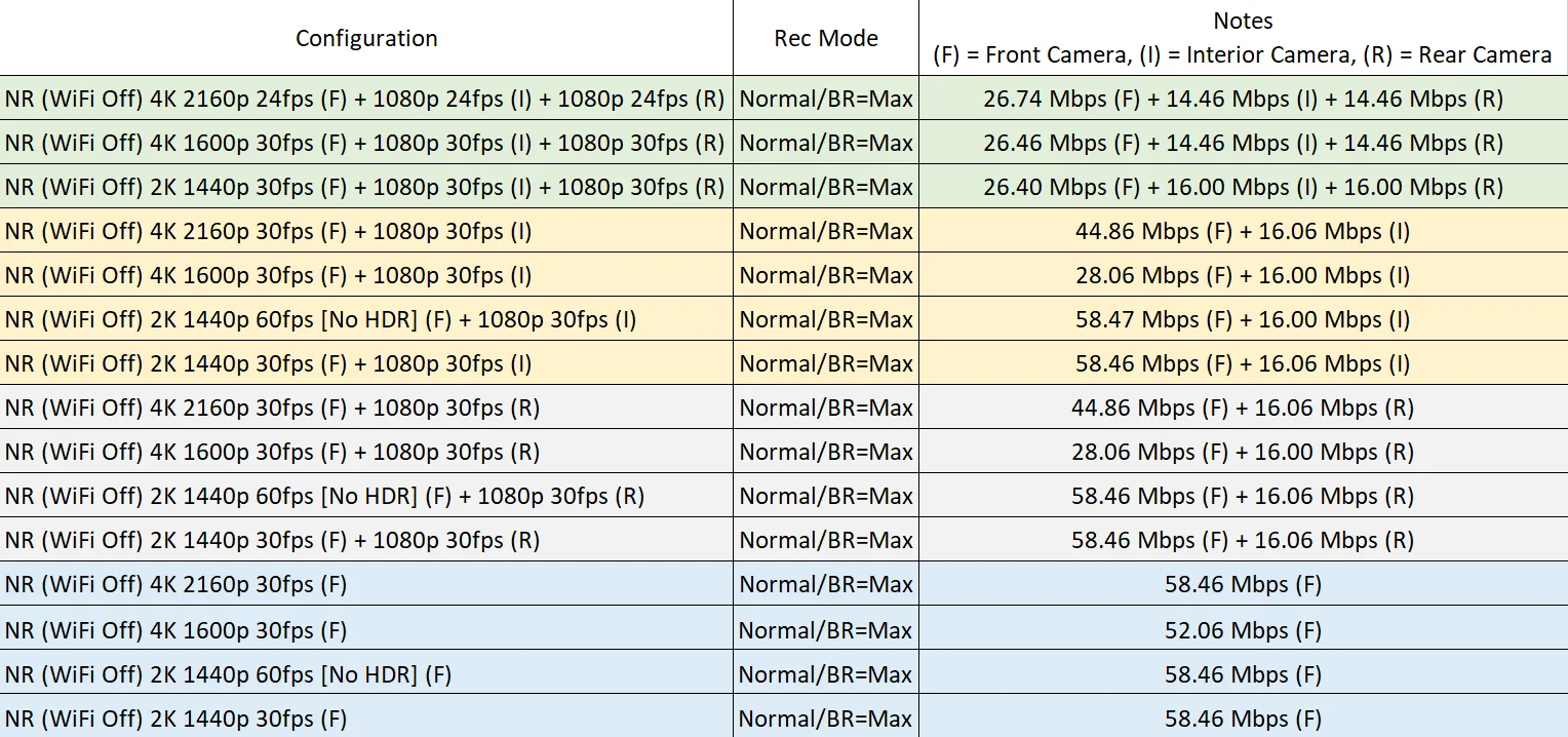

I've consolidated the four camera configurations 3-Channels (Front+Interior+Rear), 2-Channels (Front+Interior), 2-Channels (Front+Rear) and 1-Channel into one spreadsheet showing the bitrate differences in each of those configurations. All of those tests were with the bitrate setting set to "Maximum". As the number of cameras (channels) decreases or if the video resolution is reduced, the higher the video bitrate becomes and thus the larger file sizes. The one exception being the reduction of video resolution from 3840x2560 to 3840x1600 does not result in a higher bitrate.
I still see that the bitrate discrepancy on 3840x2560 (44.86Mbps) vs 3840x1600 (28.06Mbps) still exists while running in 2CH mode...
The same thing happens whether one uses Front + Rear or Front + Interior combination.
If anything...One would think that it should be capable of running either the same (or higher bitrate) at 3840x1600 vs 3840x2560 resolution, but yet the opposite is happening.
It makes me question the utility and benefit of running in 1600p resolution on any other camera combination except 3CH mode.
Of course the main difference is that a 100Mbps action camera probably is not attached to a windshield, recording for many hours at a time
I am running 3840x1600 in 1CH mode at 53Mbps and that seems plenty to me. It saves a little bit on memory card space and heat generation compared to 58Mbps.
Taking a quick look at the numbers, 1600/2560 = 0.625. So the 1600p video has 62.5% number of pixels compared to 3840x2560.
It looks like the Viofo engineers started with 44.8Mbps as the max bitrate they could run in combination with 16Mbps on the rear camera, then reduced the 1600p video bitrate in proportion to the change in pixel area: 0.625 x 44.8 = 28.0Mbps

I have tried the A139 Pro in 1CH, 2CH and 3CH configurations. Personally, I didn't like the effects of the reduction in bitrate, but then I am used to having 4K cameras at around 60Mbps.
The 16:9 has 35% more pixels, so needs 35% more bitrate to achieve the same image quality.
The only reason to run the 1600 at the same or higher bitrate is to achieve significantly higher image quality, but the engineers were not necessarily choosing the bitrates for maximum quality. There is always a compromise between image quality and other things, such as temperature, reliability, hours of video per card, power consumption (especially if running on battery in parking mode), etc.
