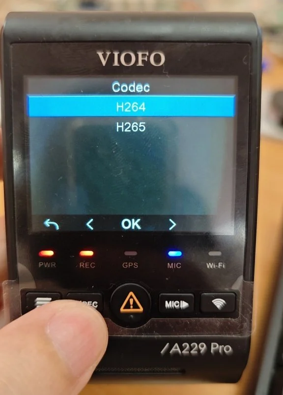

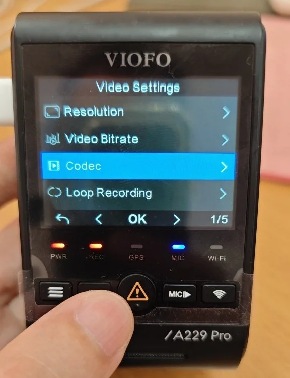

- New menu "Codec": H264 or H265 was implemented. Then H265 is enabled new icon under resolution text at dash screen is shown.
![1719385579614.jpg 1719385579614.jpg](https://dashcamtalk.com/forum/data/attachments/73/73178-897f3af393ac931762d161bbe7956f15.jpg?hash=0H_Bh5wLuu)
![1719386835633.jpg 1719386835633.jpg](https://dashcamtalk.com/forum/data/attachments/73/73179-7f87ef6fb25082f9db546d514c1a13ad.jpg?hash=L8qxmzi5LR)
