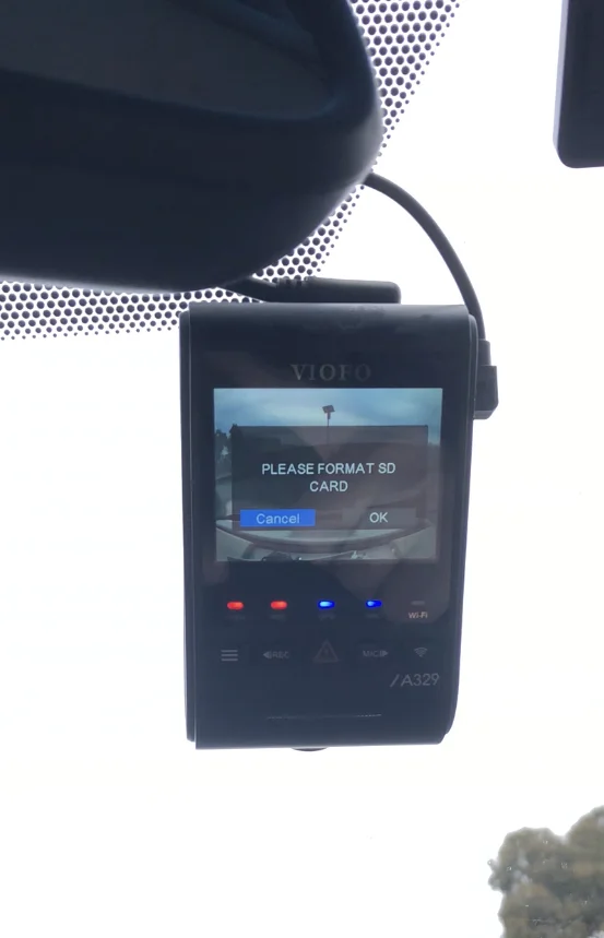

I'm running the A329 with a 128GB Viofo card powered via the op100.
Recently I've noticed the A329 when booting after the power switch is turned on the A329 starts normally but then prompts asking if i want to format the memory card.
If i don't notice this message it will remain at the prompt while I'm driving without making constant beeps warning that it is expecting attention.
I don't think it records while waiting for attention.
I think it happens only after the memory card has filled and is in looping mode.
The loop duration is set to 5 min.
I have raised this with viofo.
I've been asked to format the card which i suspect will temporarily resolve the problem until the memory card reaches its loop process.
The memory card has about 1.2GB free.
I can reproduce this problem providing
Memory card is full
The power is applied from a cold start.
Anyone else able to check if it happens on their A329 various models.
