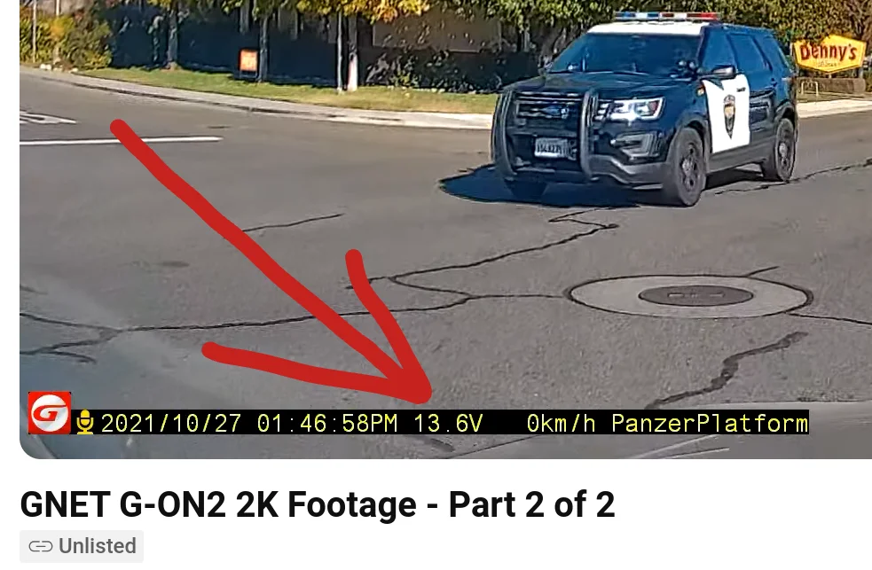

I’m not seeing the voltage display at shutdown. Tried several times. Is there something in the settings to enable that?
There is no vehicle starter battery voltage (12V) display on Viofo dash cams they use 5V USB.
These usually appear on the Korean Brands that use a 12V barrel connector in the text overlay on the recorded footage.
I was talking about aiming the camera at a multimeter connected to your car battery.
However, Vantrue makes a hardwire kit with a built-in digital voltmeter for 12V battery voltage.
Maybe whe need a Viofo version. lol
Also with additional setting to disable Low Voltage Cut Off for use with dash cam battery packs.
OK, maybe I'm asking too much. lol
