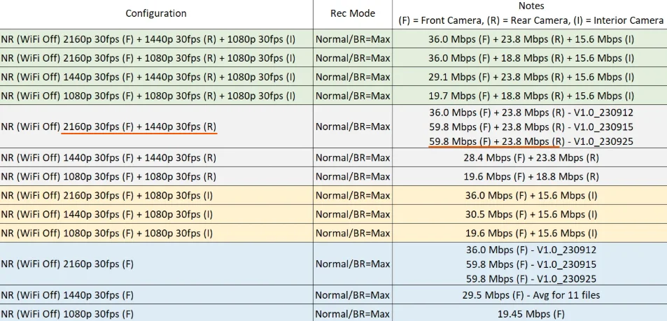

Referring to this 2023 post by @rcg530, the A229 Pro in 2-channel mode at max bitrate records at 59.8Mbps + 23.8Mbps = 83.6Mbps
Using the DCT Recording Time Calculator a 512GB card should be able to hold 13.9 hours of video at 83.6Mb/s. That's about 2.5 days per TB.
You will get longer recording time if you use a lower video bitrate. You may wish to experiment now with the bitrate to decide what setting you are happy with to record your trip.
